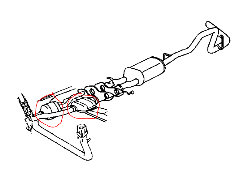

Okay, at first it only did it about once a month.Now it does it all the time.while giving it a little gas and keeping it under load it does fine but when I just cruise it shudders and misses.The motor hardly makes a noise been well taken care of.where should I start it was my father's and I refuse to ditch the motor.changing plugs today.

I had the battery unplugged long enough that it erased the codes.check engine light hasn't came back on.yet!but last time I had it checked it said it was the catalytic converter or o2 sensor.just changed my fuel filter and plugs and wires.seems sluggish and misses less but still not better can a catalytic converter or sensor really make it shudder?

Actually yes, It can. Especially if a catalytic converter is plugged.If/when the check engine light comes back on if you save the code number I can tell you specifically which one is suspect. Your truck has 2 and I've attached a picture below and circled in red.Hope this helps and thanks again for using 2CarPros.

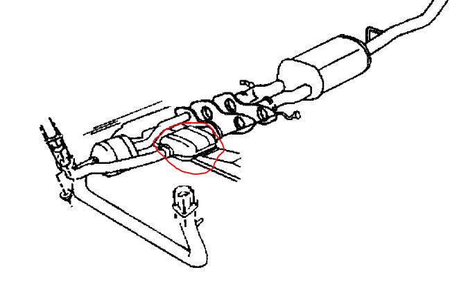

Okay, the codes are p0430 catalyst efficiency below threshold (bank 2). could it be wiring harness sensor or do I need new catalytic converters?

I would just suggest the bank 2 left (passenger) side catalytic converter. Mine went out at about the same mileage you have.Here in California I paid $269.00 installed at my local shop. If you are not in California they can be a lot cheaper for just a universal replacement. Attached a picture below and circled in red which one it is.Hope this helps and thanks again for using 2CarPros.
