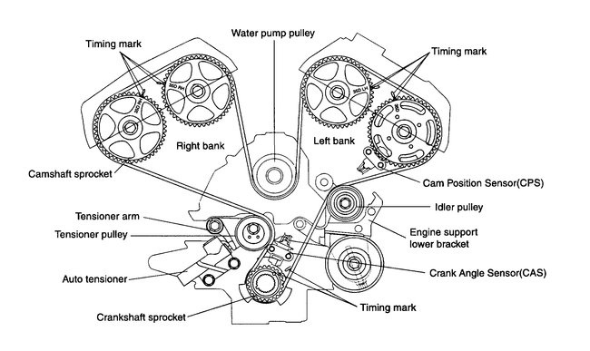

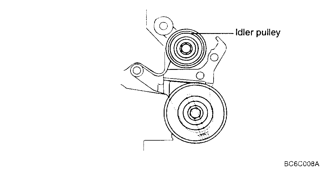

Rotating engine clockwise. manual rotation stopped at 180 degrees. started with cam and sprockets all on timing marks (hard to tell with right bank).
I have intake manifold off to find tdc #1.
can i rotate a cam sprocket by it self? if so what direction and how do I know which sprocket to rotate?
I suspect it is the sprocket closest to the firewall but not positive.
And the right bank sprocket(s) have jumped twice before. any help would be appreciated...

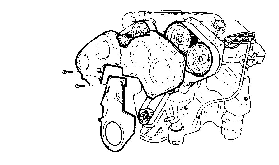

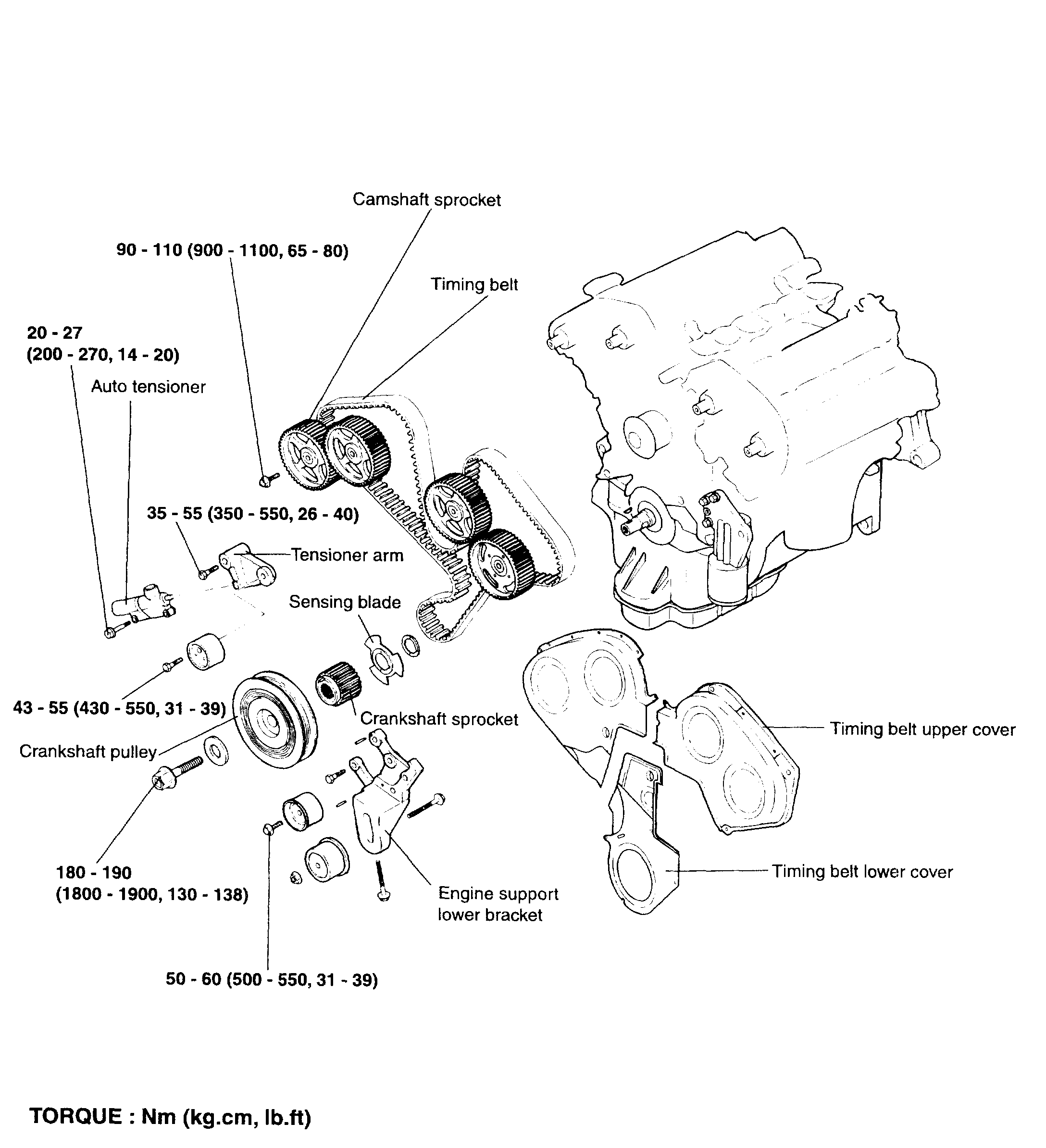

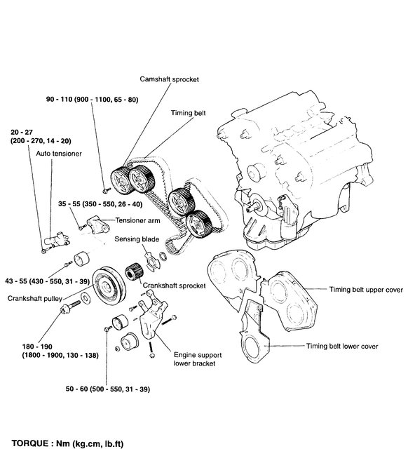

I'm not sure I understand what you're asking. If the belt is on, you can't turn the cam independently. Do me a favor. Here are the directions for belt replacement. It shows all timing marks and procedures. The attached pics correlate with the directions. Take a look through them and see if they help.
__________________________________
2005 Kia Truck Sedona V6-3.5L
Procedures
Vehicle Engine, Cooling and Exhaust Engine Timing Components Timing Belt Service and Repair Procedures
PROCEDURES
pic 1
pic 2
REMOVAL

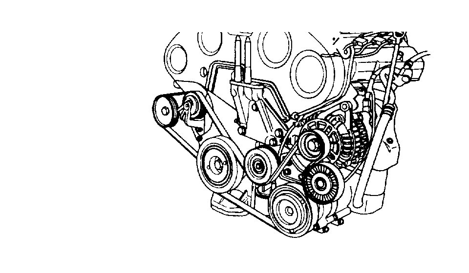

1. Remove the engine cover.
2. Remove the drive belt.
pic 3

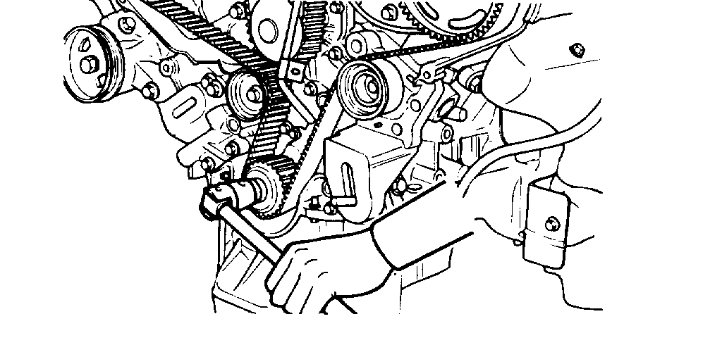

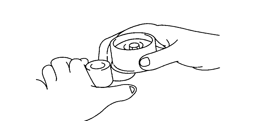

3. Remove the idler pulley, crankshaft pulley, power steering pulley and tensioner pulley.
pic 4
4. Remove the upper and lower timing belt cover.
5. Support the engine with garage jack or special tool, and then remove the engine mounting insulator.

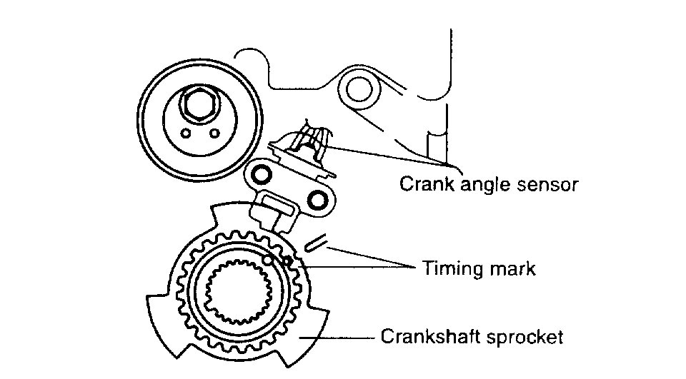

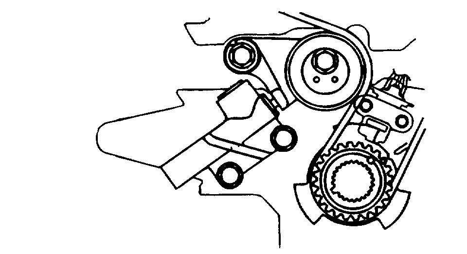

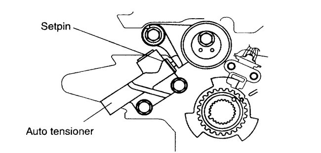

6. Remove the auto tensioner.
NOTE: Rotate the crankshaft clockwise and align the timing mark to get the No. 1 cylinder's piston be in TDC position (compression stroke).
At this time, the timing marks of the camshaft sprocket and cylinder head cover should coincide with each other.
pic 6
7. Remove the timing belt.
NOTE: When re-using timing belt, make sure of marking the rotating direction on the belt so as to install correctly.

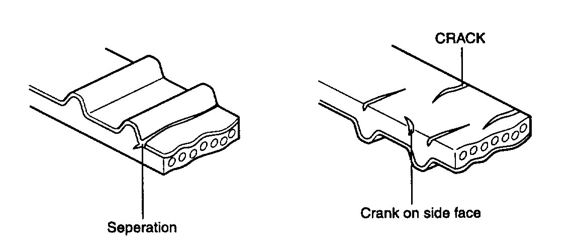

1. Check the belt carefully and if any damage is found, exchange it with a new one.
pic 7

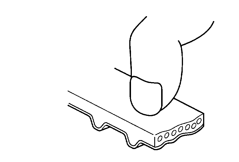

1. Vulcanization of the rubber backside. The backside is glossy and non-elastic so that, even if a finger nail is forced into it, no mark is produced.
pic 8

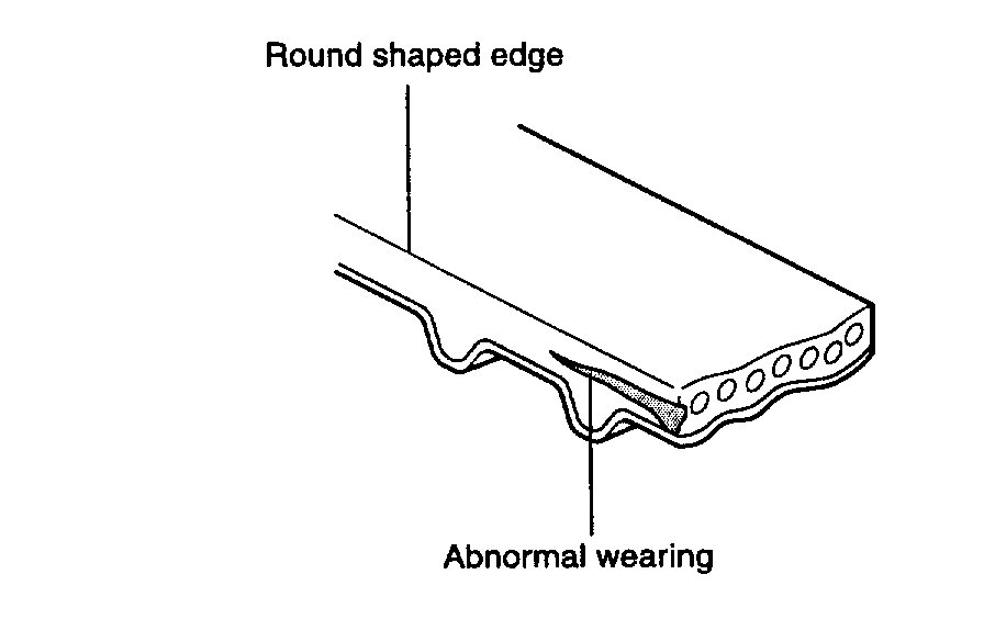

2. Crack on the rubber belt surface.
pic 9
3. Abnormal wearing of side face of belt.
CAUTION: Belts in good condition seem to be cut by a sharp knife.
pic 10

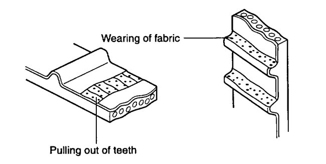

4. Abnormal tooth wearing
Initial stage
Wearing of side face of load exerting tooth (Fabric puff up, rubber material peel off with color changing to white and fabric become uneven and rough).
Last stage
Fabric wearing of side face of load exerting tooth occurs and rubber is exposed (Length between teeth decrease.).
5. Missing tooth.

METHOD OF INSTALLING TIMING BELT AND AUTO TENSIONER
pic 12

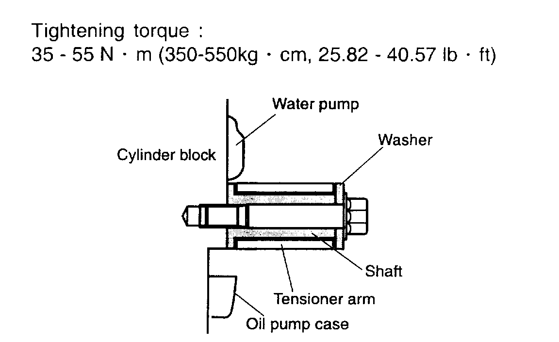

1. Install the idler pulley to the engine support lower bracket.
pic 13
2. Install the tensioner arm, shaft and plain washer to the cylinder block.
pic 14
pic 15

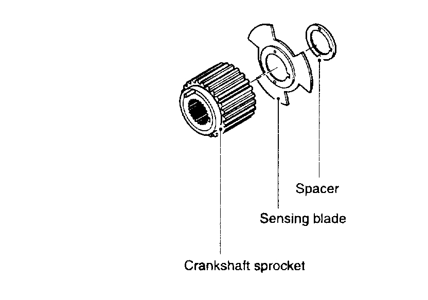

3. Install the crankshaft sprocket.
NOTE: Confirm if timing marks coincide with.
CAUTION: Align the spacer with a pin, and assemble it exerting even force not to deform the crankshaft sensing blade.

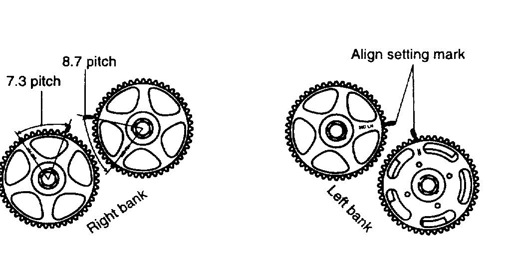

4. Install the camshaft sprocket. Align it like initial state.
CAUTION: When installing camshaft sprocket, tighten the bolt holding hexagonal part of camshaft to prevent it from turning.

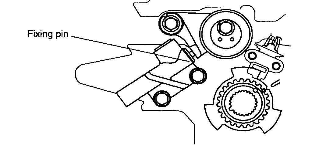

5. Install the auto tensioner to the oil pump case.
CAUTION: At this time the auto tensioner's set pin should be assembled completely.

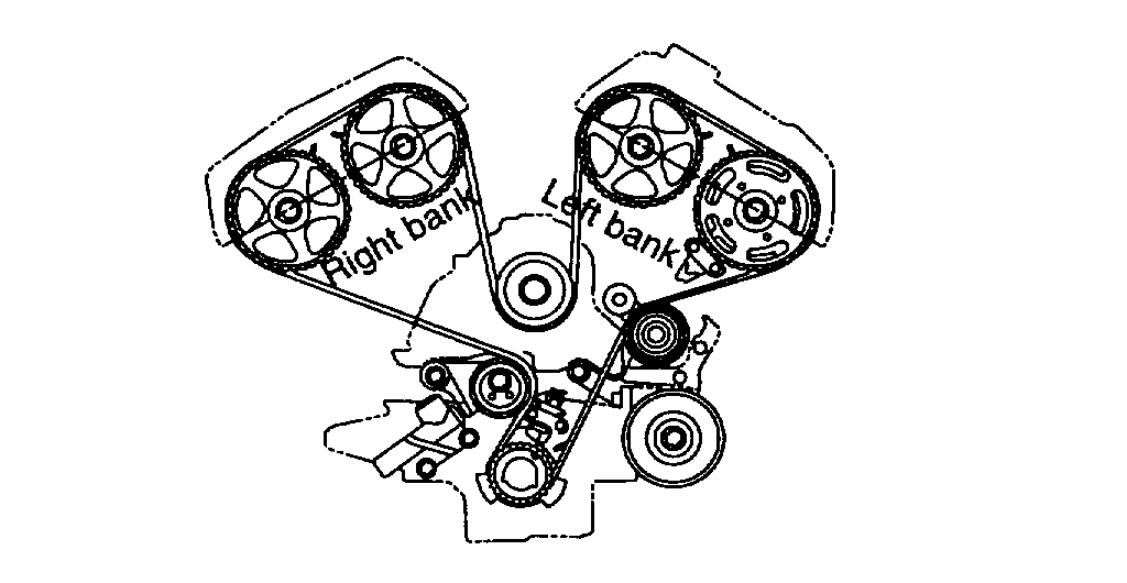

6. Align the timing marks of each sprocket and install the timing belt, maintaining the proper belt tension between each shaft in this order.
Crankshaft sprocket -> Idler pulley -> Left bank exhaust camshaft sprocket -> Left bank intake camshaft sprocket -> Water pump pulley -> Right bank intake camshaft sprocket -> Right bank exhaust camshaft sprocket -> Tensioner pulley.
CAUTION:
- As a result of this, position of No.1 cylinder comes to compression TDC.
- As each camshaft sprocket tends to rotate by itself, pay attention not to injure fingers or other bodily part. Especially be careful with the right bank.
- In case the right bank camshaft sprocket rotates excessively, be cautious not to rotate more than the initial stable position. Always align timing mark of rotating sprocket by turning it reversely. In this case, pay attention not to rotate it reversely from the initial position. (if, with one sprocket fixed at No. 1 compression TDC position, the other sprocket is rotated one revolution clockwise or counter clockwise, then the intake and exhaust valve might interfere each other.)
7. After installing the timing belt, exert the reverse-directed force to the right bank exhaust camshaft sprocket to give tension on the belt. Holding this state, recheck if each timing mark is correctly positioned.

9. Pull out the auto tensioner set pin.

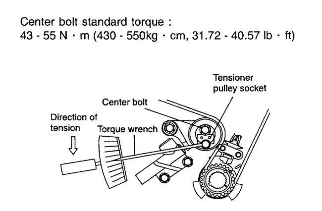

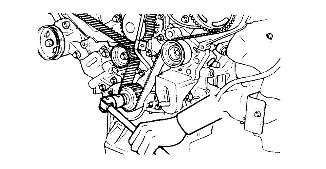

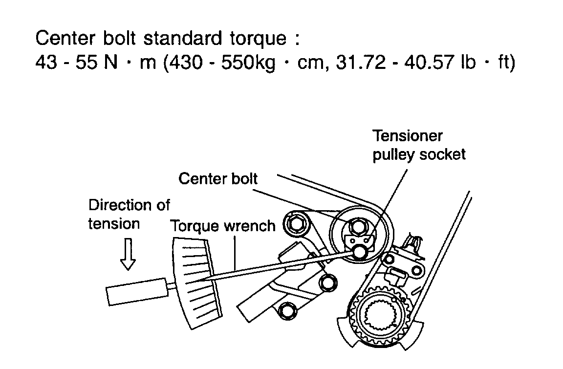

1. After rotating crankshaft 1/4 revolution reversely, rotate it clockwise to position No. 1 cylinder at TDC.
Then, loosen the center bolt and give the belt 50 kg-cm of tension with tensioner pulley socket (Two pins are attached) and torque wrench. While maintaining this state, tighten the center bolt to the standard torque.
Timing Belt Tension Socket Wrench P/N: 09244-28100

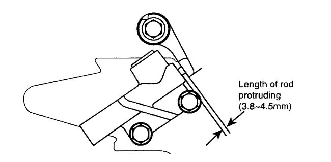

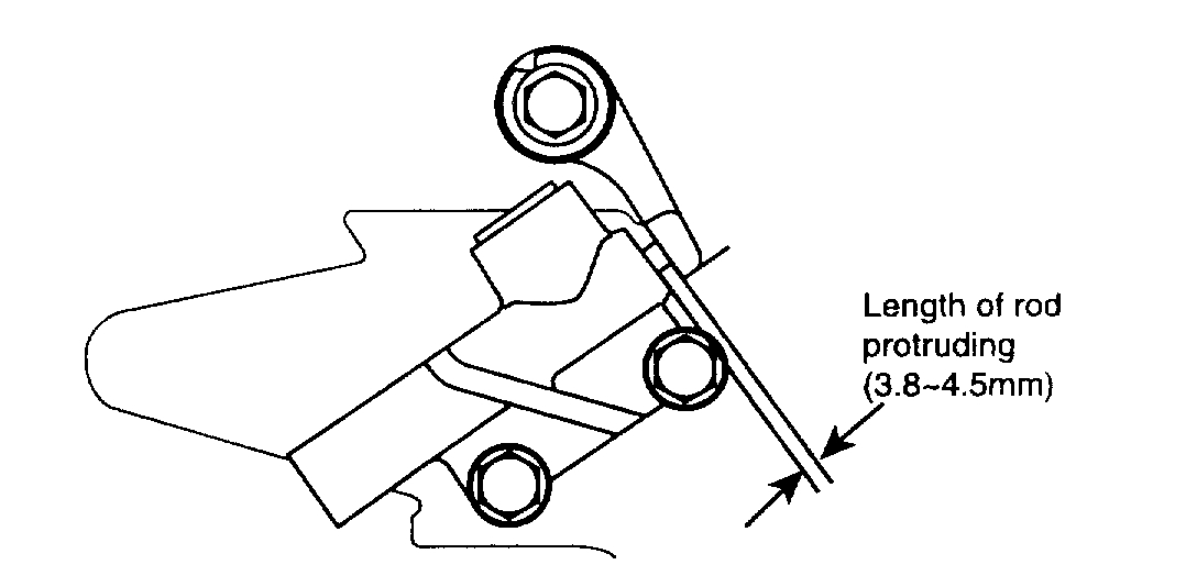

2. How to check tension (While auto tensioner is operating : and fixing pin being uninstalled.)
1. After rotating crankshaft 2 revolutions clockwise to position No. 1 cylinder at TDC, wait for about 5 minutes, and measure the amount of protruding of the auto tensioner rod.
CAUTION: This is "leak down" time for the auto tensioner rod to protrude 1 mm when tension caused by rotation of the crankshaft has changed.
2. Check if the amount of rod protruding is in the range of 3.8 - 4.5 mm.
3. Recheck if each sprocket is within the specified range.

Thank you for replying to my problem. I will try to do a better job of explaining my issue. And I apologize for the length!
My original problem was a loud rattle noise inside the timing belt covers when starting (but the noise stopped after the engine warmed up). so I took the belt covers off and found the old tensioner leaked. So I bought a new tensioner and pulley.
The old belt only had about 5k miles on it, so I decided to reuse the old belt (I bought the Sedona used, original owner said his mechanic had replaced timing belt but I guess he didn’t replace the tensioner).
I had read the download you sent earlier plus other information regarding timing the crank and sprockets and realized I needed to find tdc #1cylinder. I removed the intake manifold and used the long screwdriver method to find TDC. (My compression tester would not seal properly in the spark plug hole).
After aligning the crank and sprocket timing marks, installing the timing belt, putting tension on the belt without pulling the pin on the auto tensioner, I started to rotate the engine. But the engine only rotated 180 degrees then stopped.
I replaced tensioner/pulley prior to trying to find tdc. Not having worked on a quad cam engine before, I assumed the sprockets would not move when I released tension on the timing belt to replace the tensioner/pulley (wrong assumption).
Both right bank sprockets jumped, not sure which direction nor how much they moved. The left bank sprockets moved only a tooth or two.
So my questions:
1) How do I get the engine to rotate 360 degrees?
2) How do I know which sprockets to rotate to allow the engine to rotate? I assume that valves are in contact with pistons and my guess the right sprockets are the problem?
3) How far can I rotate a cam sprocket(s) and counterclockwise or clockwise?
4) Is the 3.5 engines #1 and #4 cylinder firing order the same?
Thank you again for your assistance!

Don't force it to turn. Are you able to turn the opposite way? What you need to do is get the crank at TDC and then align the cams. I'm not sure if that is what you are having trouble with or not. You should be able to turn the crank in the opposite directions to get TDC.
