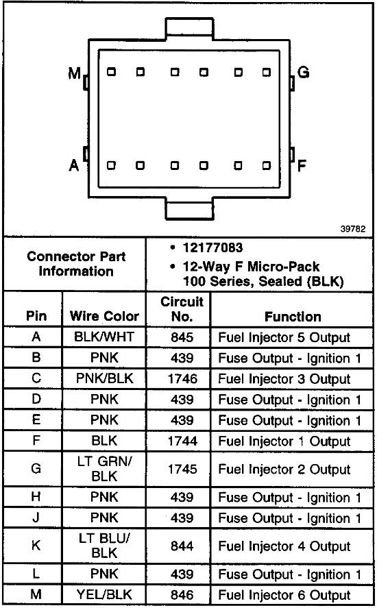

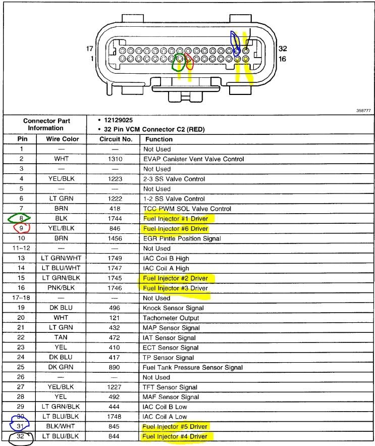

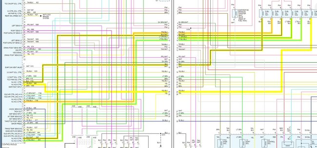

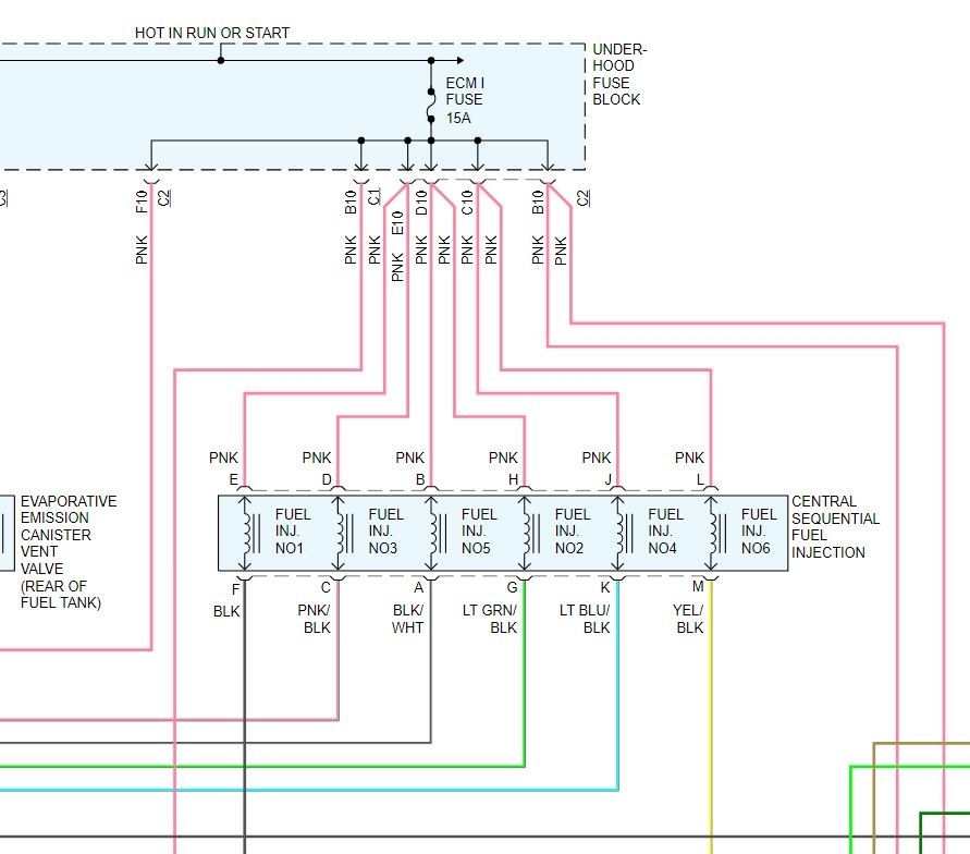

The spider injector is switched on the ground side directly from the PCM with each cylinder having its own trigger wire. So if there is no ground signal from the PCM it's either a bad PCM or it has a ground that isn't secure. The likelihood of it being in the wiring harness and all 6 wires being broken is very slim unless the harness was cut.
However to test it isn't hard. Go to the PCM and look at connector 2, Then find pins 8, 9, 15, 16, 31 and 32, each one controls an injector by switching the ground on/off. So take a test light connected to battery positive and using a pin, put the pin in so the end makes good contact with the back of the terminal in the connector and have someone try to start it. If you see the light flashing then there is a control signal. Test all 6. If you have the signal at the PCM, then go to the injector and see if you have it there as well. If it has the control signal at each one but the injectors are not firing there is an internal issue with the injector unit.
