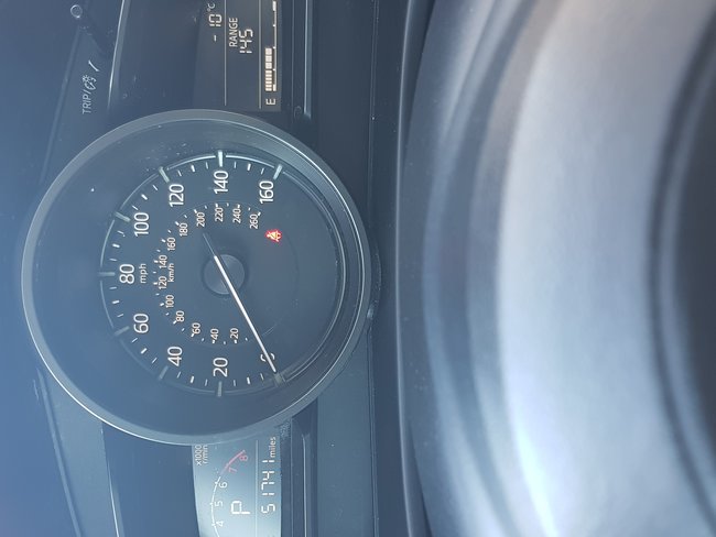

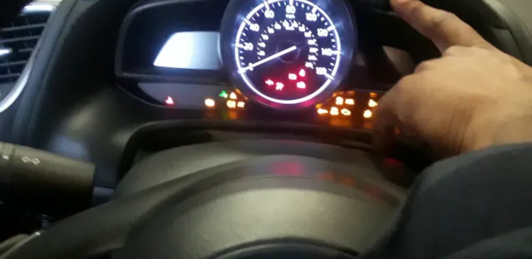

My car's circular lights in the speedometer don't seem to be working inside the instrument cluster.
The either picture is how it's supposed to be like.

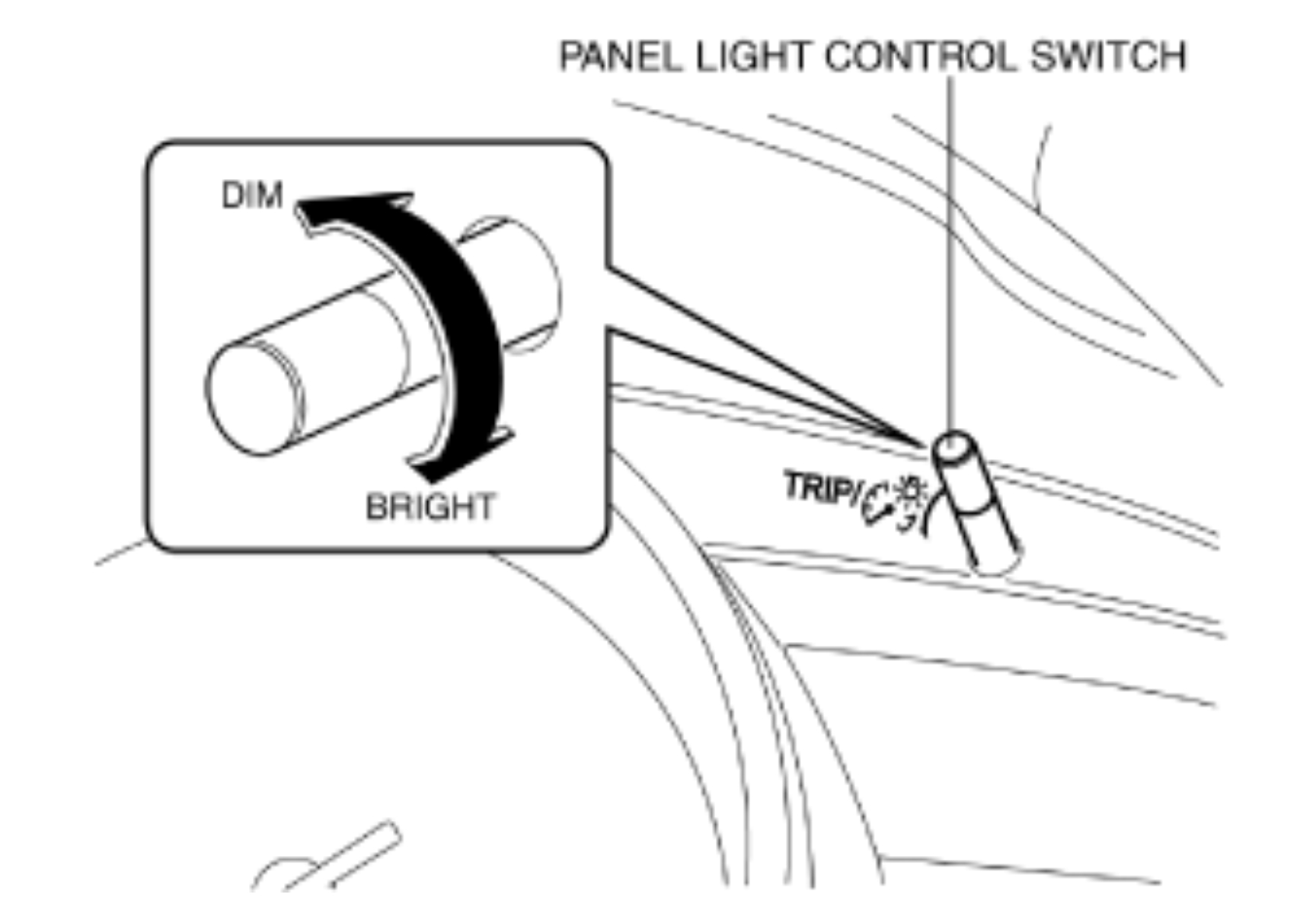

Do you get any change when adjusting the brightness of the dash illumination?
You adjust the brightness by rotating the odometer trip reset button.
Picture below shows the process.
Regards, Joe
Feb 14, 2020 at 8:26 AM
IZECOLDLIGHT
  • 5 POSTS
Yes, I already tried this. it does become bright but the thing is my circular lights have completely died out so the dimmer doesn't help in this case.

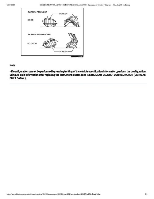

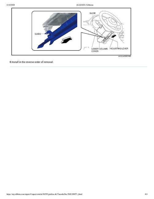

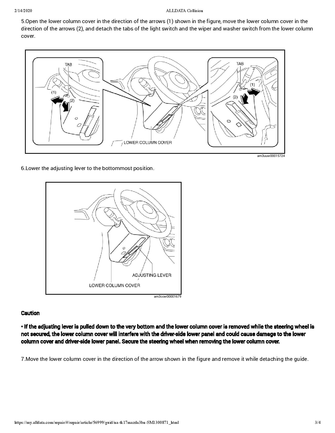

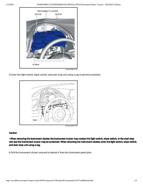

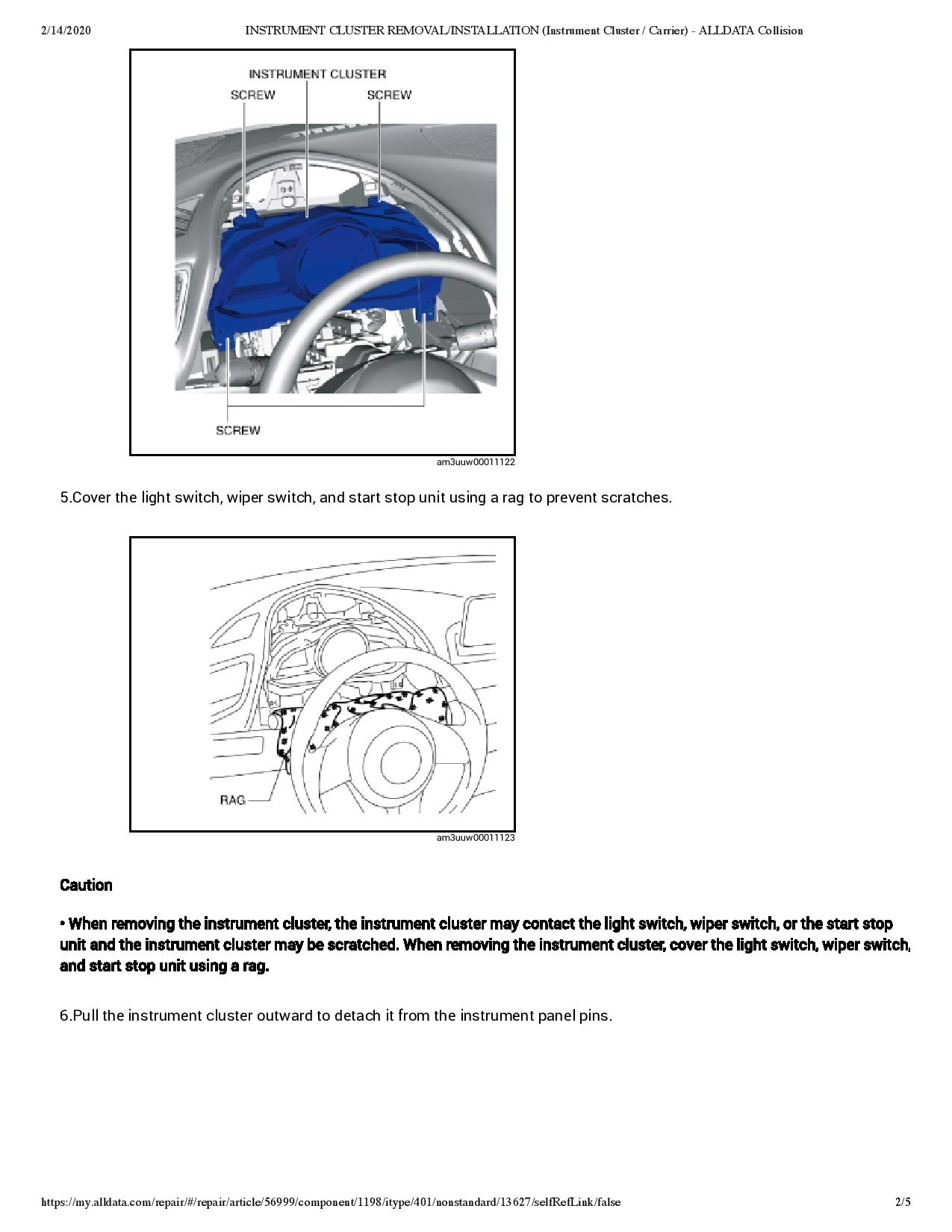

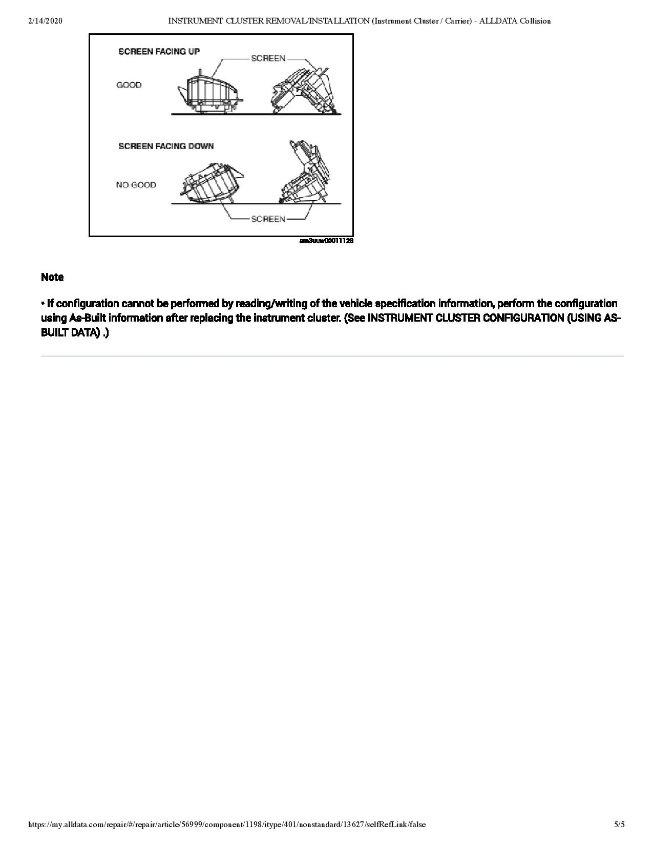

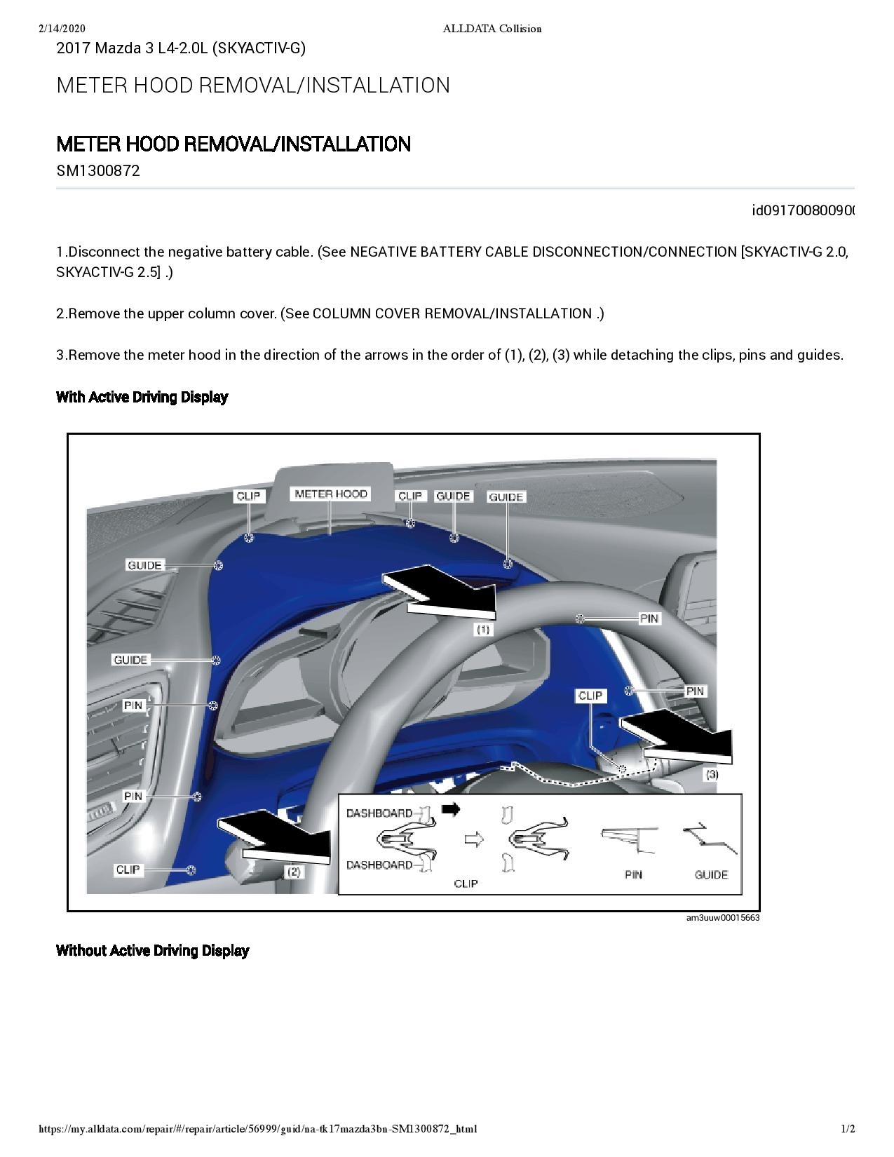

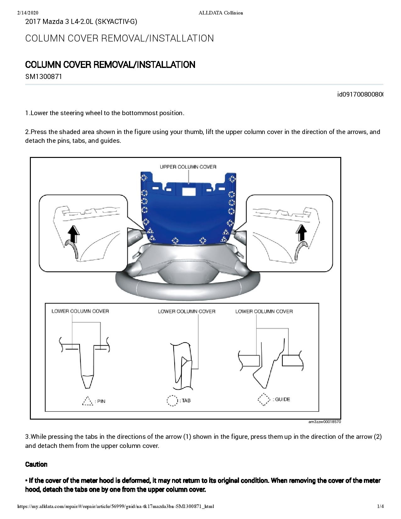

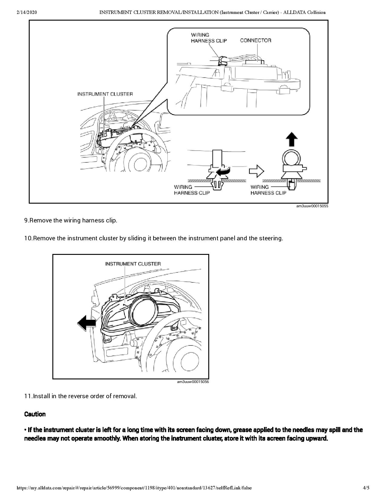

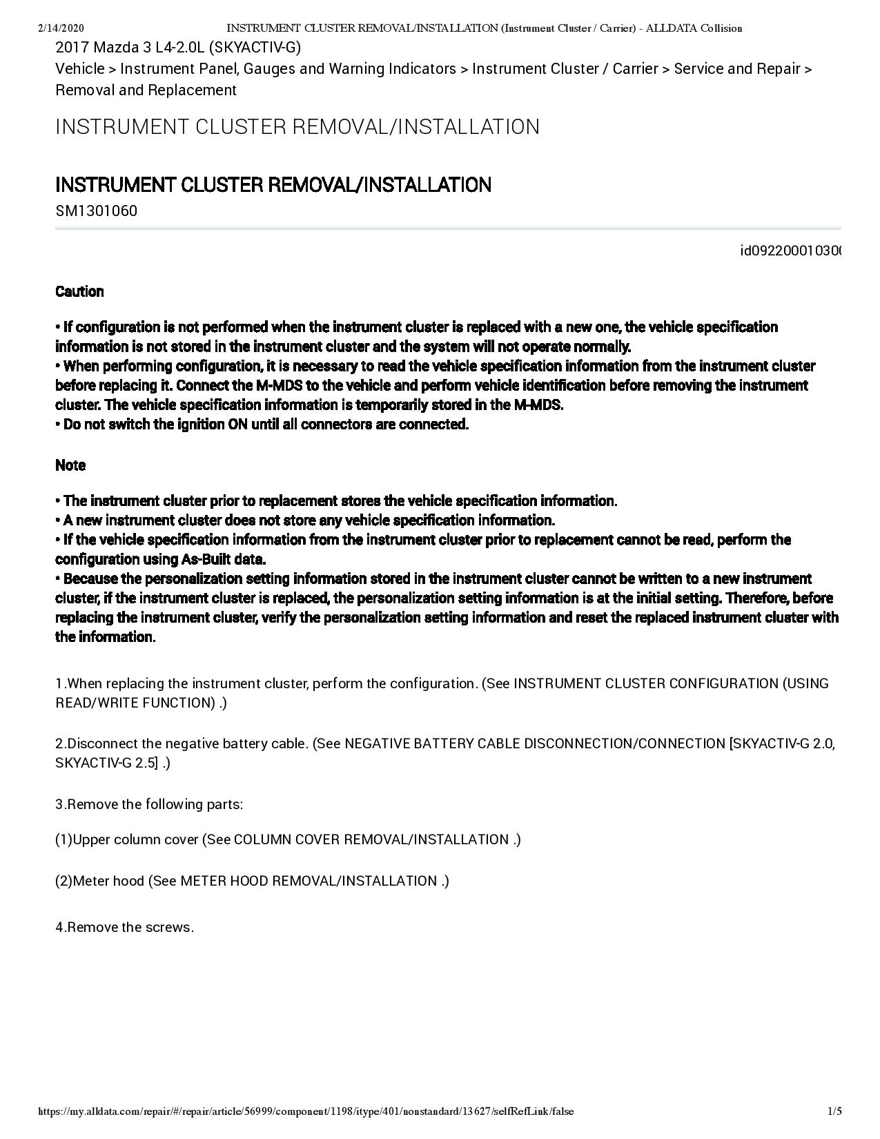

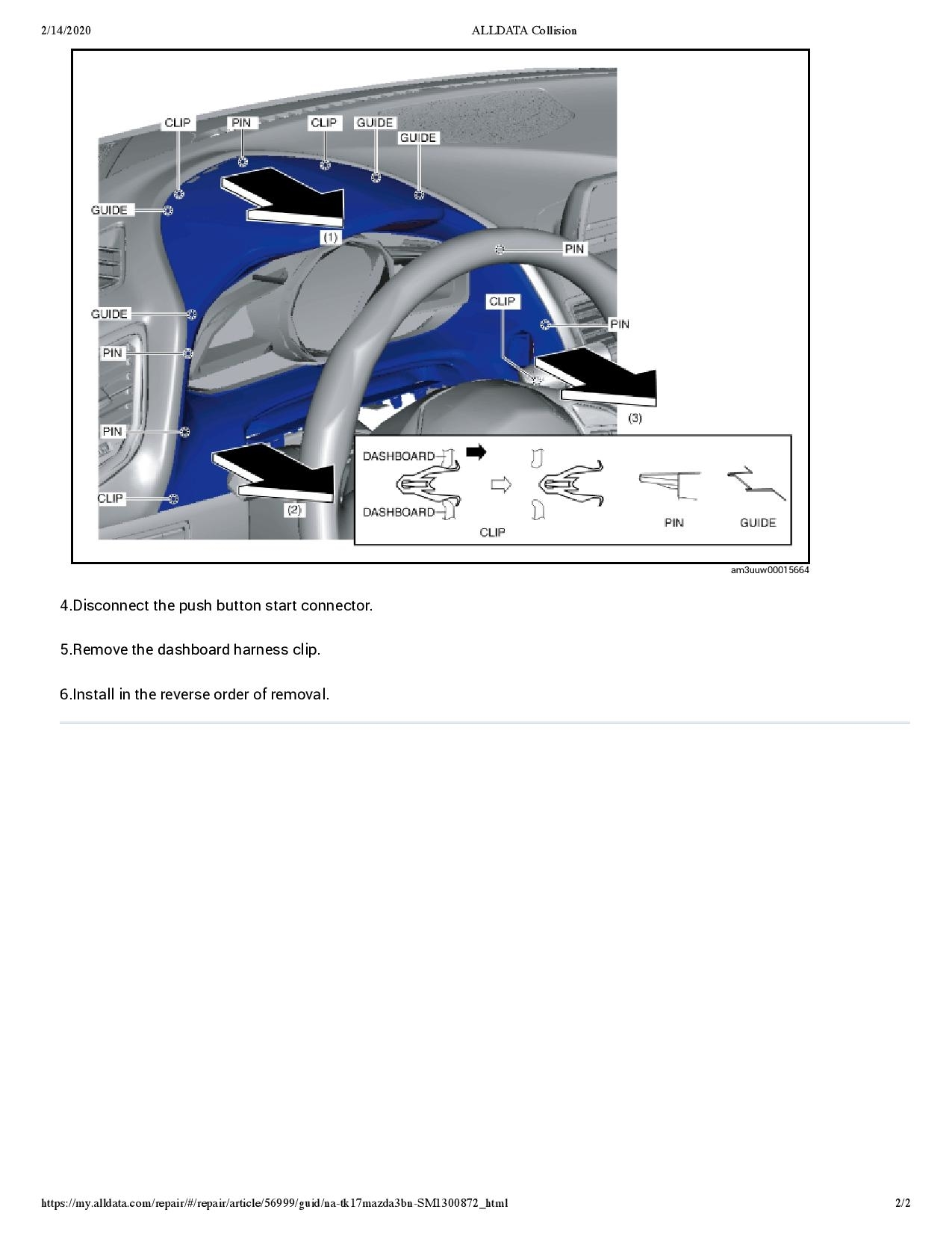

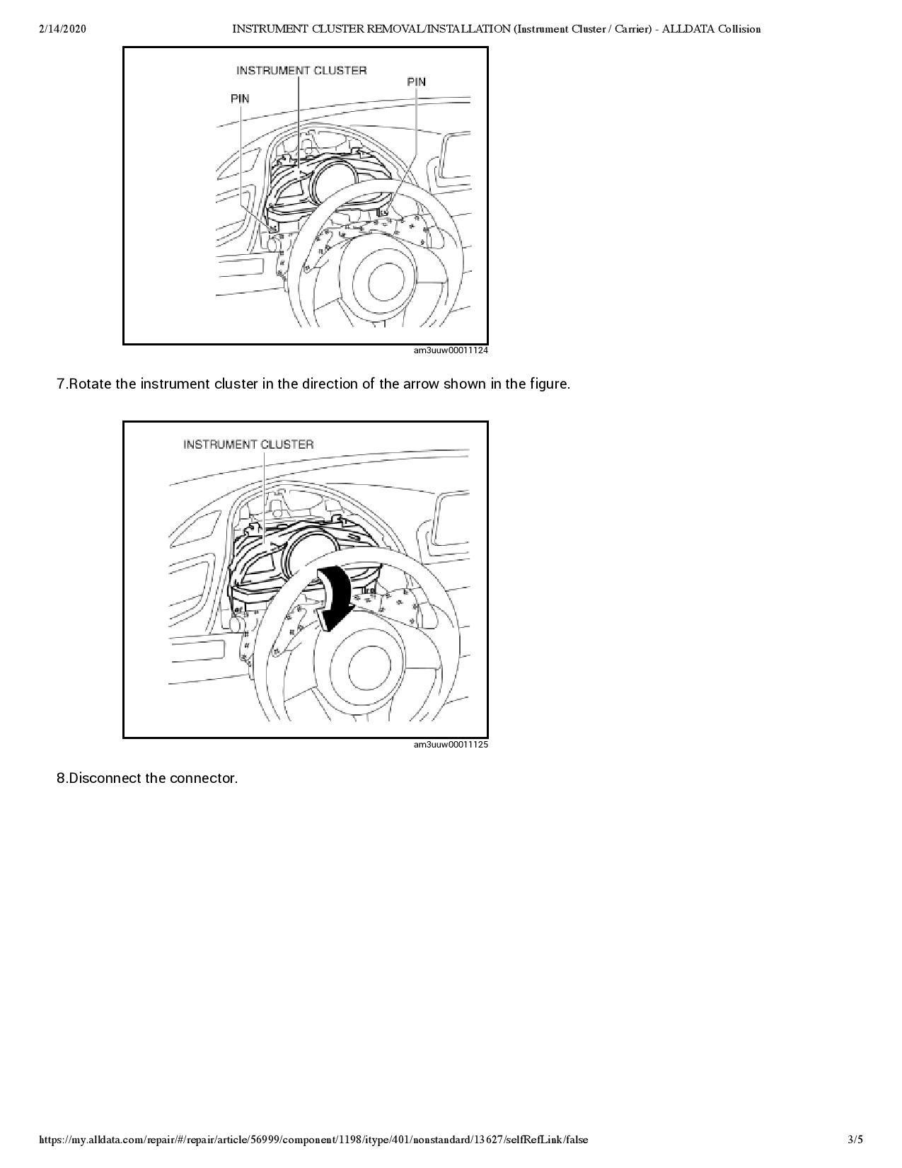

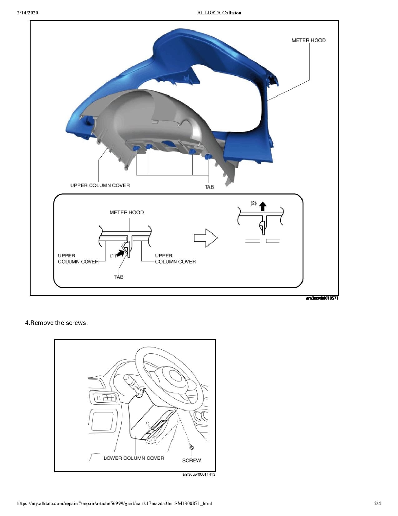

I would advise removing the instrument cluster and drying it out as best you can.
If all other functions work on the cluster and dash lighting then it would seem like you have a problem with the cluster itself.
It is possible to disassemble the cluster but i do not have any instructions for pinpointing and repairing it.
You could disassemble the cluster and inspect for corrosion damage.
It may be that a replacement cluster is the only way to repair this fault.
Hope this helps.
Regards, Joe
