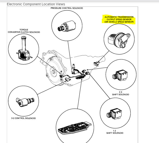

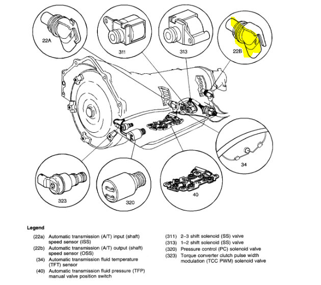

There are two different transmissions that were used, a 4L60 and a 4L80. There should be a tag on the side of the trans housing indicating which one you have.
These vehicles have an electronic output speed sensor. I attached a pic for both transmissions below. Check to see if there is anything loose or damaged at the connector. If it looks good, remove the sensor and inspect it for damage, dirt, or anything that prevents it from creating a proper signal.

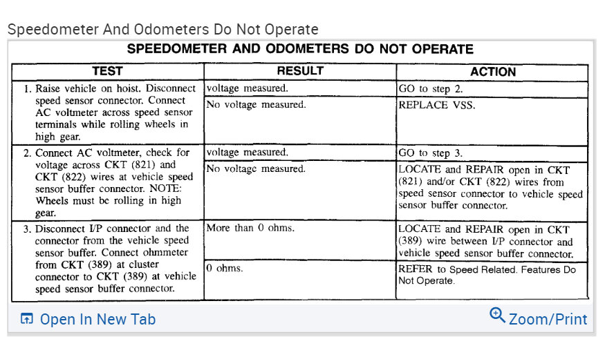

If you look at the last pic below, it diagnoses an inoperative speedometer. It explains how to test the sensor. You may want to consider that as well.
