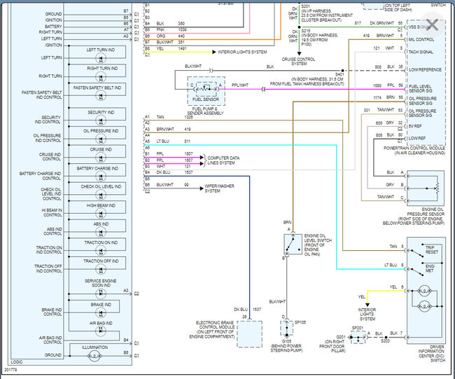

I attached the wiring diagram below for this. I would suggest testing this at the PCM but let me know what questions you have and we can work through this.

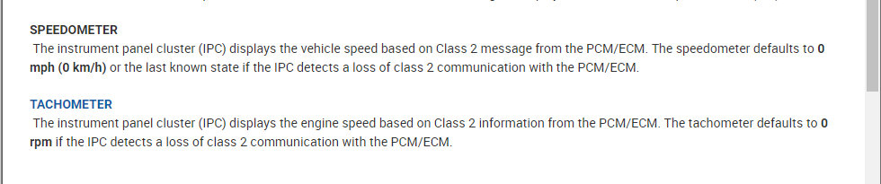

I am attaching the info about the speedometer as that is great news about the fuel.
So the way the cluster operates is it defaults to 0 MPH when it is able to talk to the PCM.
However, when it looses the signal from the PCM it just holds the last known MPH. That means either someone was driving 100 MPH and then when you drove it 60 MPH it was able to get that signal so it moved there and has lost signal again and it is holding that MPH.
So this means we have one of three issues. Either a PCM, wiring, or cluster issue.
I am putting my money on a cluster issue but we can pretty much rule out wiring as the tachometer is sent the same way as the MPH from the PCM to the cluster and that is working. So that means the wiring is most likely just fine.
The issue with this is this info is sent by a coded message and so either the PCM is sending a faulty code and the cluster does not recognize it. Or the the cluster is not receiving it correctly.
We need to find out what the PCM is seeing as the MPH from the speed sensor and make sure it is seeing the correct speed. At that point, I would go ahead and replace the cluster. There is a chance this is a speed sensor issue but if there are no codes then that is unlikely.
No codes with this issue normally means the cluster is the issue because that is not a system that has a "check" in it to turn a light on.
