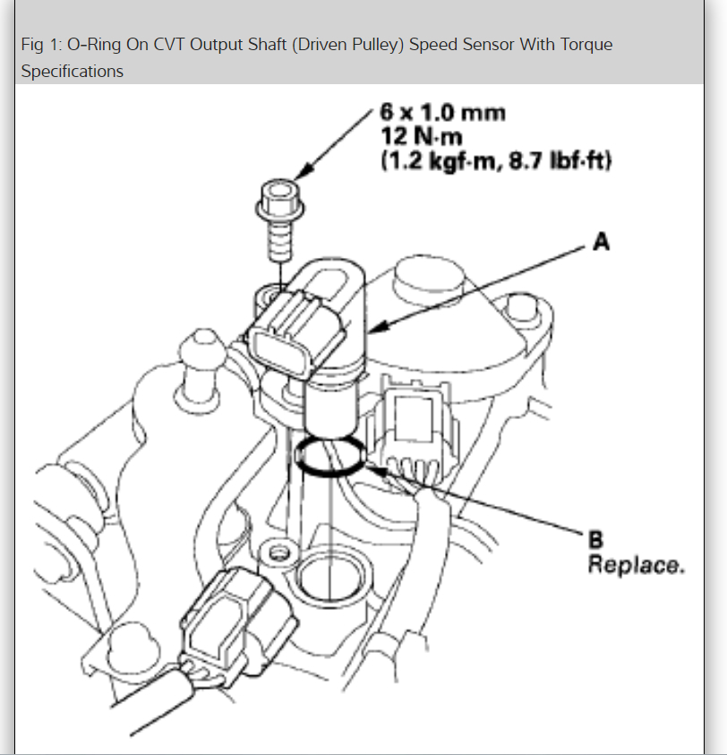

Lets look at the vehicle speed sensor which is sounds like it has gone out. here is the location and instructions on how to change it out. Check out the diagrams below try to use a OEM sensor.
Remove the air cleaner assembly (see AIR CLEANER REMOVAL/INSTALLATION ) and the intake air duct.
Disconnect the CVT output shaft (driven pulley) speed sensor connector, then remove the CVT output shaft (driven pulley) speed sensor (A).
Install a new O-ring (B) on a new CVT output shaft (driven pulley) speed sensor, then install the CVT output shaft (driven pulley) speed sensor in the transmission housing.
Check the connector for rust, dirt, or oil, then connect the connector securely.
Install the air cleaner assembly (see AIR CLEANER REMOVAL/INSTALLATION ) and the intake air duct.
