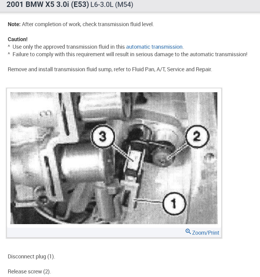

I have a 2001 X5 BMW 3.0 and the speedometer and MPG gauge stopped working, also the ABS light, brake light are on (yellow). Any suggestions???

This sounds like the vehicle speed sensor has gone out but to be sure lets run the codes to confirm the issue.
If so here is the location of the sensor so you can change it out.
Cheers

MAGICALLYDELICIOUS342004
Yes! I fixed my car with this guide cost me $56.00 for the sensor, thanks again. I love this site.

anyone know the part number for above transmission speed sensor?
Mar 1, 2021 at 2:44 AM (Merged)
  • 55,433 POSTS
Sorry our resources dont not have the info, Call the BMW dealer parts department they should be able to help you.
