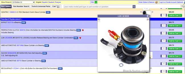

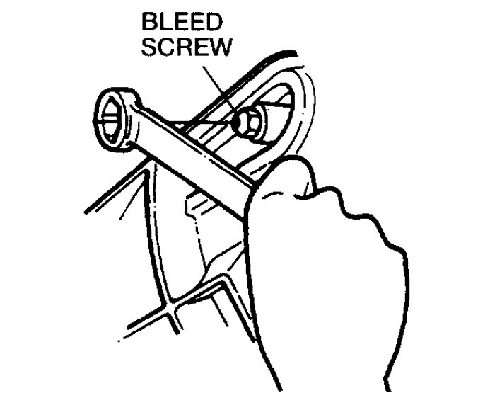

Bleeder valve rusted in place.
Aug 30, 2020 at 4:51 PM
Good morning,

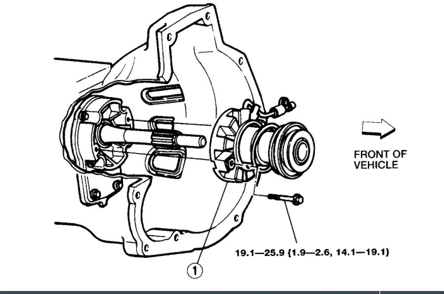

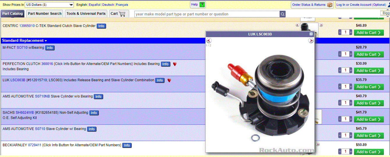

I attached pictures for you of the bleeder and the actual slave itself.
If it does not come loose, you will have to replace it.
The transmission has to be removed as the slave cylinder is part of the throw out bearing assembly.
https://www.2carpros.com/articles/throw-out-bearing-replacement
Do no try too hard to loosen the bleeder or the line will break.
Why are you bleeding the slave?
