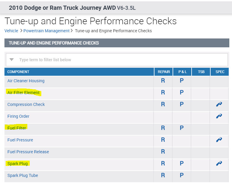

As far as a tune-up, vehicles with coil-over plugs don't require as much. If you look below, I attached a list of things listed under tune-up. Most of the things listed are for inspection.
The things I highlighted are what I would recommend being replaced.

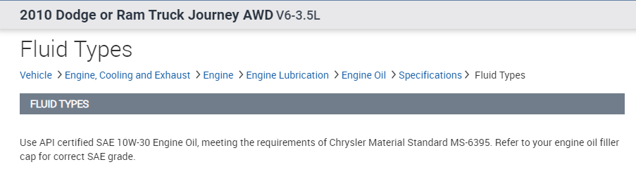

As far as the motor oil is concerned, I'm not sure what you are looking for. The manufacturer recommends 10W30. See pic 2
With the number of miles on the engine, I wouldn't go thinner. You could go a bit heavier if you are located in a warm climate. However, I wouldn't go any more than 10W40. Also, that weight would be okay if the average temperatures are around 70 degrees and really don't get much colder than 40 degrees.

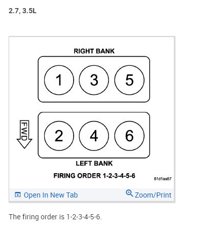

Can I get more information on a tune up and the directions and diagram on how to do the tune i know there are 6 spark plugs I just don't know what is the number position from right to left where is the 1st and where is the 6th or from left to right and is there wires or coils.
Mar 10, 2023 at 2:07 AM
  • 110,240 POSTS
No problem. I attached a pic below that identifies the cylinder numbers. There is an arrow in the pic. That points towards the front of the vehicle.

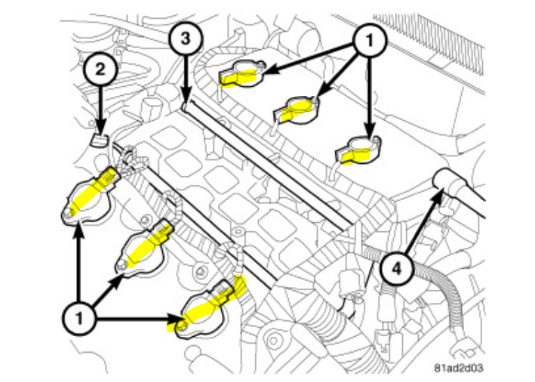

Next, your vehicle has a coil pack for each cylinder. It's called a coil over because to remove the spark plugs, the coil needs to be removed. See pic 2. When you do this, I suggest only doing one at a time to prevent mixing up any of the connectors. There is one bolt that holds the coil pack in place. I believe it is 10mm. Disconnect the electrical connector, remove the bolt, and gently twist back and forth while pulling upward.
Once the coil pack is removed, the spark plug is down inside the plug tower. You will need an extension on the spark plug socket to reach them.
