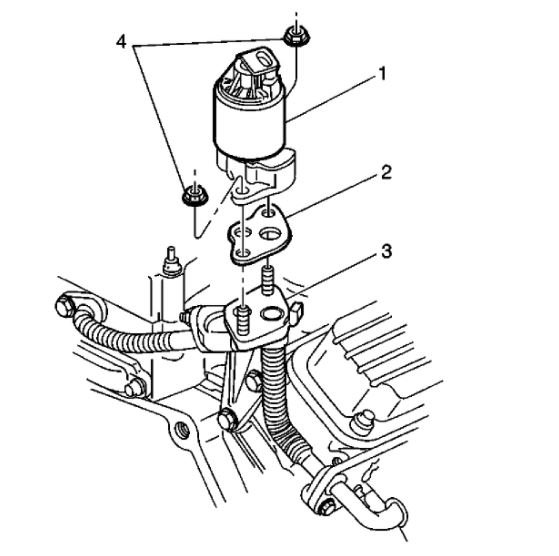

recently got emissions done passed with flying colors. car runs really good except it acts like it wants to take off by itself and it stalls (not all the time) at sudden stops or at a complete stop at the stoplight. everything runs good. help please!
Oct 15, 2020 at 6:18 AM
Good afternoon,
I would start by cleaning the throttle body as carbon build up could cause the high idle and the stalling
Another possibility for stalling is the EGR valve. If it sticks and dos not close all the way, it will make it stall on hard braking. To verify, remove the connector on the EGR valve and drive it and see if it stills stalls.

Where is the EGR valve at on my car listed above SLE? can you send a picture of the part to take off? to see if it still stalls while driving it. how long do I drive it like that? please if you can as soon as possible I do not like driving my like that it's kind of scary.
Oct 16, 2020 at 2:00 AM
I attached the picture in my last response.
Just unlug the connector and take it for a ride.
