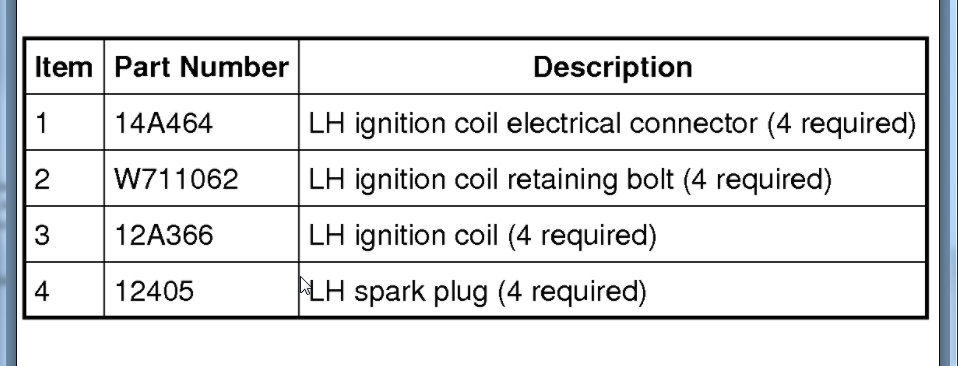

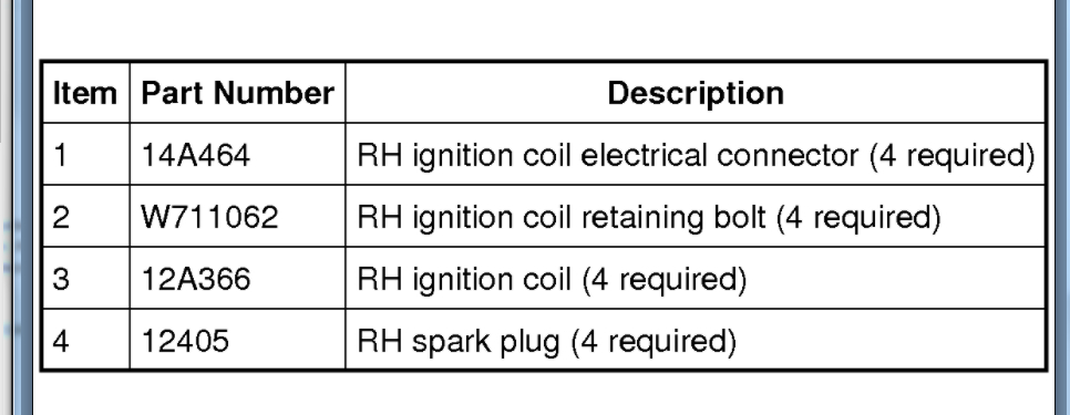

How many spark plugs are there and are they different from each other or all the same?
Oct 30, 2020 at 9:12 AM

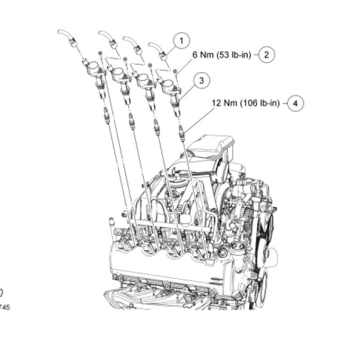

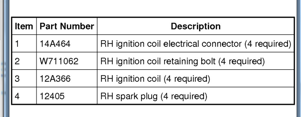

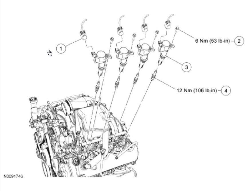

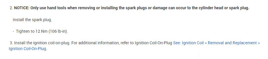

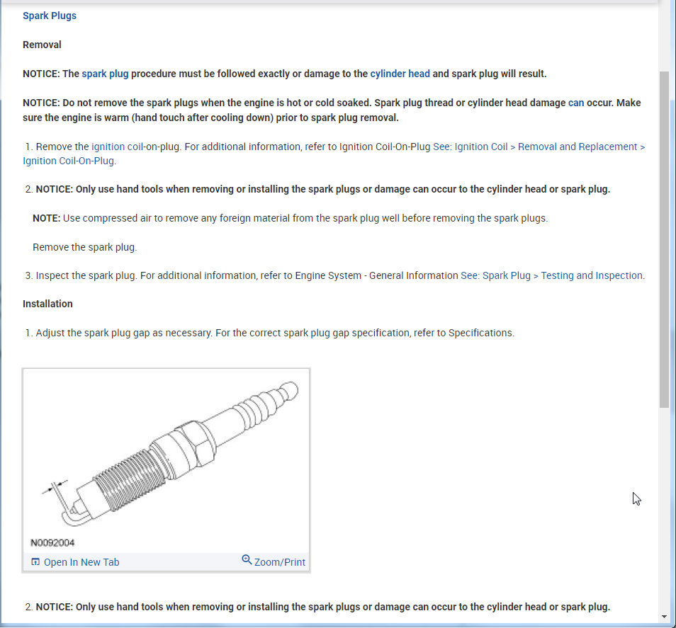

You have 8 total. 4 in each bank of cylinders. I attached all the info. Yes, they are all the same and are normally sold in packs of 4 so you need two packs of plugs.
Let us know if you have other questions.
