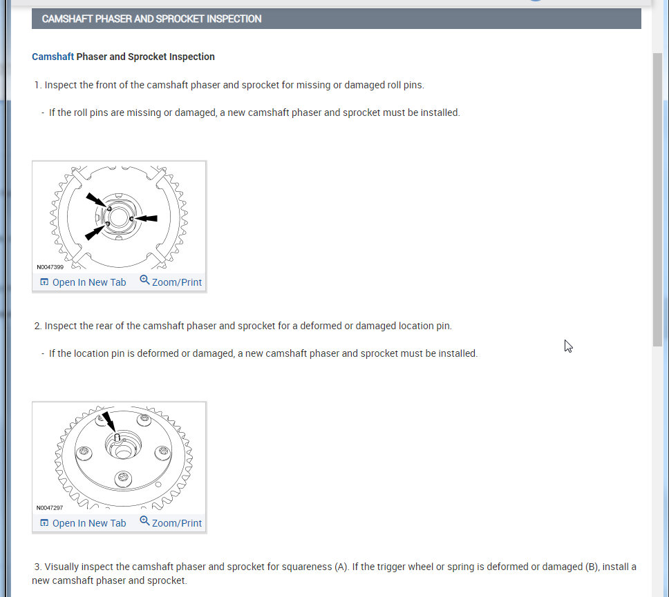

Our car just stopped running out of the blue. They said the think it’s one of 2 things: 1) the solenoid needs replaced or 2) the whole engine needs replaced. One of the two banks is not firing. That seems extreme to need a new engine?
Apr 30, 2021 at 3:59 AM
This could be depending on what they are meaning by solenoid. I assume they mean the phaser which controls the variable valve system. Here is a guide that talks about this:
https://www.2carpros.com/articles/how-camshaft-variable-valve-timing-works
However, I would expect there to be some codes that went with this. If not we need to check before go with either of these repairs because they are pretty large repair.

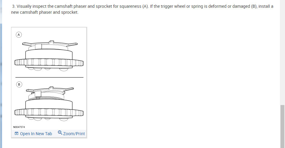

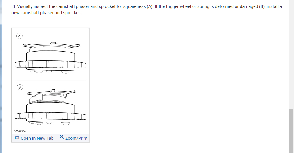

The fact that they are saying one full bank is not firing would point to a common issue which would be the cam phaser but to jump to a complete engine, there would need to be more info saying that is the issue.
Sounds like they did not dig very far into the issue to give such a broad suggestion.
Did they drain the oil and look for metal or remove the phaser and inspect as shown below?
If they did not, I would suggest getting a second or third opinion as this doesn't sound very definitive unless there was more info.
Let us know. Thanks
