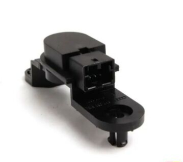

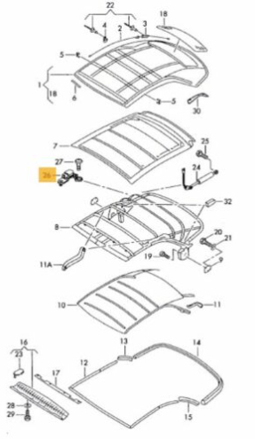

Below is the official guide how to fix the problem. It is a very common issue with this model.
Most likely culprit could be Convertible Top Frame Position Sensor G356 (8H0 959 613)

Also see pictures attached below.

During opening sequence, tension bow has fallen out of range and top operation ceases. DTC 2000 (Switch position incorrect signal) will be stored in the Convertible Top Control Unit. This condition is more common when the vehicle is on an incline with the front of the vehicle elevated, such as when parked in a sloped driveway.
DTC 2000 will be the only fault present for this bulletin to apply. If there are any other faults in the convertible top control unit, these malfunctions must be corrected first. Only after these are corrected and the above condition is still present, accompanied by DTC 2000, should you continue.
Only technicians who have successfully completed Self Study Program 991203 - The Audi A4 Cabriolet and course number 991202 - Audi A4 Cabriolet Introduction are permitted to service the A4 Cabriolet. If you have not completed these prerequisites, do not continue with this bulletin. Have the case dispatched to a qualified A4 Cabriolet technician.
Technical Background
During the opening phase of the convertible top run, the front lock lifts from the windshield and the tension bow lifts to a vertical position to allow clearance for the convertible top box lid to open. The lid is then unlatched. During the unlatching of the top box lid and at the point when the tension bow is vertical, the opening strategy calls for the hydraulic pump to shut off momentarily. During this "off period" the tension bow is not under pressure and can slowly drift backwards before the top box lid can unlatch completely. Within this time period, the tension bow may have exceeded its plausible operating range. This will cause the top operation to cease. DTC 2000 (Switch position incorrect signal) is stored.

a. Connect the diagnostic tester and address 26-Convertible Top Operation Control Module. View MVB 1, field 4. This is the value for Convertible Top Frame Position Sensor G356.
b. Move the top into position 4 from test of import conv. top positions w. spec. values. This position has the tensioning bow up and the cover closed.
c. Turn the key off. MVB 1 will stay live. The tensioning bow can now be moved freely.
d. With the tensioning bow held to its uppermost position note the value for G356 in field 4. Write this value down.
e. At this time note the switch positions in field 2, specifically position 6 (3rd from left). This character will read 1 with the tensioning bow in its uppermost position. Slowly move the tensioning bow down while observing position 6. When this character changes to 0 note the G356 value in field 4 and write this value down.
f. Subtract these two values. If the difference is less than 22, replace Convertible Top Frame Position Sensor G356 (8H0 959 613) with the improved version, which is identified with a yellow dot.
g. After installation, perform J256-adaptation-Convertible top frame position sensor in Guided Fault Finding.
