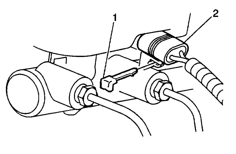

Bench bleeding (picture 1)
1. Plug all the ports with suitable fittings which cannot damage the pipe seats.
2. Run hoses from the fittings back into the reservoir.
3. Hold the master cylinder securely by the mounting flange so as not to cause any distortion and to enable the pistons to be stroked.
4. Fill the reservoir with new brake fluid.
5. Open the secondary port to the atmosphere and depress the pistons to fully bottom out the master cylinder. To depress the pistons use a rod with a blunt end which will not damage the pushrod location on the primary piston, or cause contamination in the master cylinder bore.
6. Close the secondary port and return the pistons to their released position.
7. Repeat Steps 4 and 5 until fluid flows freely from the port until there is no evidence of air bubbles.
8. Repeat Steps 4, 5 and 6 using the primary port.
9. With the ports plugged, stroke the pistons. A solid feel should be evident with a piston travel of approximately 4 mm (0.157 inch).
10. If the above piston travel is excessive, repeat the bleeding operation steps 4, 5, 6 and 7; then recheck the piston travel.

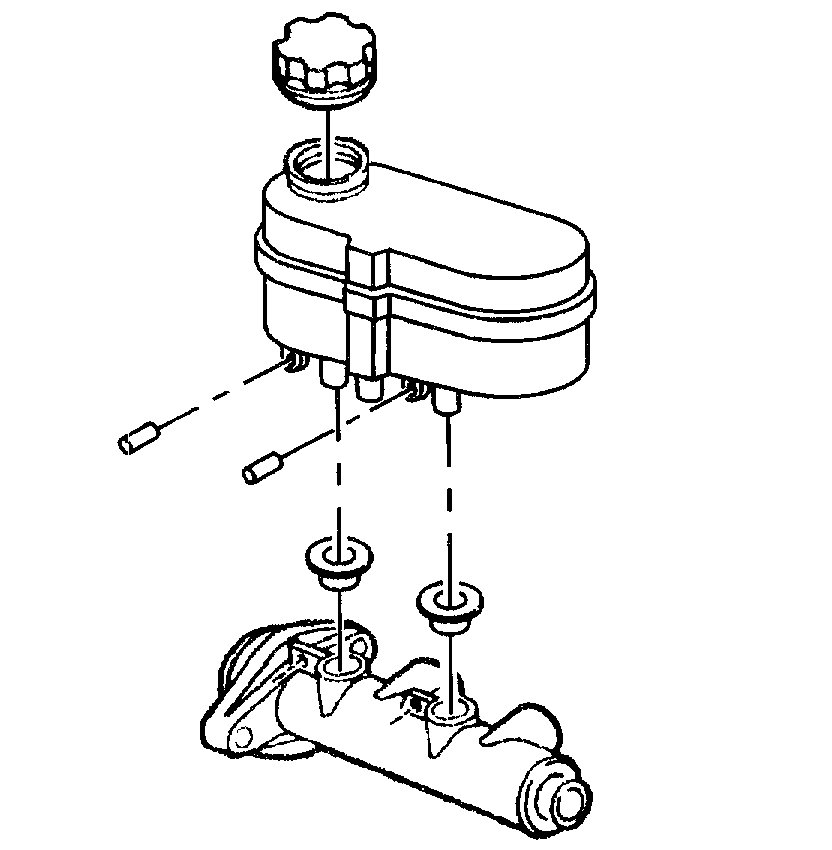

Often times when you purchase a new MC, you have to reuse the old reservoir. Here are the directions for removal and replacement. See attached pics.
MASTER CYLINDER RESERVOIR REPLACEMENT
REMOVAL PROCEDURE
pic 2
1. Remove the retainer (1) and the electrical connector (2) from the fluid level sensor.
2. Drain the brake fluid from the master cylinder reservoir.

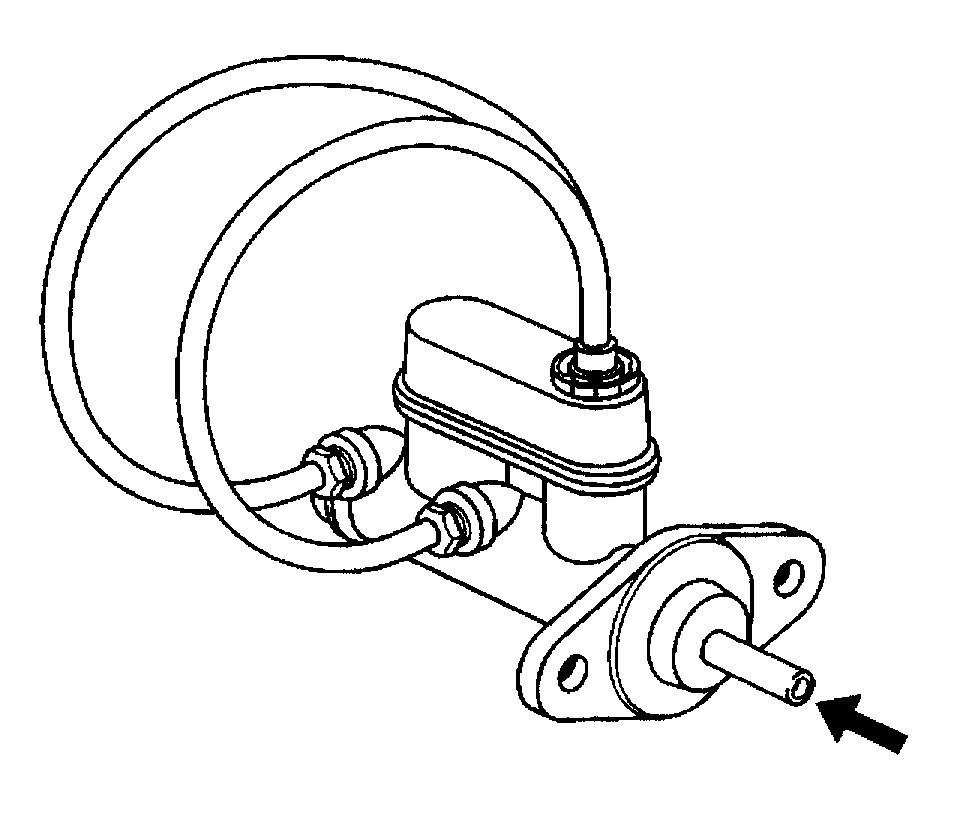

pic 3
3. Tap back the pins until clear of reservoir. Be careful not to damage the reservoir or master cylinder. If needed, loosen or remove the strut cross bar for access.

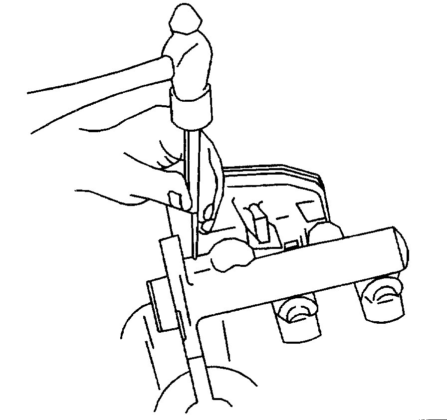

pic 4
4. Remove the reservoir.
