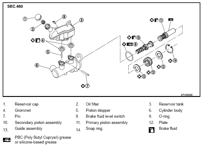

We were driving on flat ground at around forty five km/h and when my wife hit the brake the pedal went straight to the ground and ABS kicked in. There is no leak of fluid or any warning lights coming on. Any ideas?

If the brake pedal went to the floor, the master cylinder is still full, and there are no leaks, the master cylinder is bad. There are pistons in the master cylinder which are to create pressure when you apply the brakes. If it goes to the floor, they are bypassing the brake fluid.
I have attached a picture for you to see the internal components of the master cylinder. Numbers 10 and 11 are the pistons I am referring to. Please keep in mind, this system is designed to have two separate systems. You have a primary and secondary. It would be very odd for both to fail. However, it is designed so the primary actuates the front brakes and the secondary operates the rear. If one fails, you will still have the other to help stop. Regardless, the brake pedal will go to the floor.
Take a look at the picture to better understand. Also, I feel this is the problem based on the idea there are no leaks, the fluid is still full.
