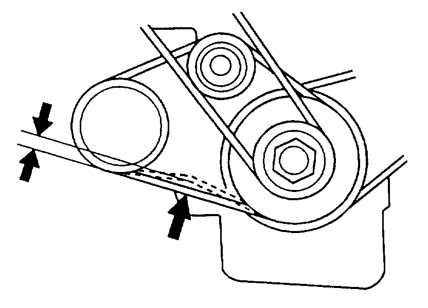

Deflection Method
pic 1
1. Apply a force of 98 N (10 kg, 22 lb), and measure the deflection between the A/C compressor and the crankshaft pulley.
A/C Compressor Belt
Used Belt:B16A2 engine
6.0 - 9.5 mm (0.24 - 0.37 in)
Except B16A2 engine
7.5 - 9.5 mm (0.30 - 0.37 in)
New Belt: B16A2 engine
4.5 - 6.5 mm (0.18 - 0.26 in)
Except B16A2 engine
5.0 - 6.5 mm (0.20 - 0.26 in)
Note these items when adjusting belt tension:
- If there are cracks or any damage evident on the belt, replace it with a new one.
- "Used belt" means a belt which has been used for five minutes or more.
- "New belt" means a belt which has been used for less than five minutes.
2. Loosen, the center nut of the idler pulley (SANDEN), or the pivot bolt of the idler pulley bracket and the lock nut of the adjusting bolt (DENSO).
3. Turn the adjusting bolt to get proper belt tension.
4. Retighten the center nut of the idler pulley (SANDEN), or the pivot bolt of the idler pulley bracket and the lock nut of the adjusting bolt (DENSO).
5. Recheck the deflection of the A/C compressor belt.

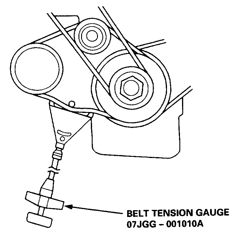

Tension Gauge Method
pic 2
1. Attach the special tool to the A/C compressor belt as shown below, and measure the tension of the belt.
A/C Compressor Belt
390 - 540 N (40 - 55 kg, 88 - 120 lb)
Except B16A2 engine
340 - 490 N (35 - 50 kg, 77 - 110 lb)
740 - 880 N (75 - 90 kg, 170 - 200 lb)
Except B16A2 engine
690 - 830 N (70 - 85 kg, 150 - 190 lb)
- Follow the manufacturer's instructions for the belt tension gauge.
2. Loosen the center nut of the idler pulley (SANDEN), or the pivot bolt of the idler pulley bracket and the lock nut of the adjusting bolt (DENSO).
5. Recheck the tension of the A/C compressor belt.

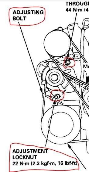

Here is a link of belt routing for your vehicle.
https://www.2carpros.com/diagrams/honda/civic/1998
In the last picture, I circled where adjustment is made for the AC belt. Loosen the mounting bolts (through bolt and adjustment lock nut) and simply tighten the adjusting bolt to achieve the tension needed.
