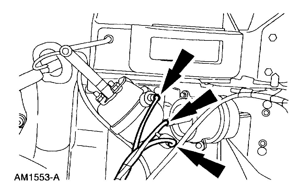

Smoke coming from my defrost vent
ALISON40
  • 2000 MERCURY MARQUIS
  • V8
  • 2WD
  • 280,000 MILES

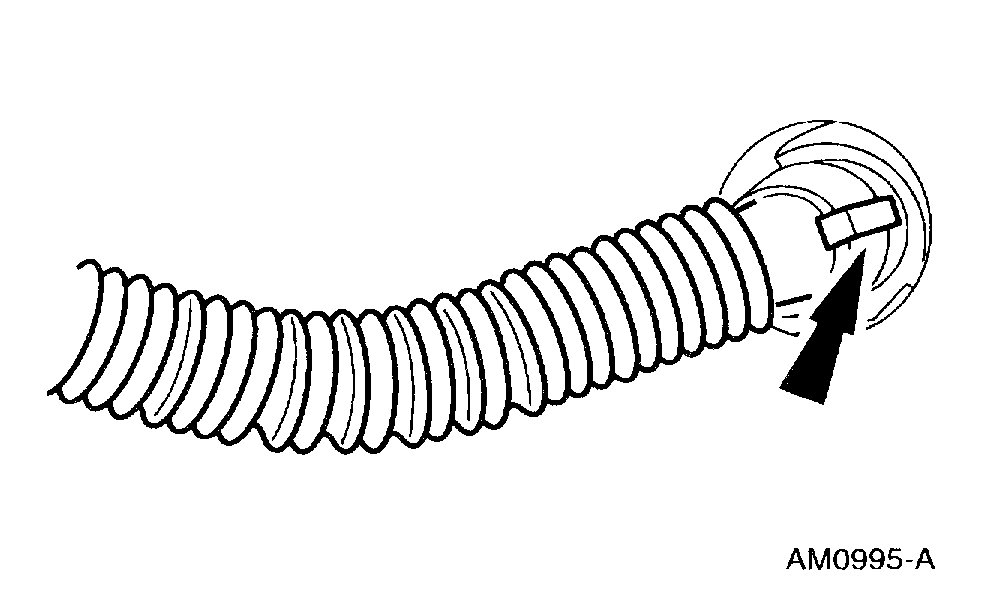

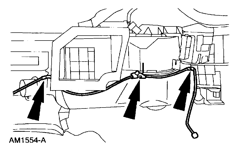

Still blows but after it heats up smoke will come from vent I noticed today that when I accelerate it comes out then when I stop at red light it stopped a little smell but not much no leaking inside of car what could be the problem?

The smoke you are seeing is coming from the evaporator core. It is air conditioning oil leaking from the evaporator. You will need to replace it.
Sunday, January 12th, 2014 AT 11:14 PM
  • 109,885 POSTS
Usually when you see smoke from the defroster, it is related to the heater core. I realize there isn't any evidence of coolant in the vehicle, but the leak could be very small.
Coolant usually has a sweet smell to it. If that is the case, I suspect the core needs replaced. Here is a link that shows in general how to do it:
https://www.2carpros.com/articles/replace-heater-core
Now, before I actually would replace it, I would recommend pressure testing the system. Although you may not see a leak, you may hear a leak. Here is a link that explains how to pressure the cooling system:
https://www.2carpros.com/articles/radiator-pressure-test
You will need a pressure tester, but most parts stores will lend them to you.
If you determine it is the heater core, here are directions specific to your vehicle for replacement. Just a note, the plenum chamber needs removed. I will start with those directions first. The attached pictures correlate with the directions.

1. Remove the rear seat airflow duct. For additional information, refer to Air Duct. See: Air Duct > Procedures
2. Remove the instrument panel. For additional information, refer to: Dashboard/Instrument Panel. See: Dashboard / Instrument Panel > Service and Repair

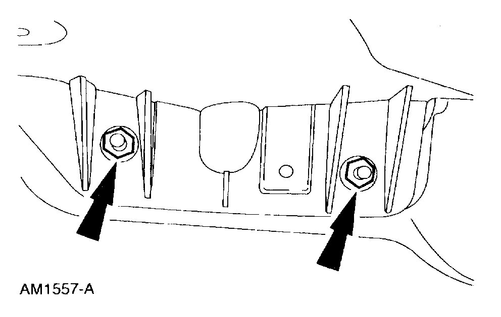

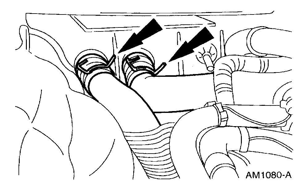

4. Disconnect the heater water hoses.
pic 2

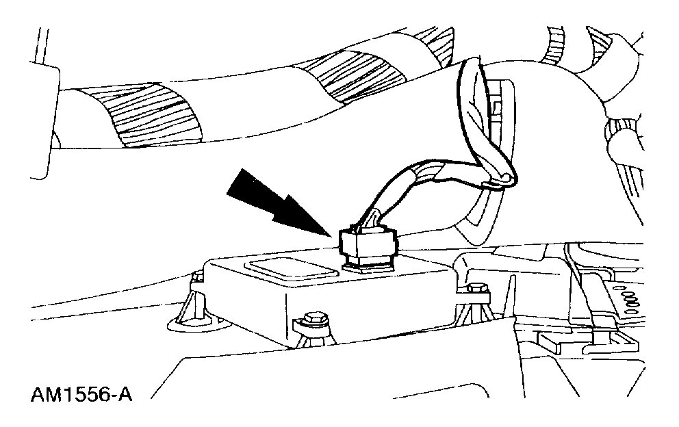

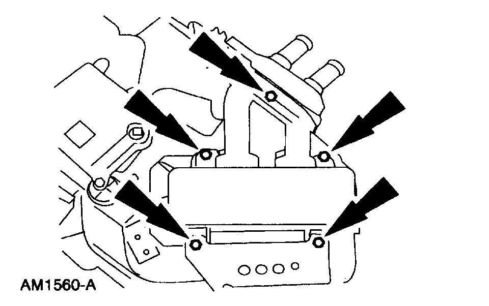

5. Inside the vehicle, remove the nut.
pic 3

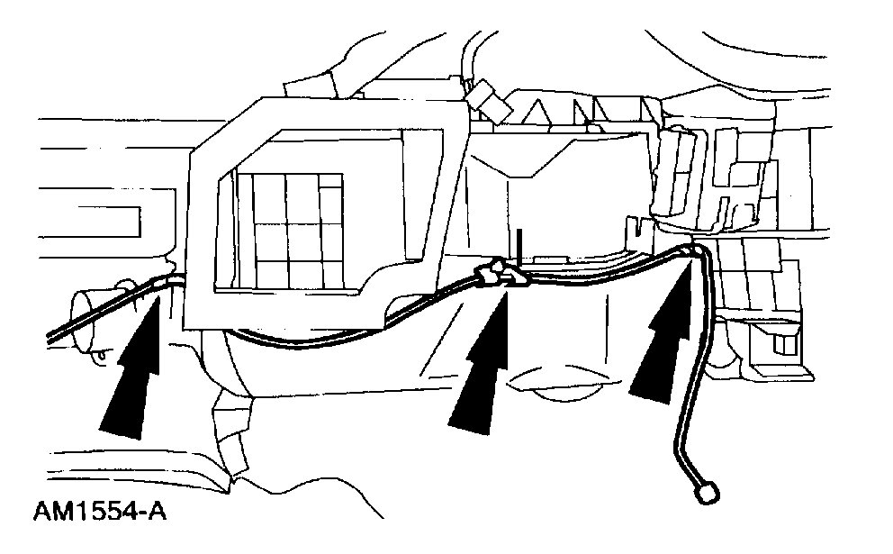

6. Disconnect the vacuum hoses.
NOTE: Mark the locations of the vacuum hoses.

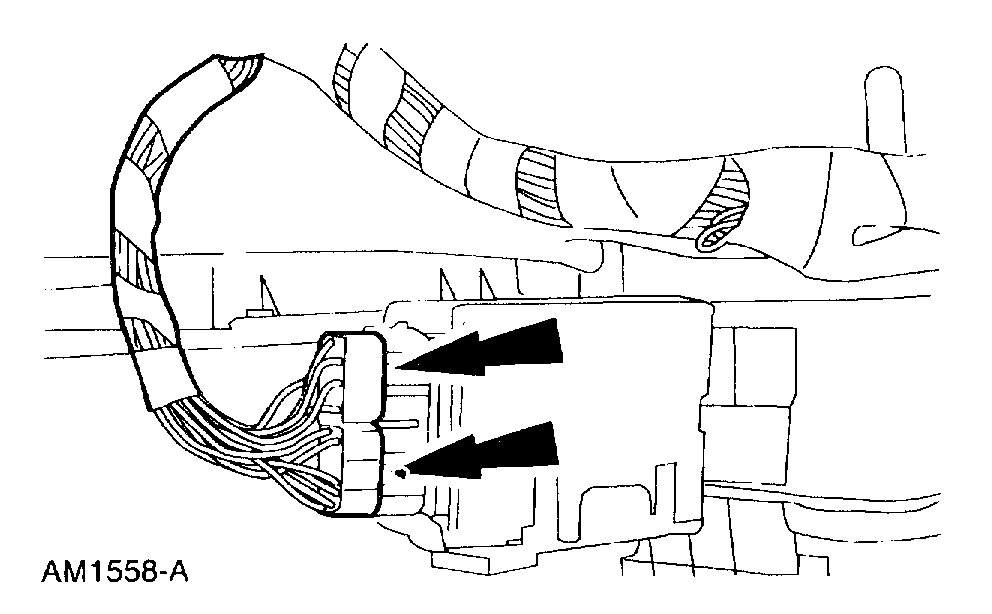

7. Disconnect the vacuum hose.

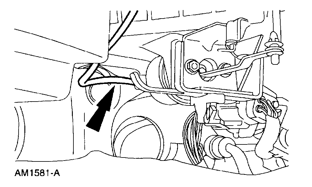

8. Remove the pin-type retainers and remove the vacuum harness.

9. Disconnect the connector.
pic 7

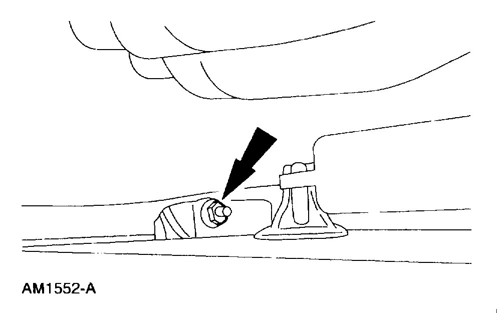

1O. Remove the nuts.
pic 8

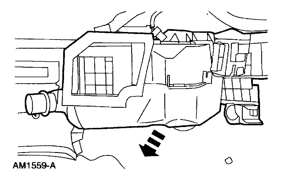

13. Remove the plenum chamber.

NOTE: If a heater core leak is suspected, the heater core must be leak tested before it is removed from the vehicle.

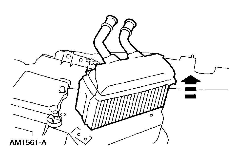

1. Remove the plenum chamber.
pic 19
2. Remove the screws and the heater core cover.
pic 20
3. Carefully cut the seal above the heater core inlet and outlet tubes and remove the heater core.
