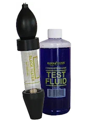

This is a chemical test you can get at an auto parts store, which will change colors if there are combustion gases entering the cooling system. The package comes with instructions, it is very basic.
While you are at the auto parts store, they can scan the engine computer for any stored trouble codes that can help diagnose the issue.
