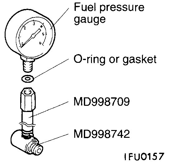

Won't pass do to high no. first start of the day is around 2-3 long cranks before it slowly sputters to life. After that no starting issues.
If I clamp the fuel return line it starts in the morning fine, seems to run smoother , more power and no light. When the light is on I get codes 11, 21 and 22 by counting the blinks of the check engine light. If one can trust that method .I've recently changed timing belt, water pump, fuel pump/filter/ and regulator. Crankshaft position sensor, temperature sensor, idle air control valve. the catalytic converter and o2 sensors are about a year old . Checked most wiring engine and computer side. So why if I clamp the return it's good?

By blocking the return, it raises the fuel pressure at the rail. I realize that you have already replaced a lot, including fuel-related components. However, have you checked to confirm the pressure is within the manufacturer's specs?

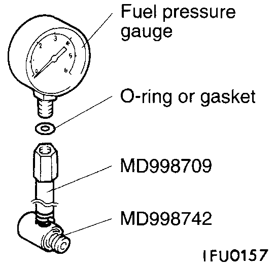

3. Connect a fuel pressure gauge to the special tool, placing an adequate 0-ring or gasket between the gauge end special tool to prevent fuel leaks.
4. After carrying out step (3), install the special tool between the fuel rail and the fuel pressure regulator.

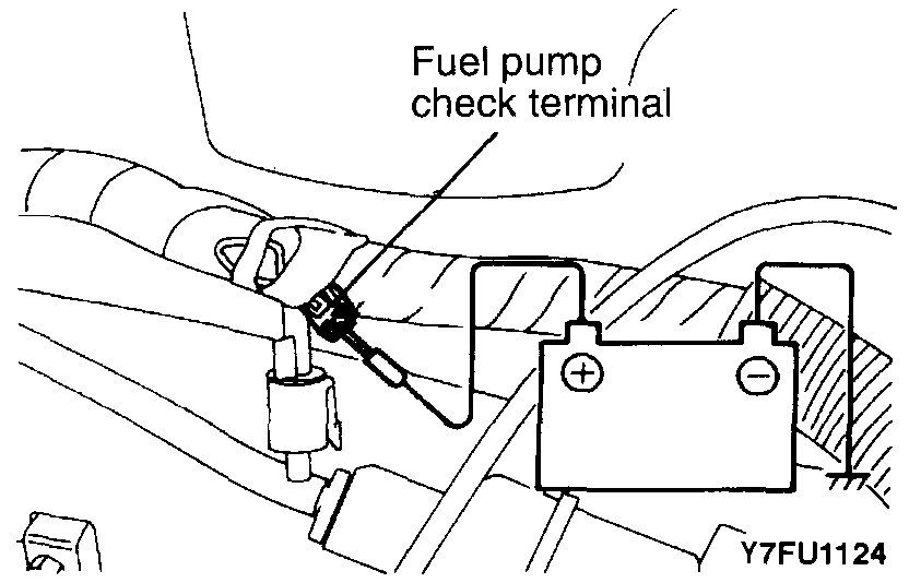

Testing the Fuel Pressure - Engine Running
pic 2
1. Connect a jumper wire to the terminal for activation of the fuel pump and to the positive battery terminal to activate the fuel pump. With fuel pressure applied, check that there is no fuel leakage from the fuel pressure gauge and the special tool connection part.
2. Disconnect the jumper wire from the terminal for activation of the fuel pump to stop the fuel pump.
3. Start the engine and let it idle.
4. Measure the fuel pressure during idling.
Standard value: Approx. 270 kPa (38 psi) at curb idle

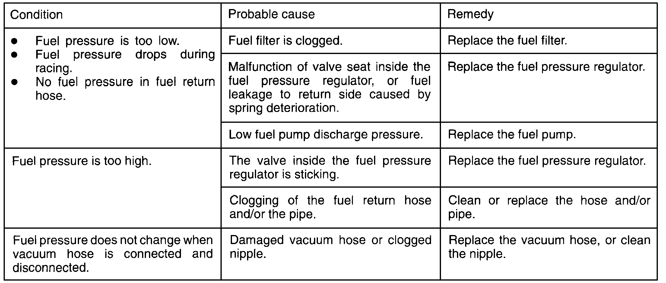

pic 3

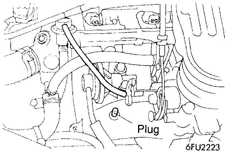

5. Disconnect the vacuum hose (blue stripe) from the intake manifold and then plug the nipple.
6. Measure the fuel pressure in this condition.
Standard value: 330-370 kPa (47-53 psi) at curb idle speed
7. Check that the fuel pressure during idling does not decrease even after the engine is raced a few times.
8. Use a finger to gently press the fuel return hose while repeatedly racing the engine, and check that there is fuel pressure in the return hose also.
NOTE: There will be no fuel pressure in the return hose if there is insufficient fuel flow.

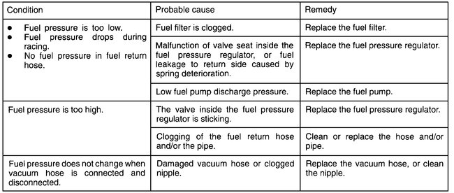

pic 4

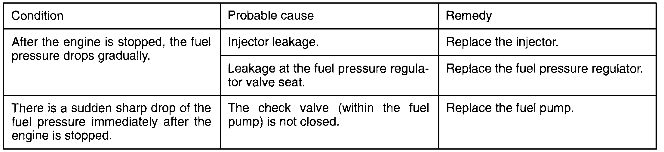

9. If the fuel pressure measured in steps (4) to (6) is outside the standard value range, check for the probable cause by referring to the table above, and then make the appropriate repair.

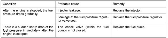

Testing the Fuel Pressure Leakdown - Engine Off
pic 5
Stop the engine and check for a change of the value indicated by the fuel pressure gauge. The condition is normal if there is no decrease in the indicated value within two minutes. If there is a decrease in the indicated value, monitor the speed of the decrease, and, referring to the table above, determine the cause of the problem and make the appropriate repair.
