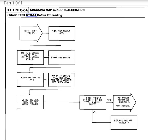

NOx gases can be caused by several different things. For example, High engine combustion temperatures, an excessively lean fuel mixture, if the catalytic converter is damaged, worn out, or not functioning properly, it can result in higher NOx levels, and the list goes on.
Based on what has already been done, there isn't much left. However, I do have a question. Has anyone thoroughly checked for an engine vacuum leak? If there is a leak, it will lean the fuel mixture.
Also, has anyone tested the manifold absolute pressure sensor (MAP)? The MAP sensor helps the ECU determine the engine load. The engine load is a crucial parameter used by the ECU to calculate the appropriate fuel injection timing, air-fuel mixture, and ignition timing.
Let me know. If you can, follow the directions in this link to see if you are able to find any engine vacuum leaks:
Also, if you look at the pic below, it provides the directions for a basic MAP sensor test. Let me know if you are comfortable performing it.
See pic below.

Vacuum at the EGR supply is 18" at idle. I expected the two repair shops to find any vacuum leaks. But the modern plug and play mechanics have shown a skill vacuum when encountering my truck. I will do a comprehensive search with carb cleaner. Thanks for the video. The 1995 dakota has the original OBD system, with the old interface, so my OBDII tester will not work for testing the MAP sensor. So vacuum leak testing and manual MAP sensor testing next.

MAP sensor output voltage varies properly with vacuum at stopped, idle, rev, and decel. Intake air temperature and coolant temperature sensors have correct resistance and vary with temperature. Computer has code 12 - less than 50 starts in memory, and code 55 - done reporting. Driven to another shop, who gave up immediately when they found no trouble codes. Another plug and play shop. Carburetor spray all around, with several pauses to let the spray evaporate. Shaded from radiator fan air flow and wiggled hoses too. No vacuum leaks found.
