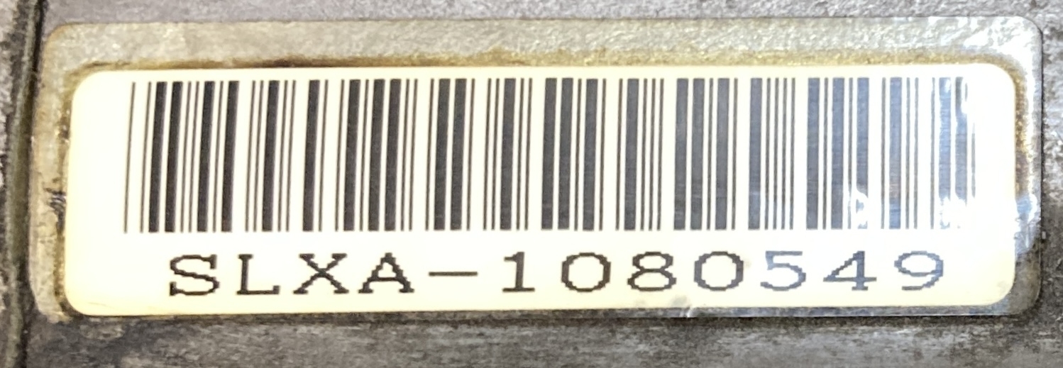

My car is made in the USA. I’m told it was originally equipped with a BMXA per Honda Dreamshop. I have the serial off the SLXA, again how can I find out if this SLXA is USA made and compatible with my car?
Nov 19, 2024 at 7:19 AM
  • 55,694 POSTS
If you give me the number I can find out for you.
Nov 21, 2024 at 2:05 AM
KURT BARLOW
  • 6 POSTS
Okay, here is the serial.
Are all SLXA transmissions made in Japan for Japanese cars?

Honda makes a few different versions of their cars depending on the market they are sold in. Their popular cars however may be assembled in different plants and still shipped to the same market. That is how you get a Honda Civic that was put together in Ohio selling on the lot next to one put together in Suzuka. They are mostly the same in appearance and build, but there are differences in hidden areas, like wiring can be slightly different colors or routing, or the assemblies may be build specific. That is the case with the transaxles. The SLXA is a JDM transmission made for the cars assembled in Japan but shipped to the US. The BMXA is the same design but made in the US for the US built Civics. They are not directly interchangeable. They will bolt up but the convertor on the SLXA is commonly smaller and has a different bolt pattern, the internals of the BMXA are also slightly different because the US market cars are built to handle the larger engines and weight of the US cars. The big thing is that you can mix and match the parts to fit them into the other vehicle but it's a mess if you don't use the correct parts.

From what I was able access in the service manual and online, it indicates that there were in fact 3 different transmissions installed in these Civic EX sedans.
The way I read this, I could have one of two of these automatics in my Ohio made 01 Civic.
Transmission Type
BMXA: 4-speed Automatic (U.S. made)
SLXA: 4-speed Automatic (Japan made)
SLW:5-speed Manual
BMXA: 5000001 - (2001 model)
6000001 - (2002 model)
7000001 - (2003 model)
SLXA: 1000001 - (2001model)
2000001 - (2002 model)
3000001 - (2003 model)
SLW:
1000001 - (2001-2003 models)
Dec 10, 2024 at 6:51 AM
