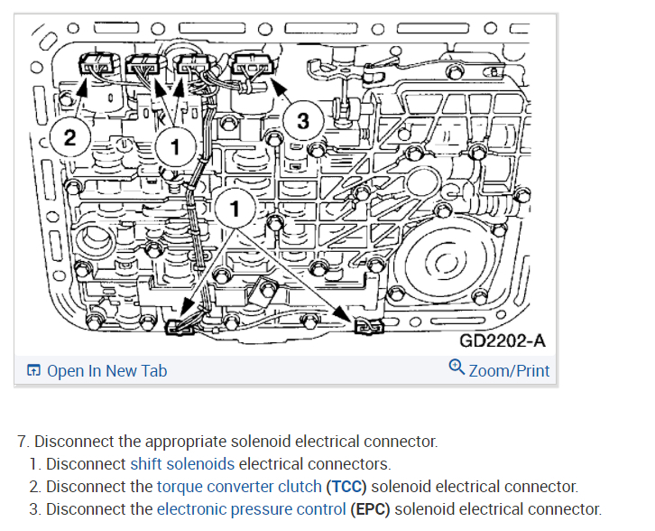

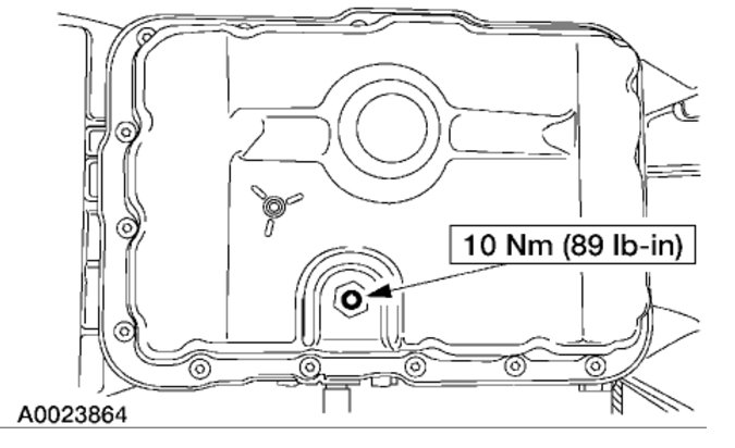

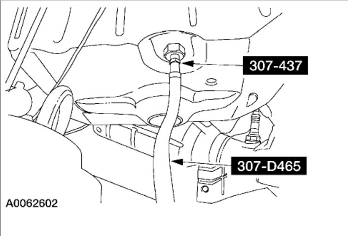

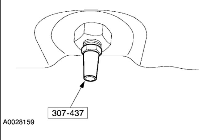

We should make sure the fluid level is okay. but it sounds like the pressure regulating solenoid #3 is out. Here is the location so you can check it out with instructions on how to check the fluid level. lets run the codes as well.

Okay, I will go check that out . I hook up a Diablo 2 scanner and programmer to it . And it shows no codes . But i have also read you have to have particular scanner for transmission codes. But I'll do what you said and get back with .
Thanks, jackie

The scanner should pick up transmission codes as well. This could be a bad PCM which is common. Let me know after fluid and pressure regulating solenoid check replacement.

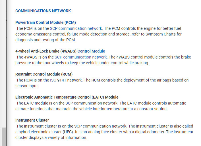

We need to use a scanner to get the actual codes. These are all cluster codes that could point to shifting issues but they are not going to directly relate to a powertrain issue so we really need to get the codes.
You can stop by a parts store if you don't have a scanner to get them and that should get them for us.
However, these SCP codes are pointing to a communication network issue so that is good to know as we should have some codes that will point us in the right direction.
I attached below a quick explanation of these modules and the SCP system.
Please let us know what you find and we can go from there. Thanks
