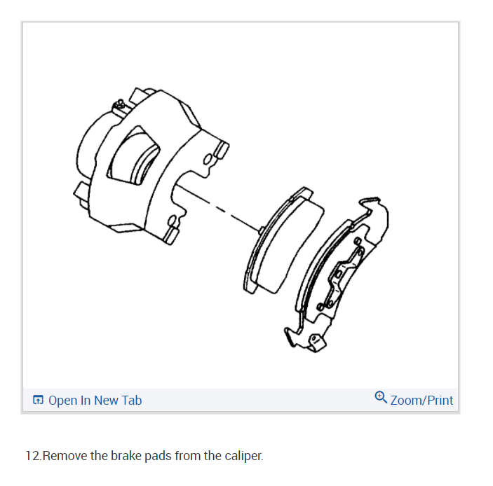

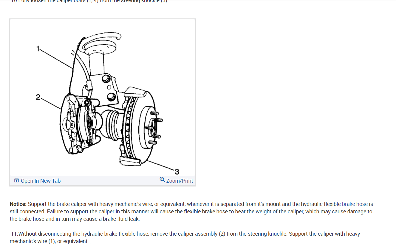

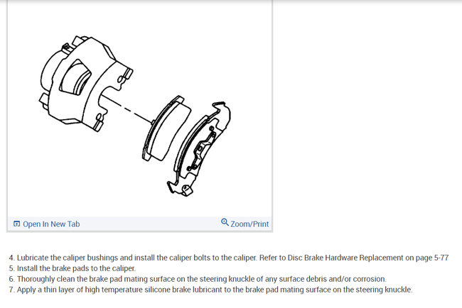

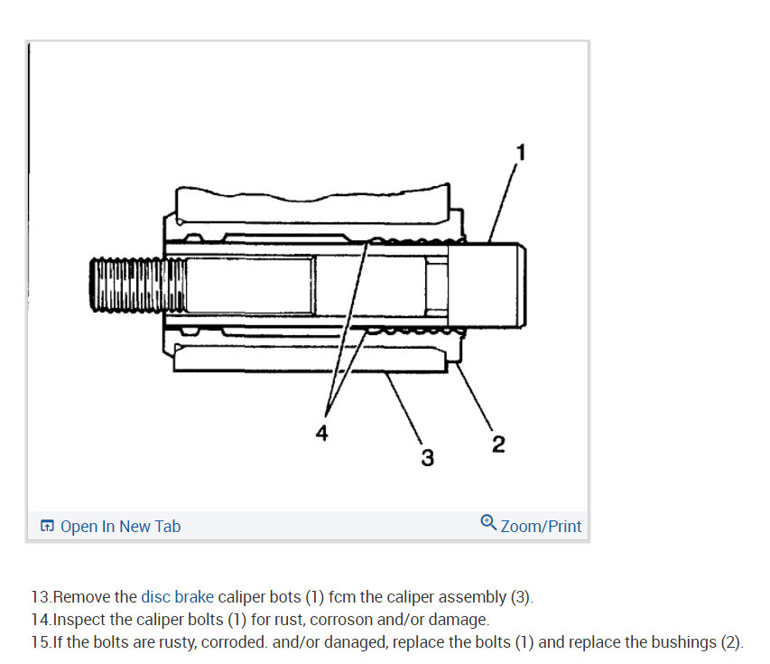

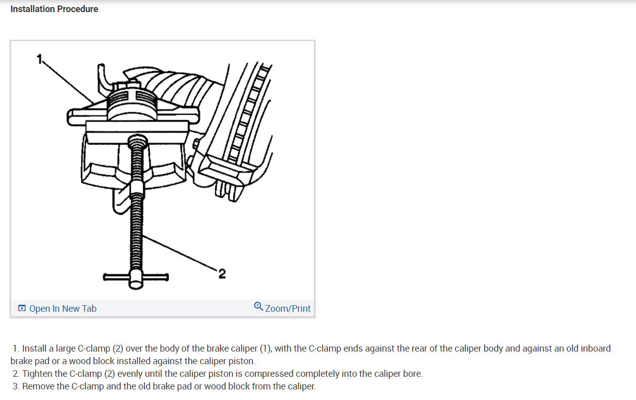

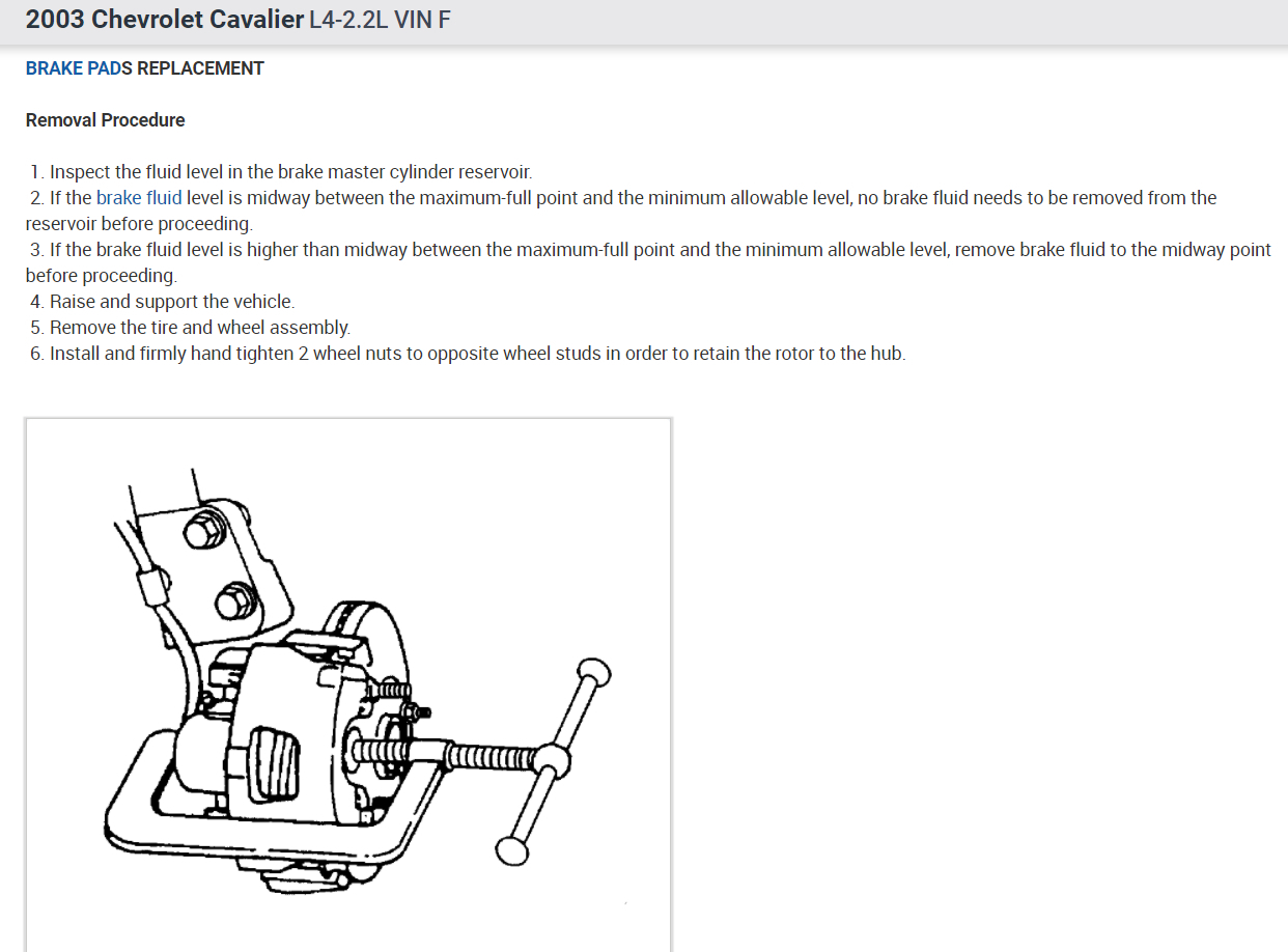

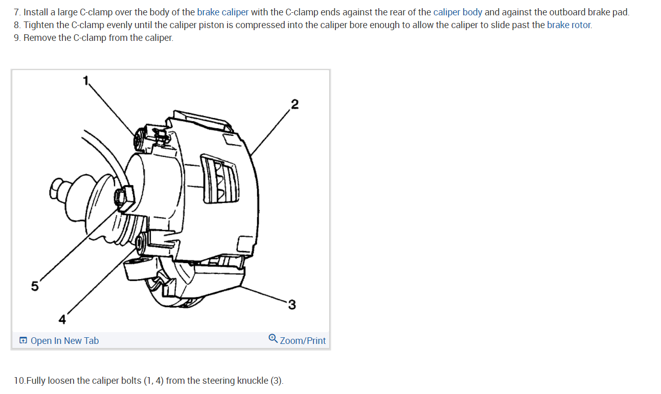

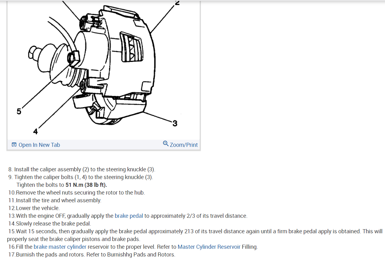

it will usually be the front brakes that do this, but we should check all four brakes. Here are two guides to help walk you through the job with diagrams below to show you how on your car. Can you please shoot a quick video with your phone so we can hear the noise? that would be great. You can upload it here with your response.
https://www.2carpros.com/articles/steering-wheel-shakes-when-accelerating-or-braking
and

I need more information. The original post was about a noise. Is that still the issue? I noticed you had the rear brakes replaced, so I'm not sure.
Also, if you are only feeling the noise/vibration when applying the brakes, there is a good chance it is the front brake rotors.
Here is a video showing front brake pads and rotors being replaced:
https://youtu.be/CrTaafbfk0s
If it is something different such as a drivability issue (jerking), I need you to start a new thread. Simply copy and paste your new question and create a new link.
I hope you understand. We try to keep the treads specific to one topic so it is more helpful to others.
