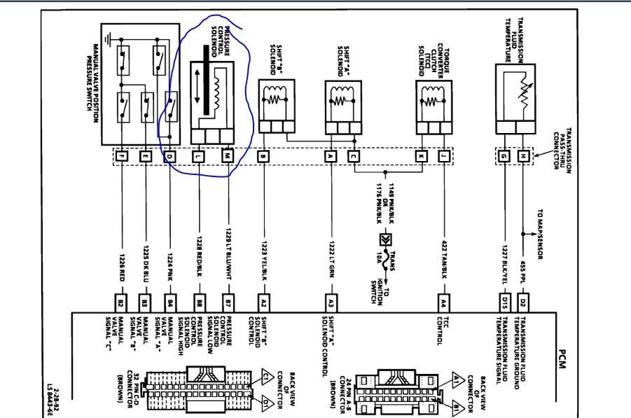

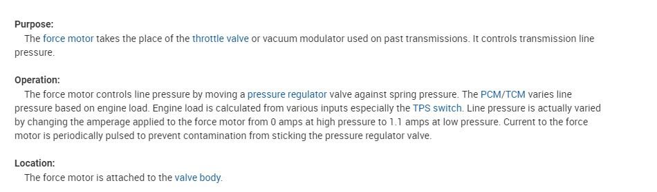

There is a pressure control solenoid in the valve body which regulates main line pressure.
Without the code that is set, I am going on my experience here.

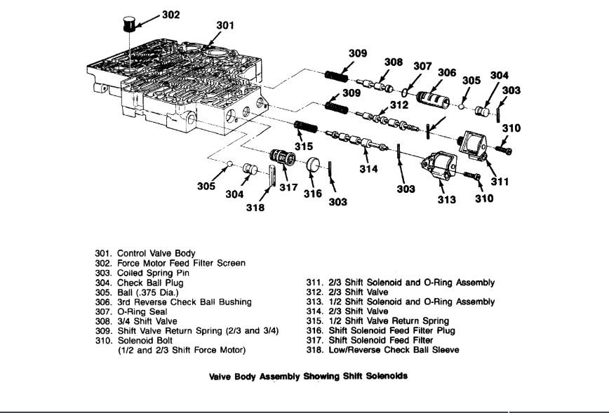

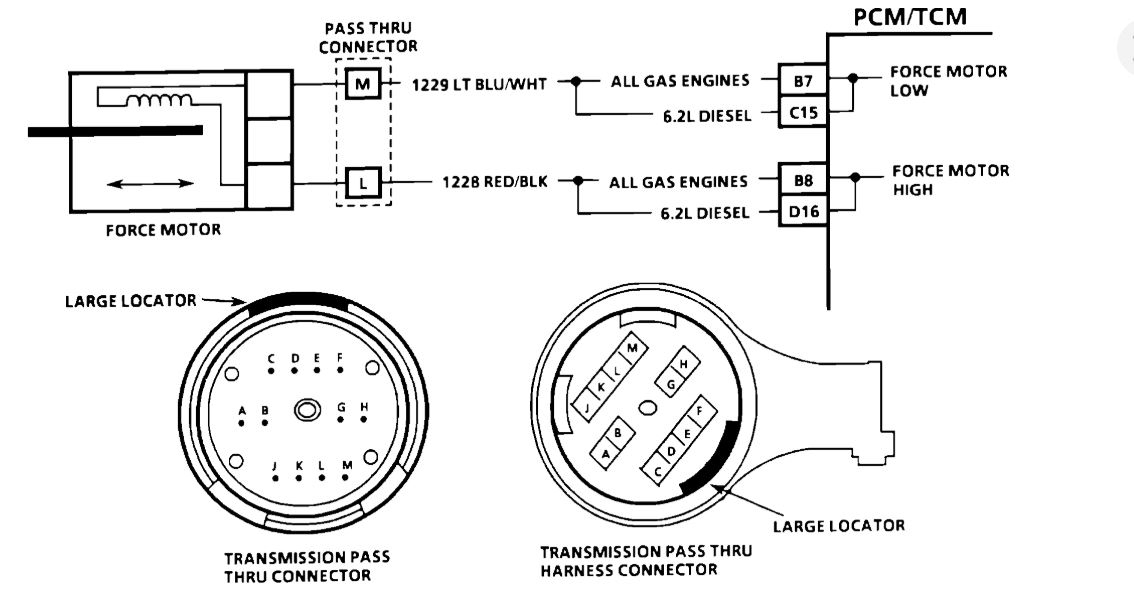

If that solenoid hangs open, it will bleed off all the pressure and it will not move. It has an electrical harness inside the pan that controls it from the engine ECM. I would check the harness in the pan for any damage or fluid in the harness. Disconnect the harness at the transmission and check the connector. If it has fluid in the connector, replace the internal harness in the transmission.
I attached a wiring diagram for you to vie but the controls are handled by the ECM. You would need a scan tool for OBD1 and monitor the action of the solenoid controls.
