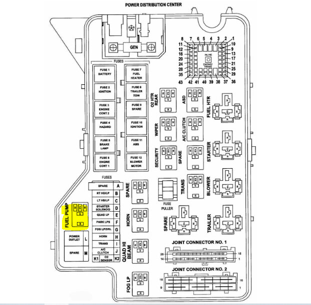

shutting off while driving?
2001 DODGE RAM
190,000 MILES
HAYDEN.HOLLY14
i have the truck listed above 1500, it started as a shut off after a long idle. the progresses into shutting off going down the road. don’t know what to do. no warning signs to shut off and it cannot be predicted, shuts off and all gauges bottom out. You must wait for it to show gas again before cranking. It can take 5 minutes to a couple of hours. cleaned the IAC valve and replaced multiply relays. help?
Aug 5, 2023 at 1:03 PM
  • 110,244 POSTS
If the gauges are dropping off to nothing, it sounds like we have an electrical issue that is being affected by heat.
Do me a favor. In the under-hood fuse box, you will find the fuel pump relay. Remove it and inspect it for corrosion or damage to the connectors. See pic below for location.
This relay is a 5-pin relay. If there is a different one in the box having the same part number, switch them and see if it makes a difference.
Here is a link that explains how to check a relay if there isn't a matching one in the fuse box:
See pic below.
