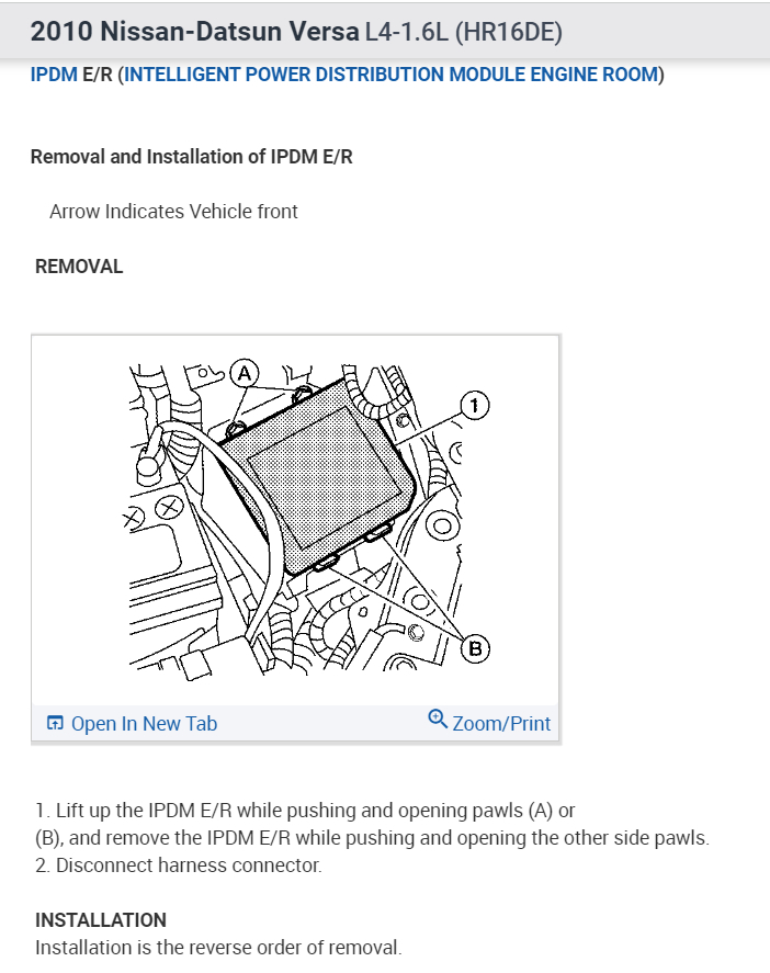

This sounds like one of two things, either the ECM power relay is going out, or the IPDM module is bad which is common but to be sure let's do a CAN scan which is the future of automotive repair you can get a CAN scanner from Amazon for about $30.00. Here is a video to show you how and a link to a scanner from Amazon:
https://youtu.be/u-4syLc-ifQ
and
https://amzn.to/3OpAotj for the scanner
Please run down this guide and report back. Here is the location of the relay (inside the IPDM) and how to change out the IPDM in the diagrams below. It is easy because the IPDM self initializes.
