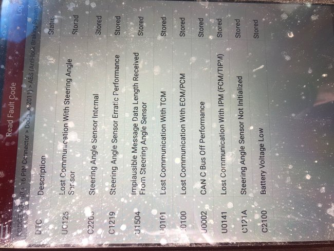

After replacing the rack and pinion and the full front suspension and before getting an alignment, and with the steering being off center now am getting what is expected which is the BAS and traction lights and SAS codes, and it shutters bad while the Bas flashes, turned off the traction control and all was good for 5 minutes no shuttering, but then it came back, is it possible for it to be related to alignment, SAS and the traction? I am sure i reinstalled the abs sensors correctly.

I went home after the alignment with the BAS ESP still on. Scanned it and there were a bunch of course. Deleted them and did a SAS calibration and all is good for now. Will monitor it. I noticed the car has hard time starting first time you try to start it, this started 4 days ago. it will turn over and not start then start second time, volts is good around 13.95 or 14.xx..

codes before.
Apr 3, 2020 at 3:53 AM
Thanks.
Make sure the battery cables are clean and tight. The low voltage code may be the root cause of all the codes.
