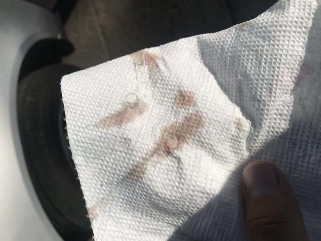

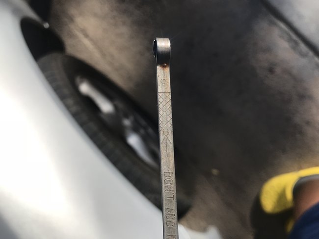

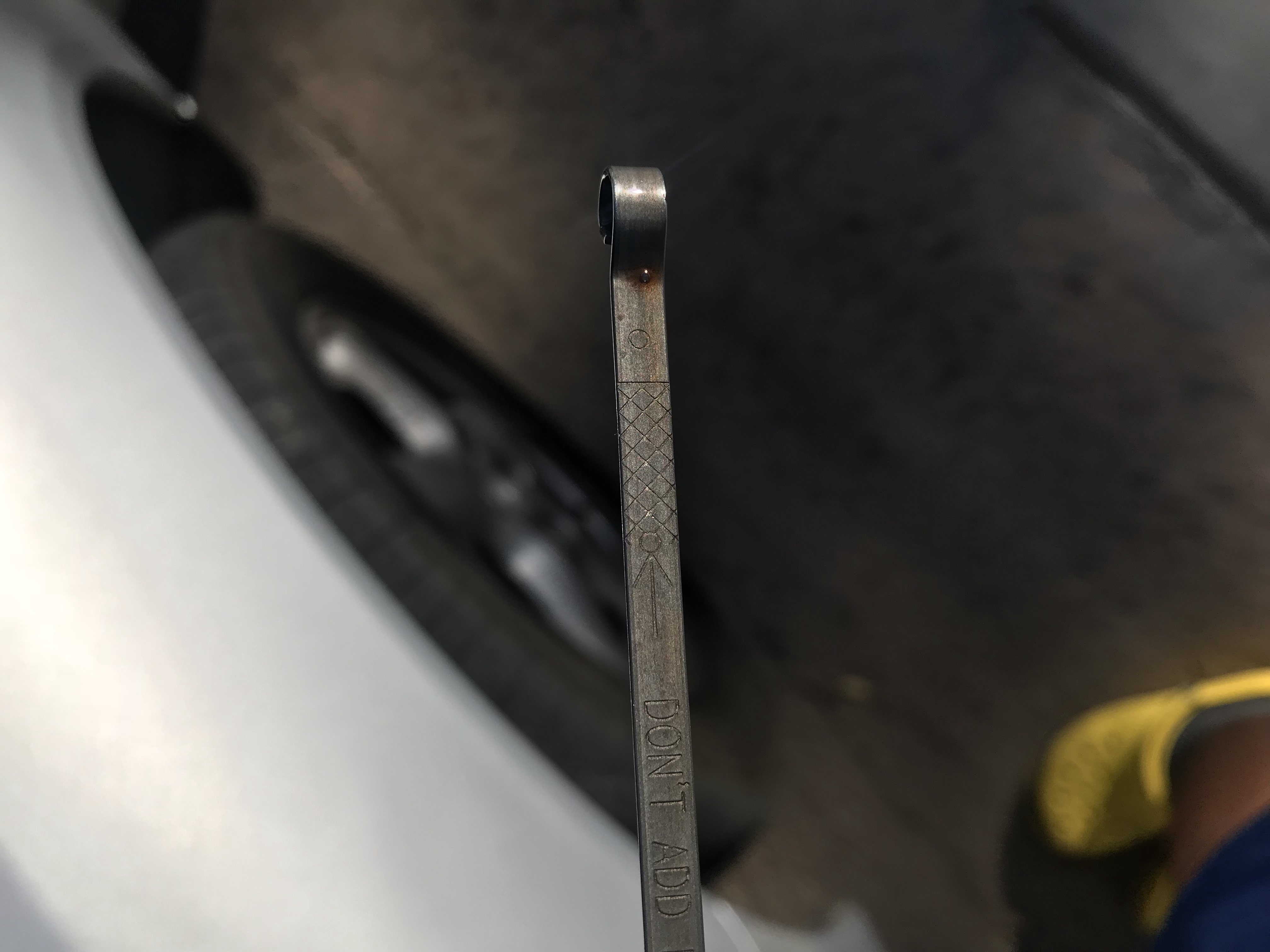

JGONZO2398
  • 372 POSTS
Here are the pictures, two of the dipstick level amount and one of the color of the fluid on a white napkin, looks pretty red to me.

DANNY L
  • 5,648 POSTS
Hello again.
Okay, I have attached your vehicles transmission fluid requirements. Be sure to change the filter. Hope this helps and let me know if you have any other questions.Thanks again for using 2CarPros.

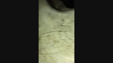

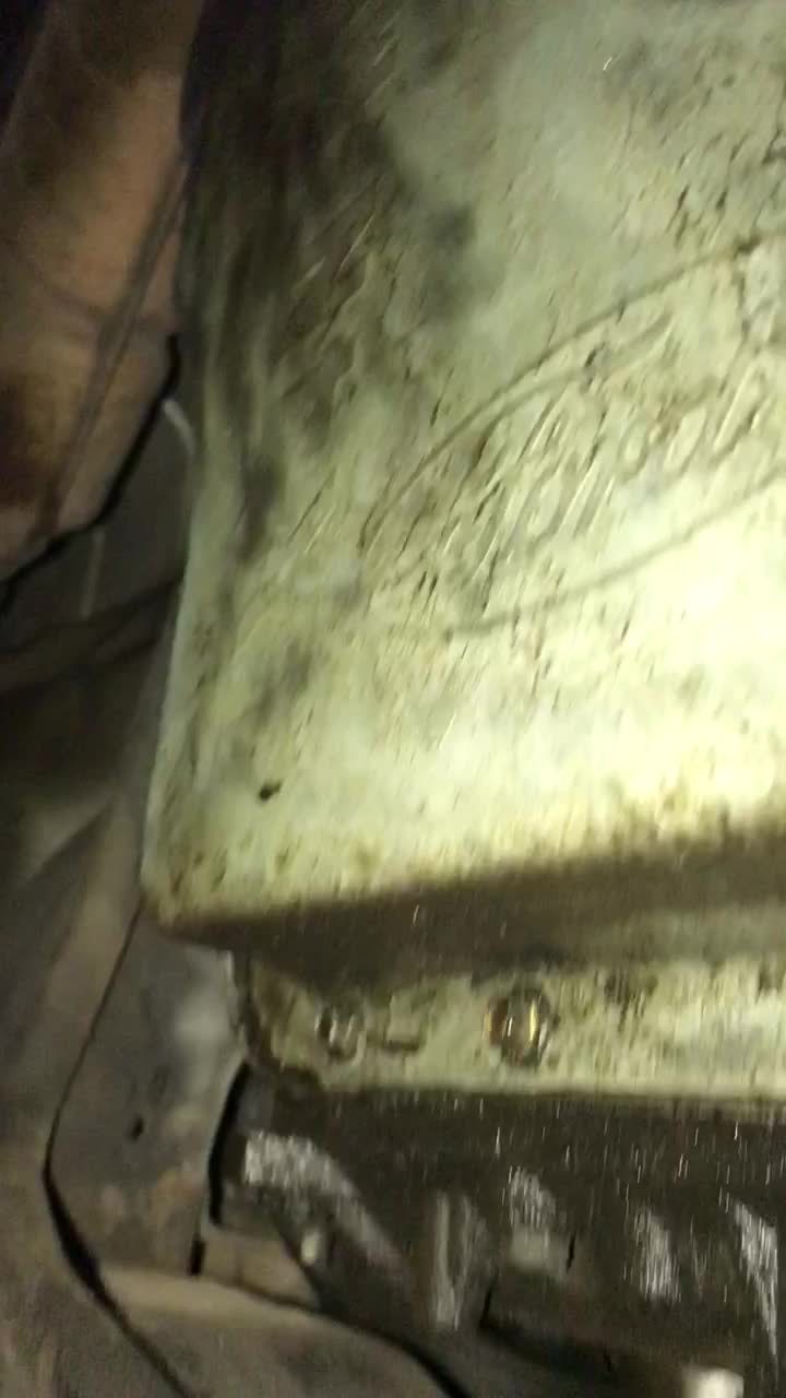

JGONZO2398
  • 372 POSTS
Here is a video around the transmission pan, there seems to be oil all over the areas surrounding the pan and some dripping on the pan itself. I have already replaced both valve cover gaskets and intake manifold gasket, also the camshaft sensor which was causing a big leak. Where is this oil coming from?

DANNY L
  • 5,648 POSTS
Hello again.
It looks to be an oil pan leak. With it leaking with the car driving it looks like the wind force is blowing it all under the bottom of the car. Before you drop the transmission pan to service you should get a can of Engine Degreaser (Gunk brand) and spray all over, let soak, and rinse with hose. Helps with engine being warm. Might help locate the leak easier with it less splattered all over the place. Yes, just replace transmission fluid and filter. Hope this helps and feel free to ask any other questions.Thanks again for using 2CarPros.
