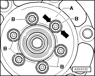

CAUTION!

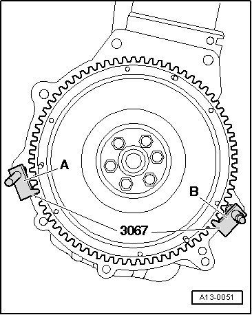

To prevent damage to dual-mass flywheel when removing, bolts - B - must not be removed using an air-powered or impact wrench. Only removing bolts by hand is permitted.
- Rotate dual-mass flywheel - A - so that bolts - B - stand centered to holes - arrows -.
picture 1
- When removing bolts - B -, make sure that bolt head does not contact dual-mass flywheel
- arrows - and thereby cause damage when turning it further.

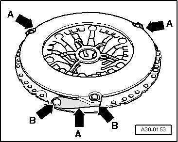

- Insert counter-holder (3067) into hole in cylinder block - B -.
picture 2
- Mark dual-mass flywheel to engine.
- Remove dual-mass flywheel.

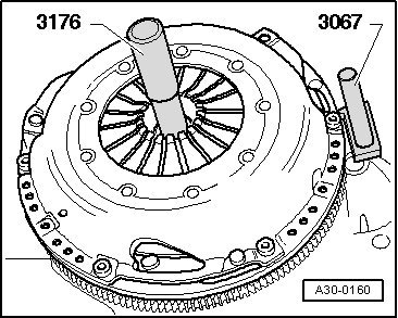

Installing
Installation is in reverse order of removal, note the following:
- Use new bolts when securing.
- Insert counter-holder (3067) into hole in cylinder block - A -.

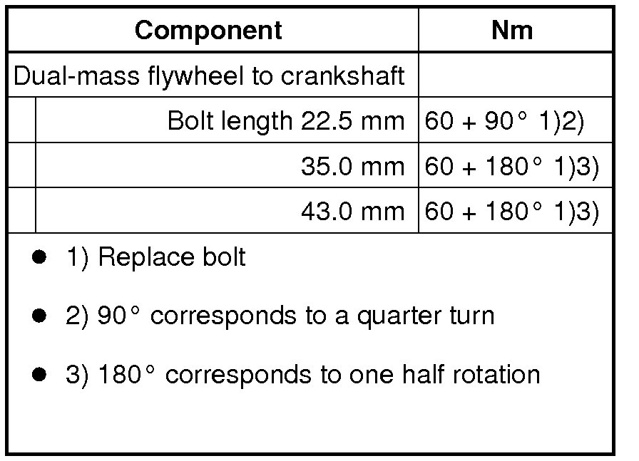

Torque specification
picture 4

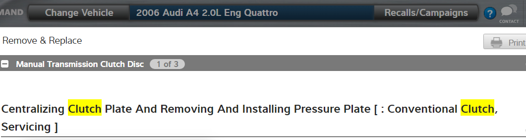

Here are the directions for clutch replacement:
CONVENTIONAL CLUTCH
Conventional Clutch
Please refer to notes, refer to => [ Clutch General Repair Information ] See: Clutch, M/T > Procedures > Clutch General Repair Information.
The transmission has to be removed before working on the clutch. Refer to => [ Transmission, Removing ] See: Manual Transmission/Transaxle > Removal and Replacement > Transmission, Removing.

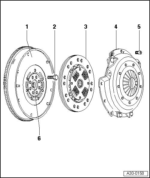

picture 5
1 Flywheel/dual mass flywheel
Make sure that dowel pins fit tightly.
Contact surface for clutch lining must be free of grooves, oil and grease.
Removing and installing, refer to => Engine Mechanical See: Engine > Mechanical > Cylinder Head, Valvetrain - Fastener Tightening Specifications
2 Bolt for flywheel
Always replace.
Bolt length: 22.5 mm; 60 Nm + an additional 90° 1/ 4 turn.
Bolt length: 43 mm; 60 Nm + an additional 180° 1/ 2 turn.
3 Clutch plate
Installation position: Clutch lining must make full contact with flywheel.
The marking "Getriebeseite" (if provided) faces pressure plate/transmission.
Coil springs (damper assembly) point toward pressure plate and transmission.
Centralize, refer to => [ Centralizing clutch plate and removing and installing pressure plate ]
Clutch plate diameter, refer to => [ Code Letters, Allocation, Transmission Ratios, Capacities ] See: Manual Transmission/Transaxle > Components > Code Letters, Allocation, Transmission Ratios, Capacities.
4 Pressure plate
Removing and installing, refer to => [ Centralizing clutch plate and removing and installing pressure plate ]
Check ends of diaphragm spring, refer to => [ Checking ends of diaphragm spring ]
Check spring connection and rivets, refer to => [ Checking spring connection and rivet ]
Check wire ring, refer to => [ Checking wire ring ]
5 Bolt, 22 Nm
Loosen and tighten gradually in several stages and in diagonal sequence.
6 Needle bearing

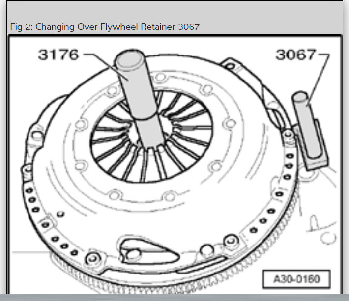

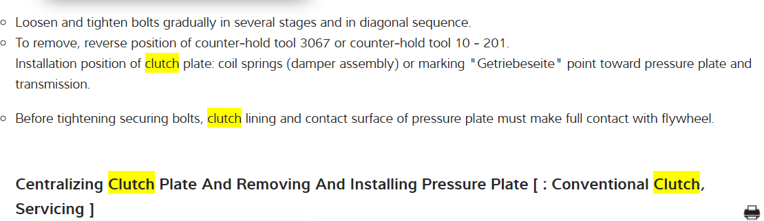

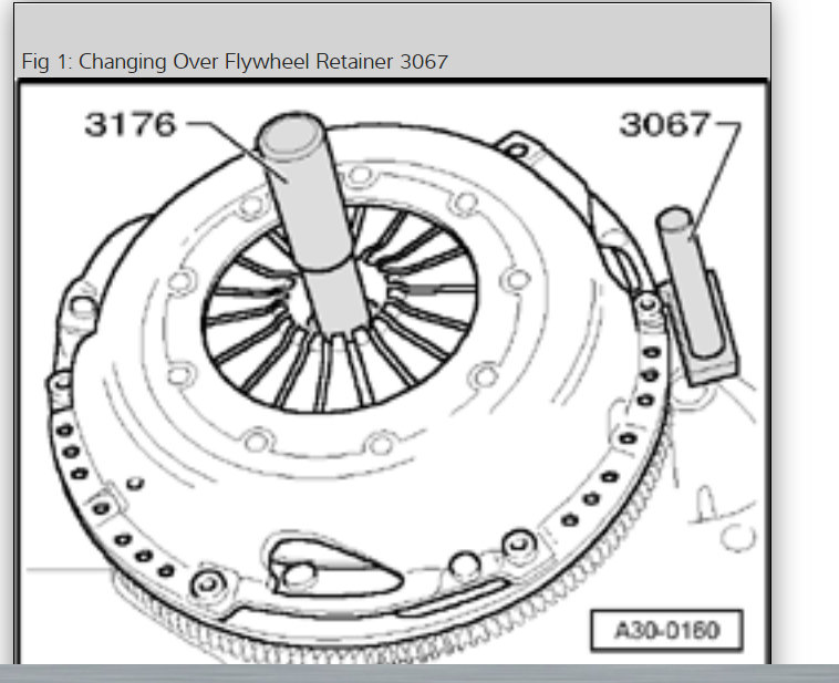

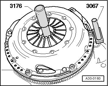

picture 6

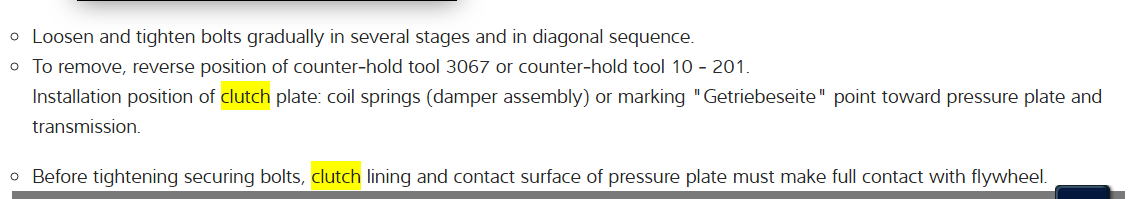

- Loosen and tighten bolts gradually in several stages and in a diagonal sequence.
- To remove, reverse position of counter hold tool (3067) or counter hold tool (10 - 201).
Installation position of clutch plate: coil springs (damper assembly) or marking "Getriebeseite" point toward pressure plate and transmission.
- Before tightening securing bolts, clutch lining and contact surface of pressure plate must make full contact with flywheel.

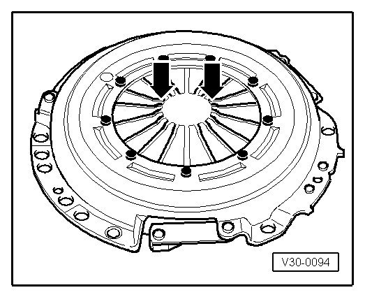

picture 7
Wear up to half the thickness of the diaphragm spring is permitted.
When performing repairs, always select the correct clutch pressure plate and clutch plate by checking engine code.

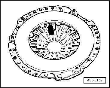

picture 8
- Check spring connections - arrows A - for damage and make sure riveted fastenings - arrows B - are seated tightly.
Replace pressure plate if spring connections are broken or badly bent, or if riveted fastenings are loose.

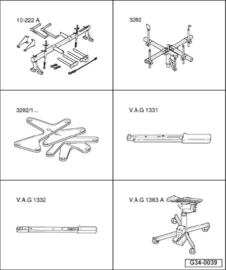

Here are the directions for removing and replacing the transmission.
Transmission, removing from vehicles with 4-cylinder engine, 01X, 6-Speed Front-wheel Drive M/T
picture 10
Special tools, testers and auxiliary items required
^ Engine support bridge 10-222 A
^ Transmission support 3282
^ Adjustment plate 3282/43
^ Torque wrench V.A.G 1331
^ Torque wrench V.A.G 1332
^ Engine/transmission jack V.A.G 1383 A
picture 11
^ Insert pad for front fender T40045
^ Grease for clutch plate splines G000100
^ Copper grease Z381351TE
Procedure

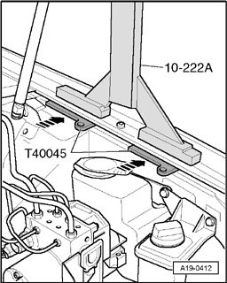

- To avoid damaging edges of fenders with engine support bridge 10-222 A, insert wing compensation plates T40045 on both sides between fender mounting flange and body panel underneath.
picture 15
- Set up engine support bridge 10-222 A with adapters 10-222/3 on fender mounting flanges.
- Engage spindles on engine lifting eyes as illustrated.
- Take up weight of engine using spindles.
