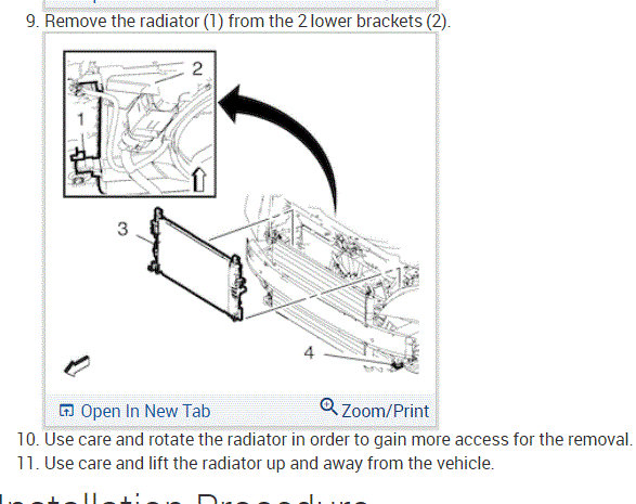

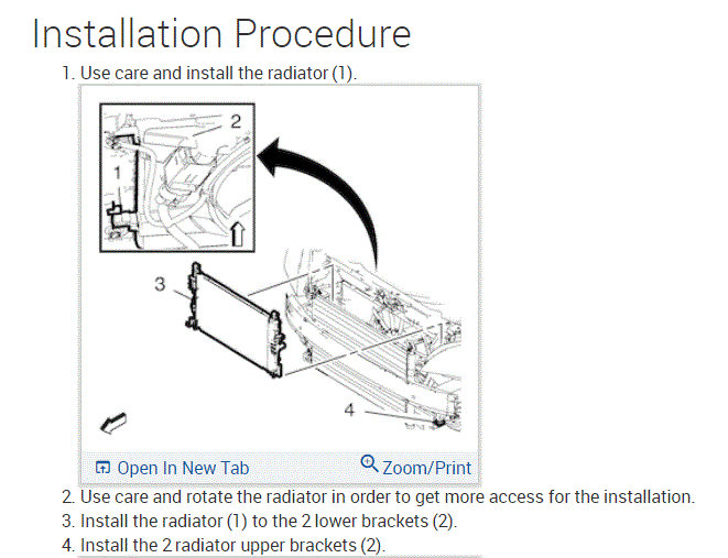

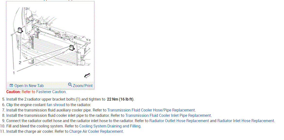

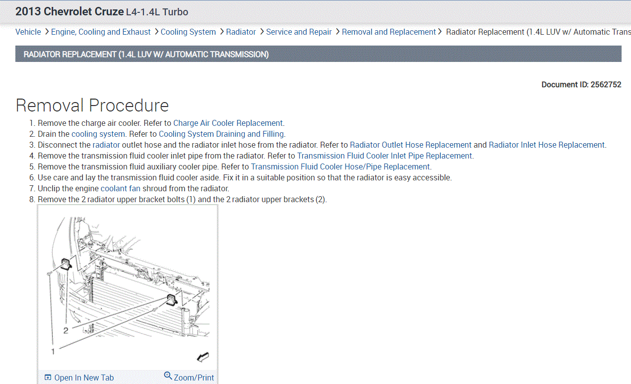

Here is a link to get you started on the radiator replacement:
https://www.2carpros.com/articles/how-to-replace-a-car-radiator
The directions attached below are specific to your vehicle.
