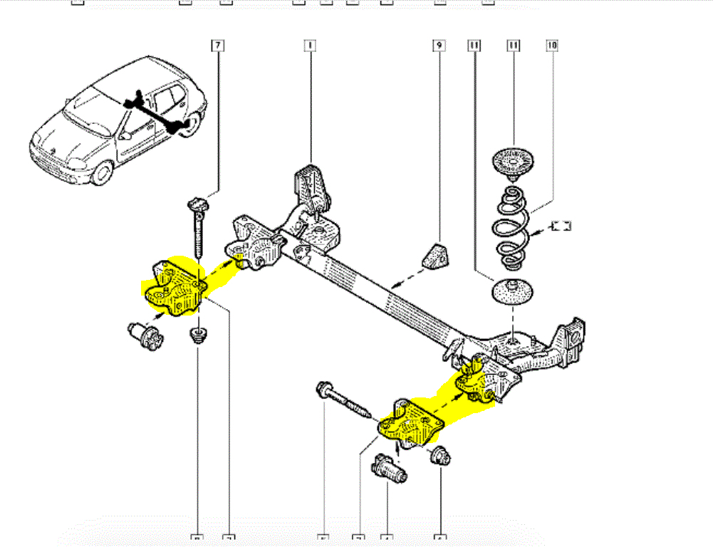

  • 110,244 POSTS
If it stops that fast, the shocks sound good. This model isn't offered in the US, but I'll try my best to help direct you.
I was able to find a pic of the rear suspension for this vehicle. I highlighted two places where I believe you will find where it is connected.
There should be rubber bushings in that area. Take the weight off one wheel at a time and using a pry bar, see if there is play in any of the components.
Let me know. Also, if you could take a pic of what you see in the rear of the vehicle and upload it for me to see, it should help me.
See pic below.

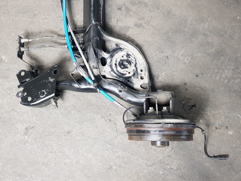

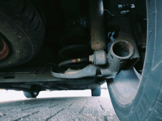

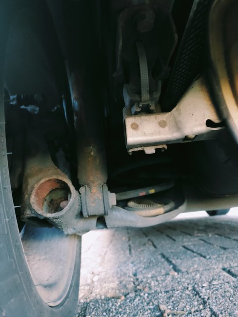

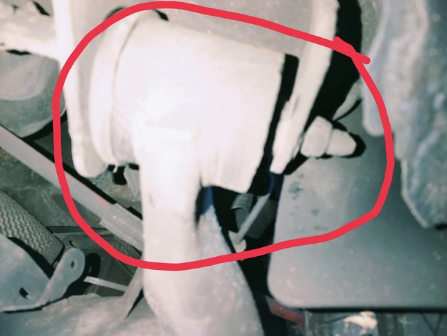

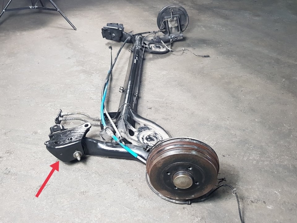

BBONDOV
  • 10 POSTS
Hi Joe!
The picture diagram you upload is similar, but the model is other, I think.
I check for the whole rear axle body of my Clio 2006 (MK3) 1.4 and I upload it here.
Also, I took some photos with my phone on my car as far I can get.
The component I highlighted with red is a view from the red arrow on the full body axle. There is a rubber absorber I believe or bearing with rubber body.

  • 110,244 POSTS
Yes, the one you circled is certainly a possibility. Check both sides with a pry bar to see if there is excessive movement.
Anywhere that axle mounts, there will be some type of bushing, so check for others.
