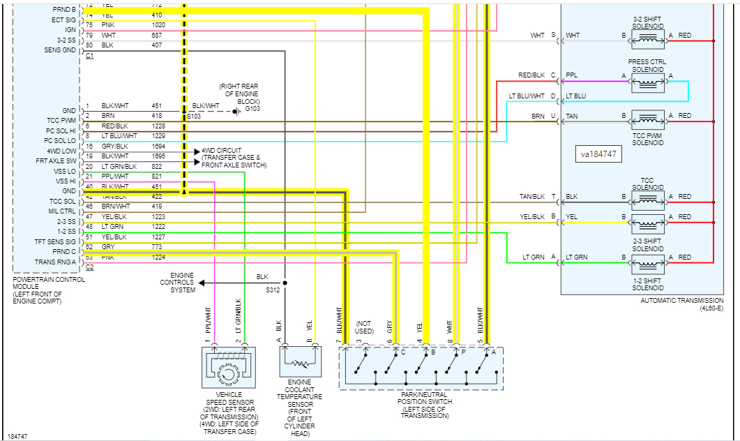

The vehicle listed above has a 4l60e. The gear shifter spring broke. I was going to go get a new one. I went to make a turn no power to go and cut off. I cranked her back up and I could shift into all gears, but she wouldn't go forward, backward nothing. Also, the indicator for the gears won't light up.

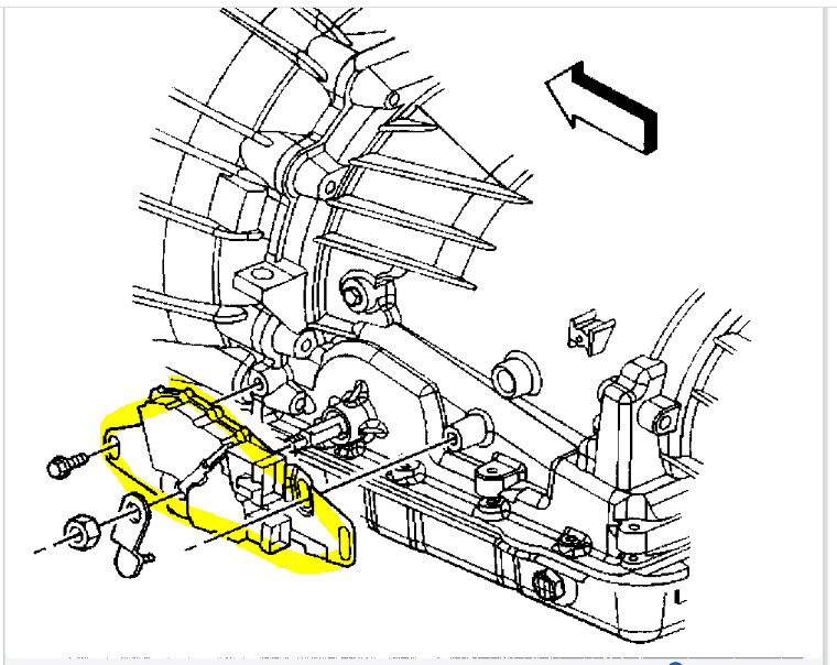

If you are not seeing any selected gear on the indicator, check to see if there is a problem at the transmission range sensor. (See pic below). Check the connector to make sure it wasn't damaged or disconnected.
Although the TRS doesn't tie into the spring issue you mentioned, the indicator lamps not working doesn't either. I'm trying to narrow things down.

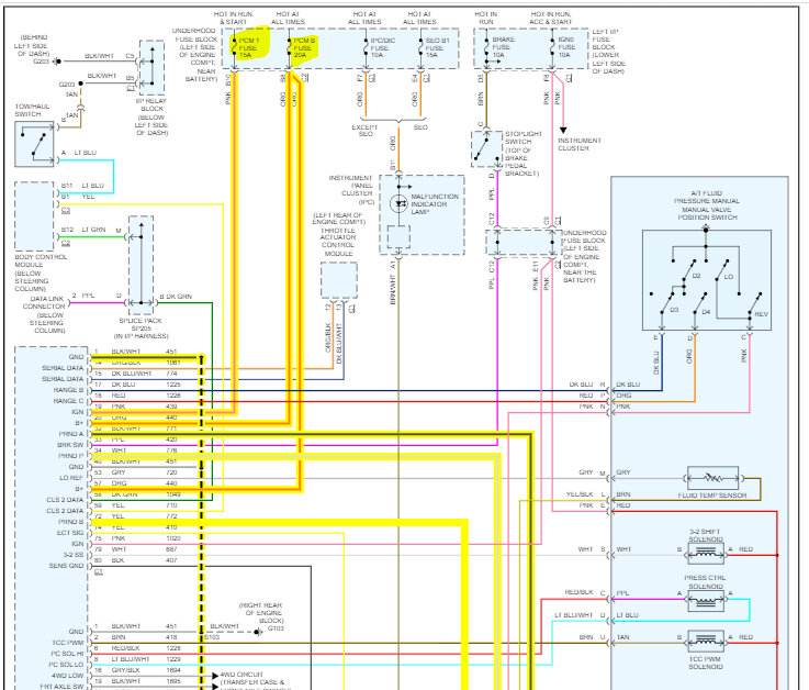

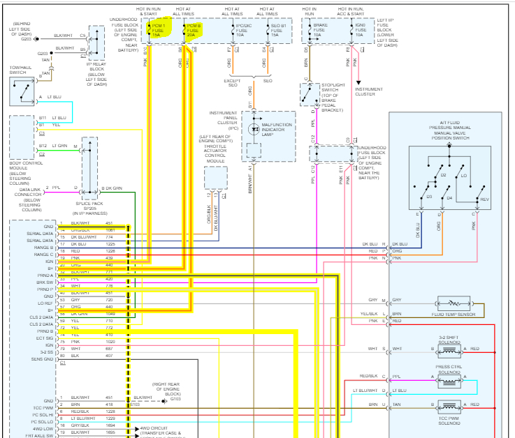

  • 110,240 POSTS

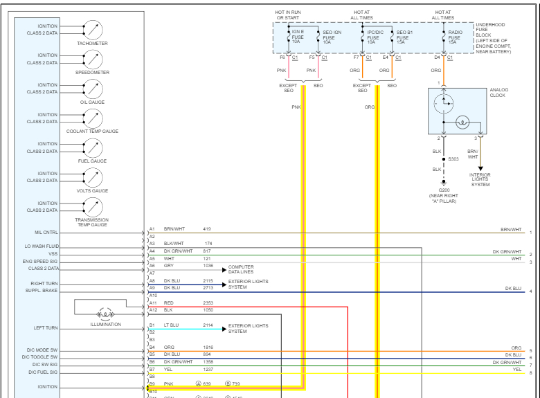

If none of the gear indicator lights are turning on, we either have a fuse/power issue with the powertrain control module or the PCM or Range Sensor has failed. None of which makes sense because you were working inside the vehicle.
I attached the wiring schematic below for the transmission circuit. I highlighted two fuses that are located in the under-hood fuse panel. Check these fuses for condition and make sure there is power to and from them.
If they are good and have power, we next need to check the connectors at the PCM (under the hood) and the range sensor on the transmission.
As I mentioned. This isn't making sense because you were working inside the vehicle, but something is preventing the gear indicator lamp from working, so in essence, the vehicle doesn't realize it's in gear. The signal for the gear indicator comes from the range sensor, so that is the next thing to check if the fuses are good.
The odd thing about this is you only have codes related to the HVAC.
Let me know what you find.

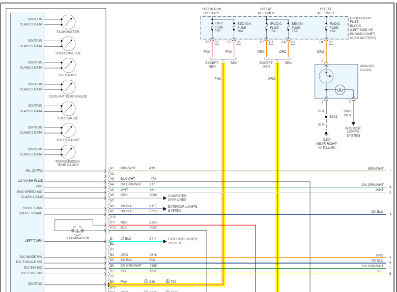

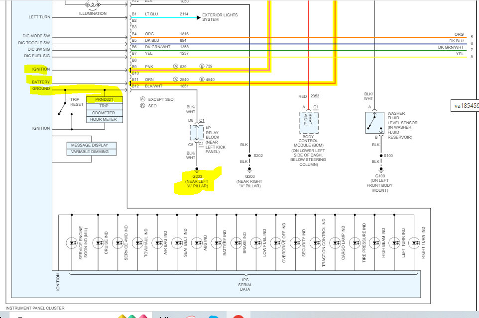

joe
See pics below. I highlighted wires of interest for you. One last thought, I found something of interest. The PRNDL indicator grounds at the left kick panel. That may be of interest. See pics 3 and 4. That is the instrument panel schematic. There should be a black wire with a white tracer (left kick panel) that is ground. Locate that wire and trace it to make sure it hasn't been damaged.

Something must have happened under the dash. Check that ground to see if something was disconnected or damaged.
