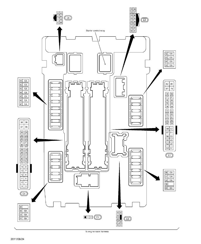

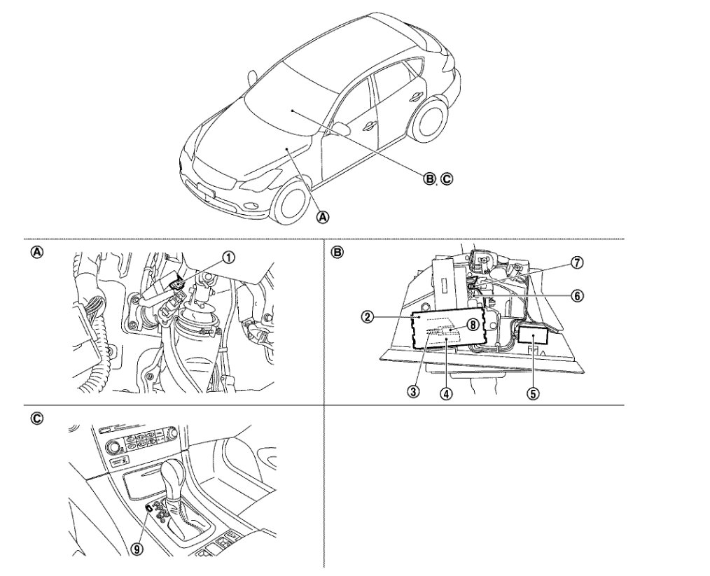

My car will start no problem. It will not go into gear it won't get out of park. I can shift through the gears freely. But it won't get out of park.
Apr 25, 2023 at 3:47 PM
  • 55,394 POSTS

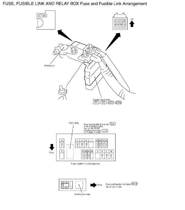

It sounds like the shift lock is not working but we should check the fuses first.
Here is a guide to show you how and you should check the fuses with the system on:
I have seen the IPDM go out and cause this problem as well, if the fuses are okay let's run a

Here is how the shift lock works, also there is a shift lock bypass near the shifter have you tried using that? Here is the location as well #9. Check out the images (below). Please let us know what you find. We are interested to see what it is.
