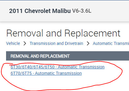

If the car has been sitting for several hours, it will shift fine in manual mode. After driving for a few minutes, it will not shift past 3rd gear. The fluid has been changed and that helped for about a day. How do I know which sensor to try first? I don't have the money to do a lot of hit and miss repairs. Is the pressure control sensor the most likely problem? Any help would be appreciated. Thanks.

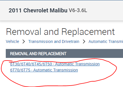

Also, there are a few different transmissions that were used on your vehicle. See pic below. If you know which one it is, let me know. If not, could you provide the VIN number so I can try to determine the one used.
See pic below.
