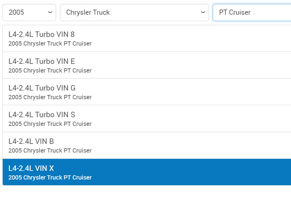

Do me a favor. If you count eight digits on your vin from the left, that will tell me exactly what engine you have. Do that and let me know what it is. That way, I can be sure I'm providing accurate info. If you look at the attached picture, you will see what I am dealing with.
