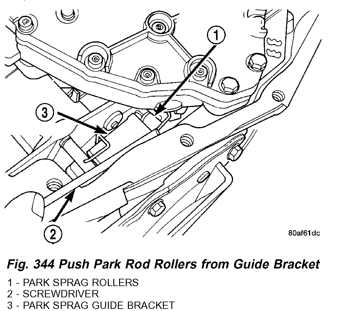

It doesn't have to do with a shift solenoid. What determines the indicator's selection is called a transmission range sensor. It is located in the transmission. Chances are it is going bad.

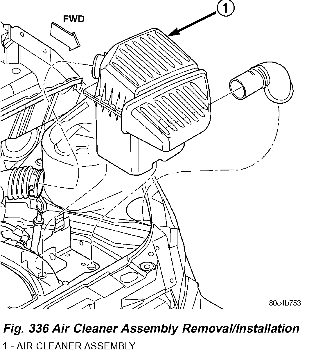

2. Remove air cleaner assembly (Fig. 336).
pic 2

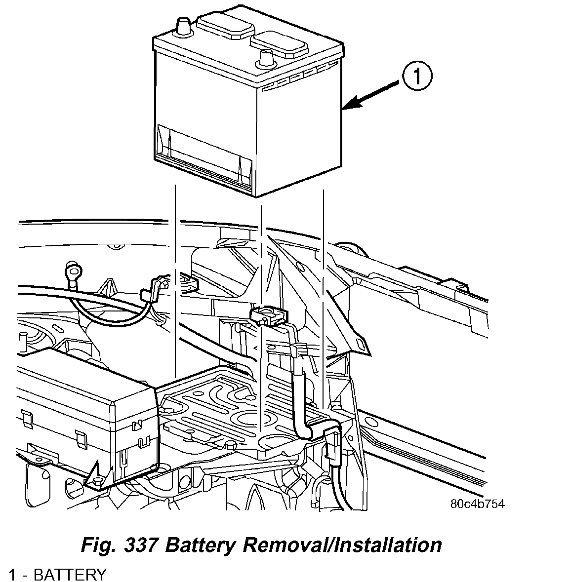

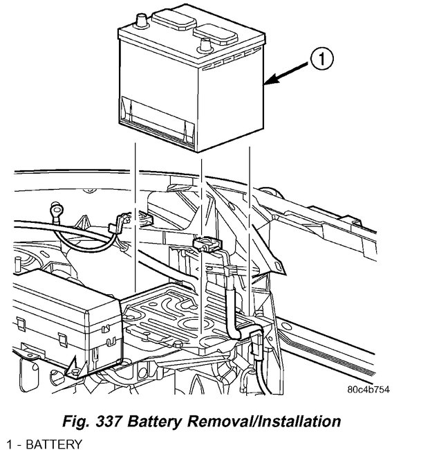

3. Remove the battery hold down clamp and remove the battery (Fig. 337).
pic 3

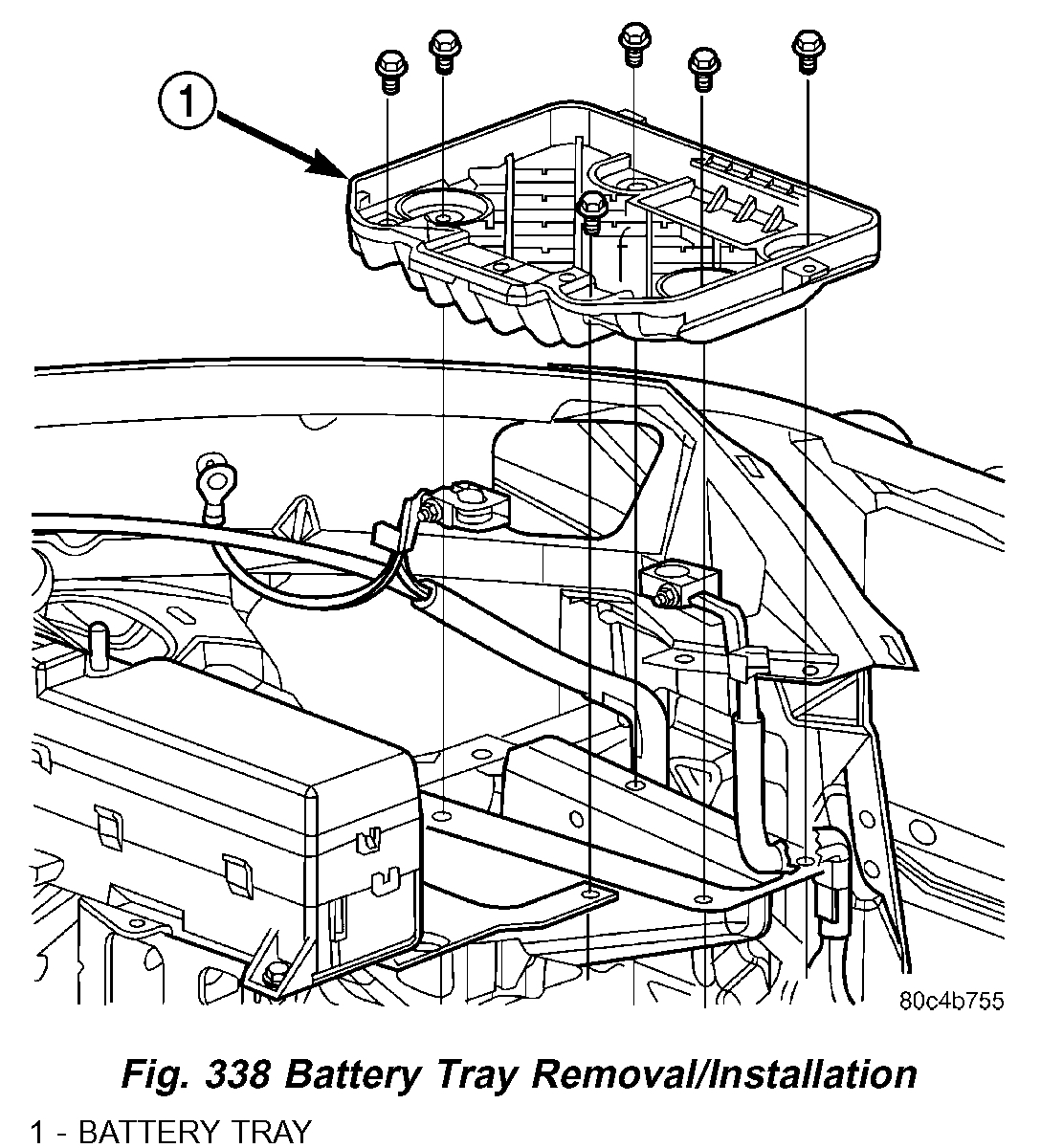

4. Remove the battery tray (Fig. 338).

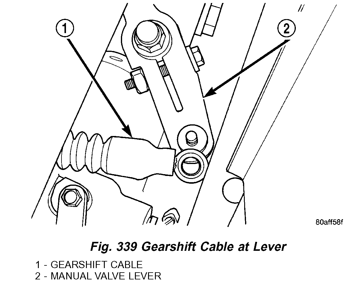

5. Disconnect gearshift cable from manual valve lever (Fig. 339).
6. Remove manual valve lever.

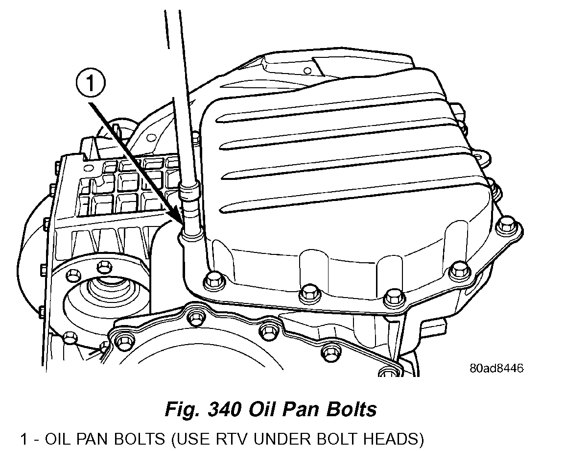

9. Remove oil pan bolts (Fig. 340).
pic 6

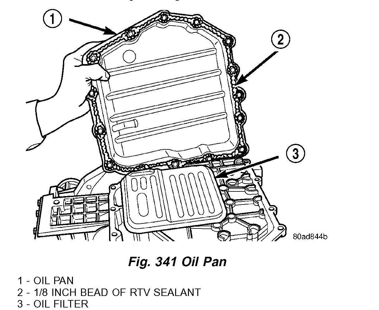

10. Remove oil pan (Fig. 341).
pic 7

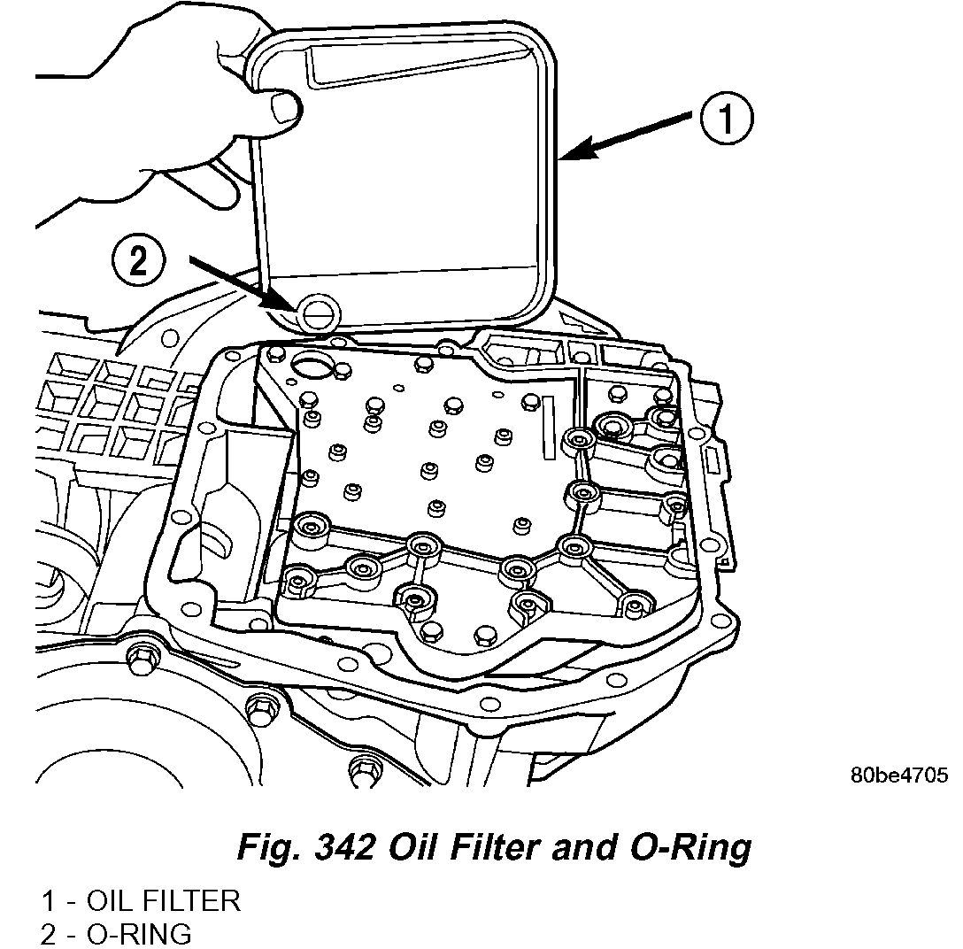

11. Remove oil filter (Fig. 342).
pic 8

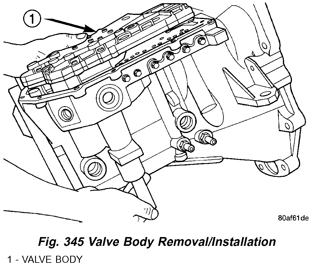

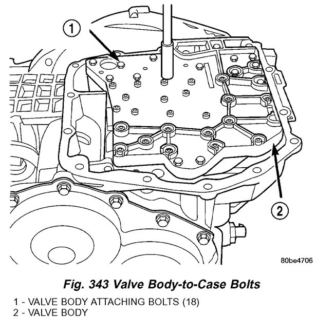

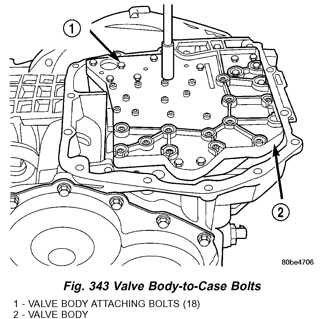

12. Remove the valve body-to-transaxle case bolts (Fig. 343).
NOTE: To ease removal of the valve body, turn the manual valve lever fully clockwise to low or first gear.
pic 9
pic 10
13. Remove park rod rollers from guide bracket and remove valve body from transaxle (Fig. 344) (Fig. 345).
CAUTION: The valve body manual shaft pilot may distort and bind the manual valve if the valve body is mishandled or dropped.
pic 11

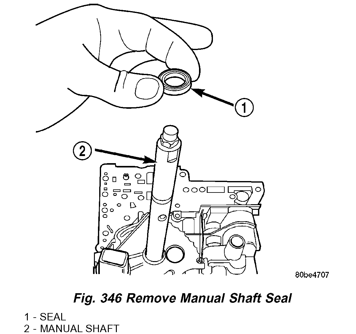

14. Remove manual shaft seal (Fig. 346).

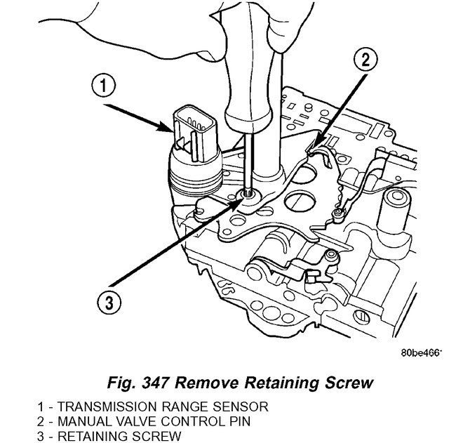

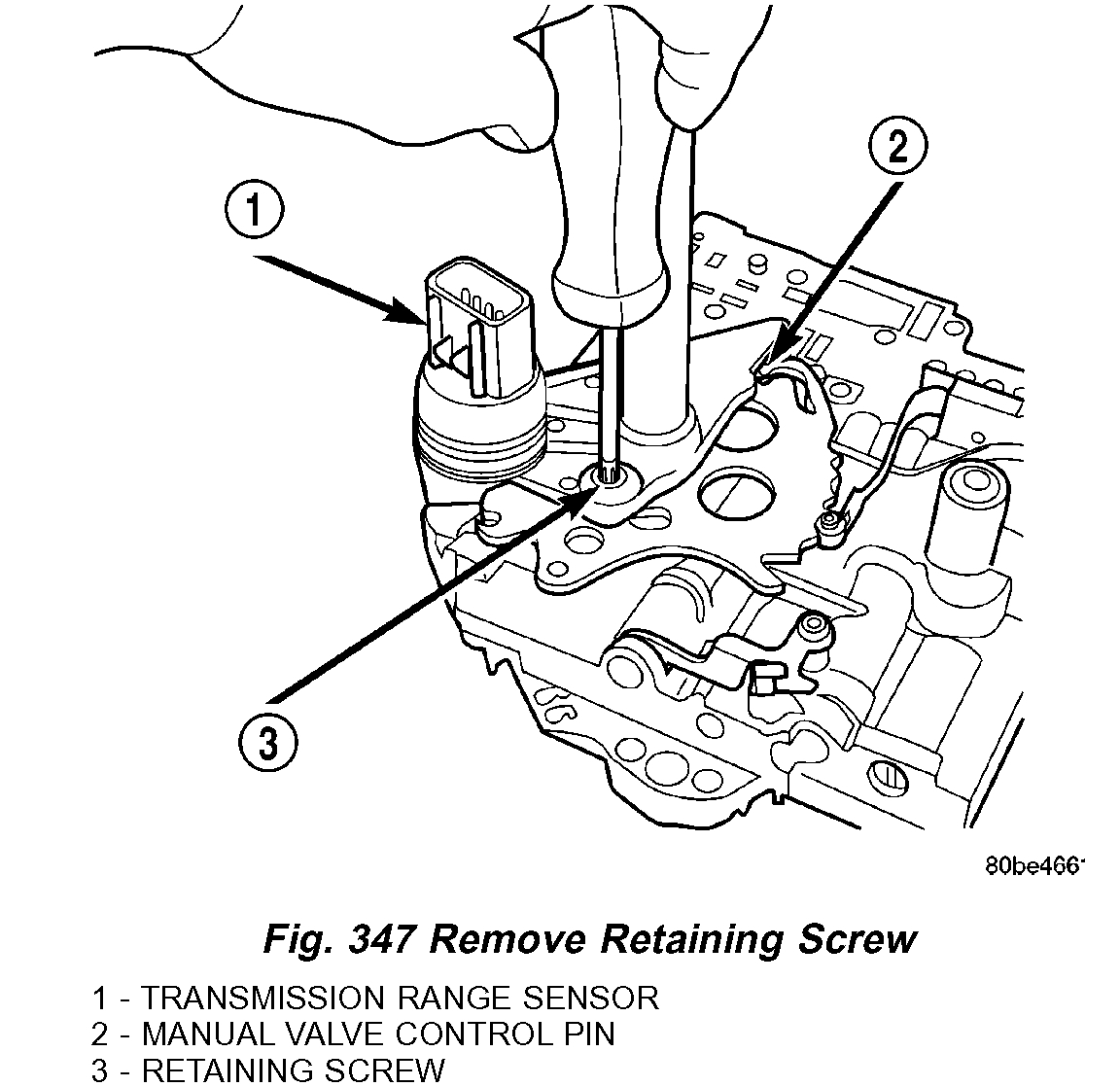

15. Remove TRS retaining screw (Fig. 347).
pic 13

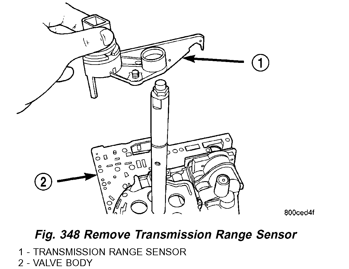

16. Slide Transmission Range Sensor up the manual shaft and remove (Fig. 348).

2. Tighten retaining screw (Fig. 347) to 5 Nm (45 inch lbs.).
3. Install manual shaft seal (Fig. 346).

6. Install the oil filter (Fig. 342). Inspect the O-ring for damage and replace as necessary.
