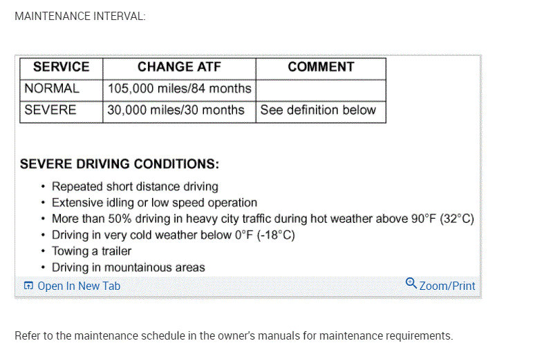

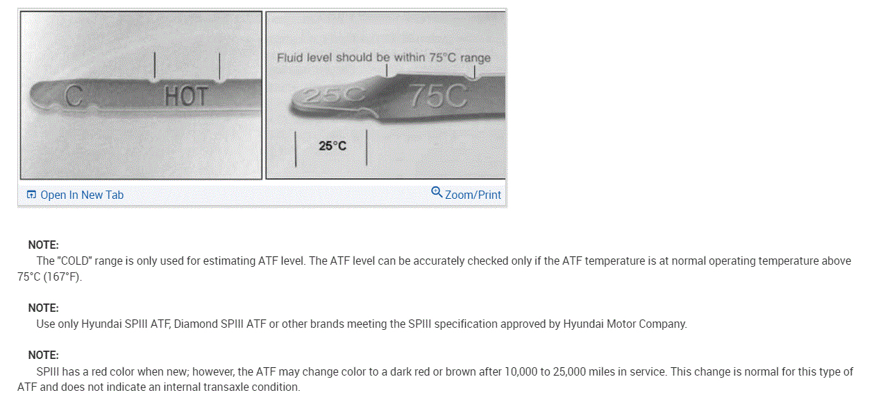

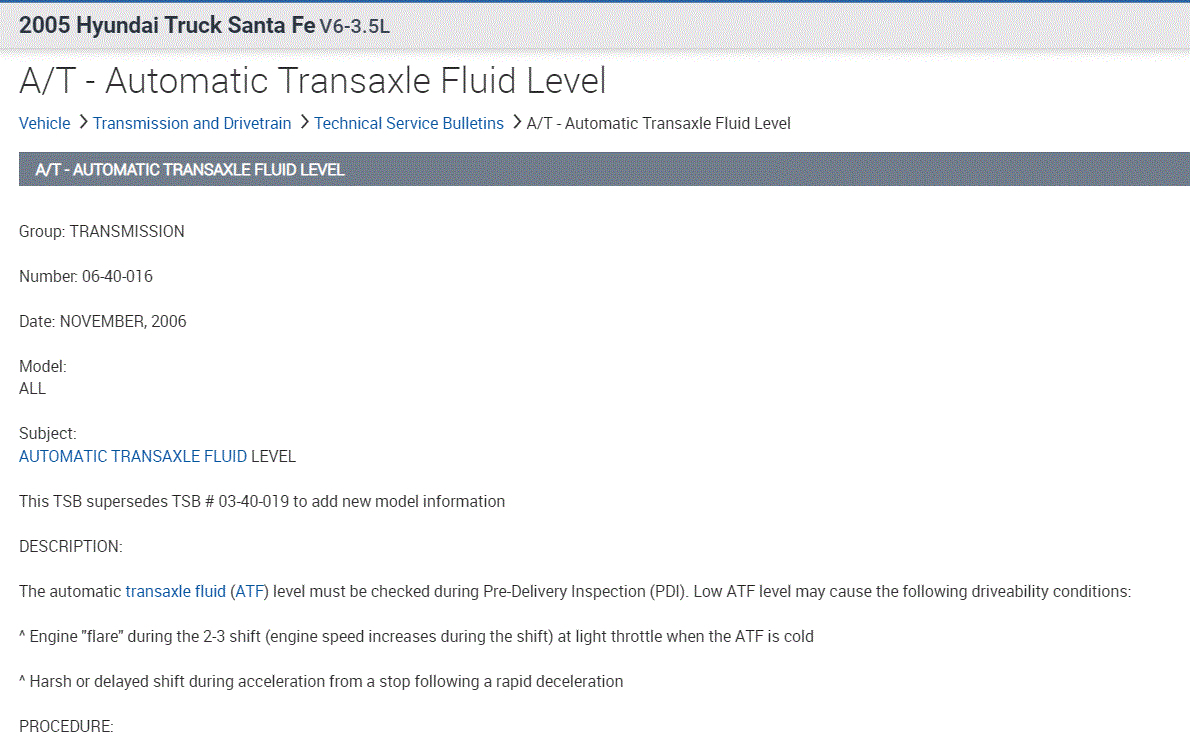

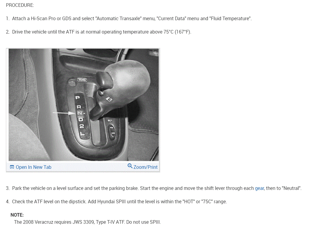

First, is the transmission fluid clean and full? If you haven't checked, follow the directions below and let me know the results. (See pics 1-4)
