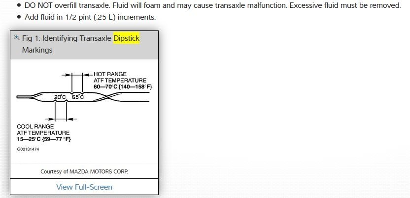

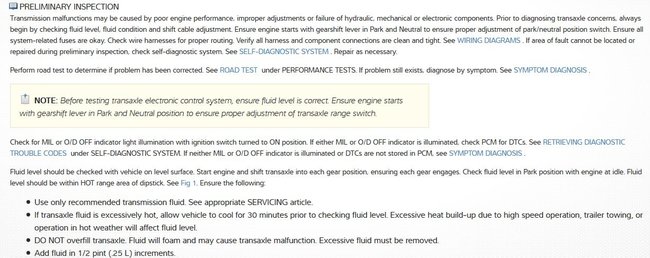

Has problem with the car shifting out of first gear.
Apr 3, 2018 at 2:12 PM
HARRY P
  • 2,292 POSTS
Can you be more specific about what it is doing?
Personally, I would bet that the transmission is slipping and needs to be rebuilt or replaced. I am attaching Prodemand's information concerning checking the transmission fluid. Go ahead and do that. Maybe we will get lucky and the fluid level will be a little low.
