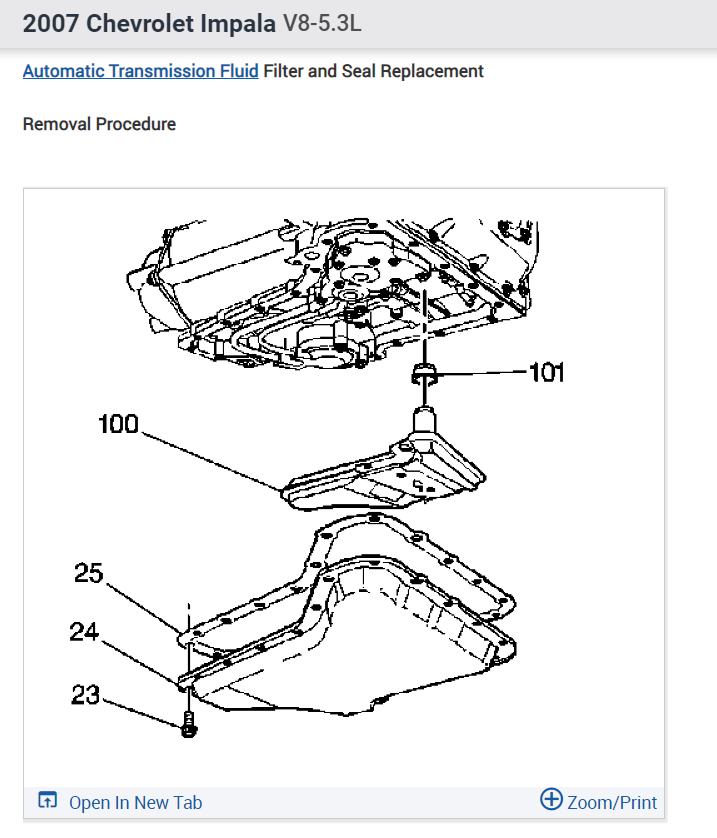

The first thing I would do is check the transmission fluid level. I think the security issue and the revving up and not moving issue is separate from this issue.
Here is a guide to help you check the fluid level:
https://www.2carpros.com/articles/how-to-check-and-add-transmission-fluid
AUTOMATIC TRANSAXLE FLUID
DEXRON-VI Automatic Transmission Fluid.

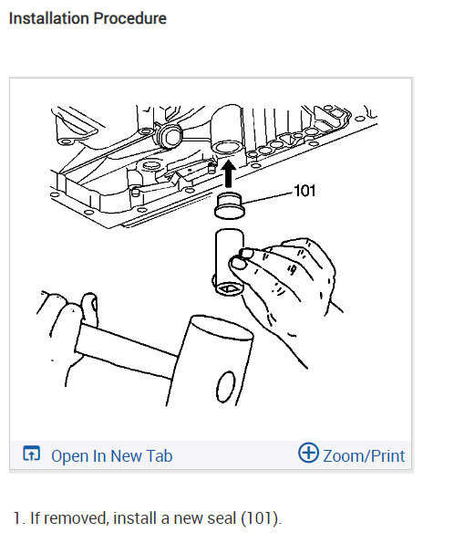

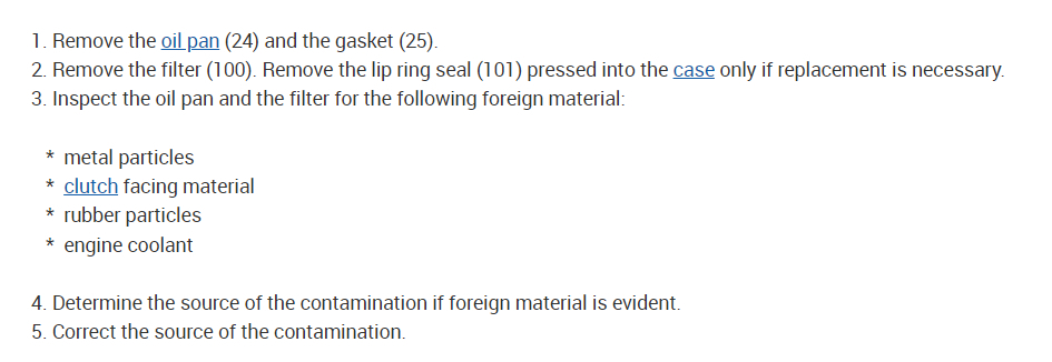

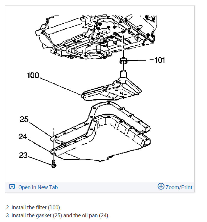

You could have a clogged transmission filter which can cause the same issue. Here is a guide to help you with the service with images below to show you how on your car.
Check out the images (below). Please upload pictures or videos in your response to the problem so we can see what's going on.

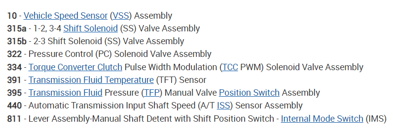

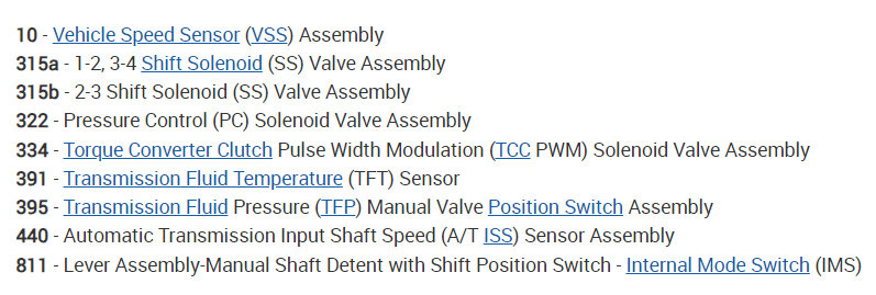

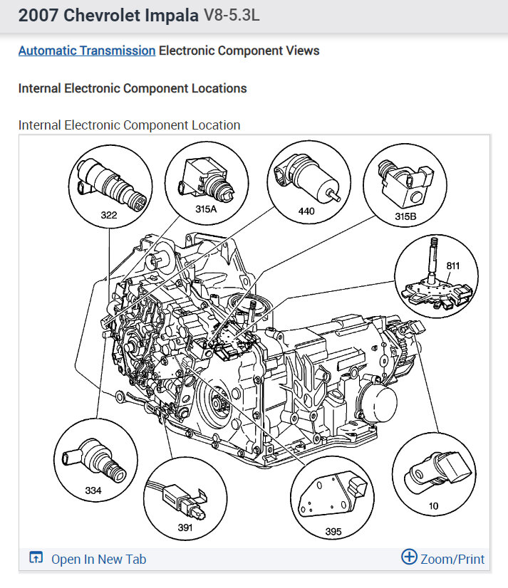

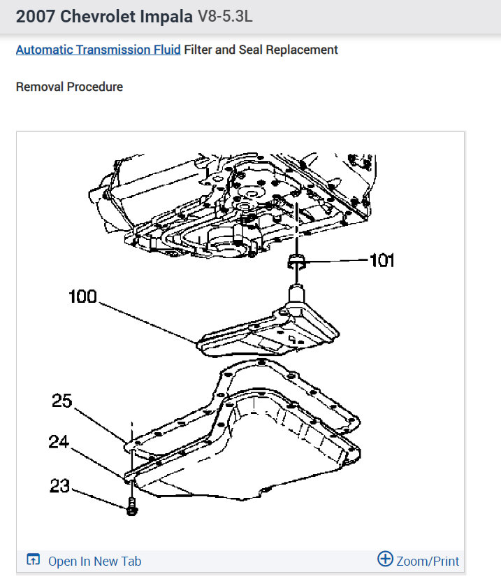

Yes, it could be the transmission, but if the internal mode switch is not working it will tell the PCM it is not in gear, can you have someone check the reverse lights to see if they are working? If not here is the location of the switch. Check out the images (below). Let us know how it goes.

Yes, reverse lights are on and working, now I also just put my car code reader thing in and I’ve done this each time I’m out here messing with it and there haven’t been any codes on it and today I’m getting a P0722 code twice.

The P0722 code in a 2007 Chevrolet Impala is a diagnostic trouble code (DTC) related to the transmission. Specifically, this code indicates an issue with the "Output Speed Sensor Circuit No Signal."
So this is says the sensor is not getting a signal which the first thing to do is replace the sensor to see what happens which is # 10 in the images above. Clear the codes once complete.
