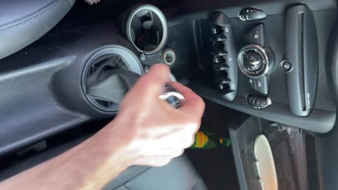

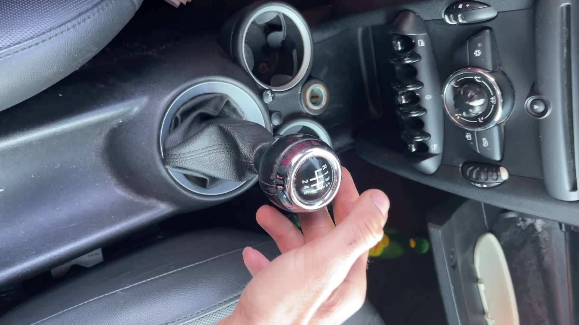

2012 MINI COOPER
96,000 MILES • 4 CYL • 2WD • MANUAL
BHAMDOC1973
  • 2,007 POSTS

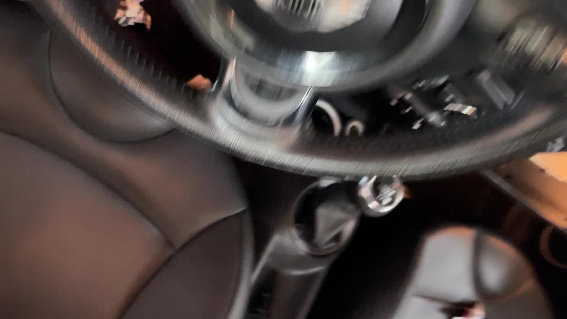

I bought this as a no runner. Very strange, starts fine, no gear engages. You put it in all gears and it goes in smooth and as it should. I had many minis, so the shifter is not loose. When you look under the hood the shifting cables move as they should, but every position you put it in acts as neutral including reverse. This has a 6-speed manual transmission.

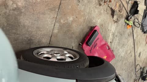

BHAMDOC1973
  • 2,007 POSTS
I got it inside the garage and jacked up both wheels. Nothing looks bad or loose down there. Axles in great shape with no play, no leaks, cables look tight. I can still put it in all gears without depressing the clutch. But when i did put it in 1st gear and revved it hard the wheel was starting to move, just barely, in reverse a hard rev and the wheel was moving fast. Not sure what this means or if it gives u any ideas. The next thing would be to remove the starter.
Feb 28, 2024 at 2:35 AM

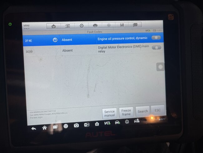

BHAMDOC1973
  • 2,007 POSTS
Had these codes. But the battery is super weak so not sure if they are right.
Feb 28, 2024 at 2:36 AM

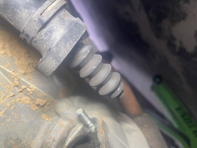

BHAMDOC1973
  • 2,007 POSTS
The slave is not stuck. I went ahead and opened the bleeder before starting it to see what I got and what I got is a few drips. I did not pump the clutch pedal before doing so just wanted to see if anything would come out. Also, these are hydraulic, I don't see a fork unless it's on the inside. I want to see if pushing the pedal pushes the area with the boot, if not then it is not functioning, I assume. but what puzzles me is that the gears all go smooth, like you said it may be that the throw out bearing is stuck in and hence why wheels don't move and am not getting any gears engaged.
Feb 28, 2024 at 6:41 AM

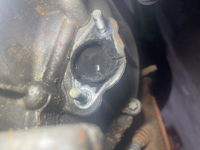

BHAMDOC1973
  • 2,007 POSTS
Oh, wait, these don't even have a boot. It's on the inside. So, i removed the slave and pushed the pin and it moves fine bit what i noticed a bunch of stuff that looks like hair, not sure if this indicates a burned clutch.
Feb 28, 2024 at 6:46 AM
STEVE W.
  • 15,345 POSTS
Fork is inside the bellhousing, which is what the slave is pressing on. That is clutch material. Looks like it ate the clutch with all of that material on the inside of the bellhousing. Probably was slipping and they overheated it and the binding agents got fried and the lining shredded. I've seen that on race cars and on cars driven by people who have no business driving a stick. Think that one is about a 12 hour job to change. The automatic is about 10. They don't even show removal in the info I have, should be like the automatic but not sure if it has room to move the trans far enough to get the input shaft out or if you have to drop the entire thing out. I try to stay away from anything Euro if possible.
