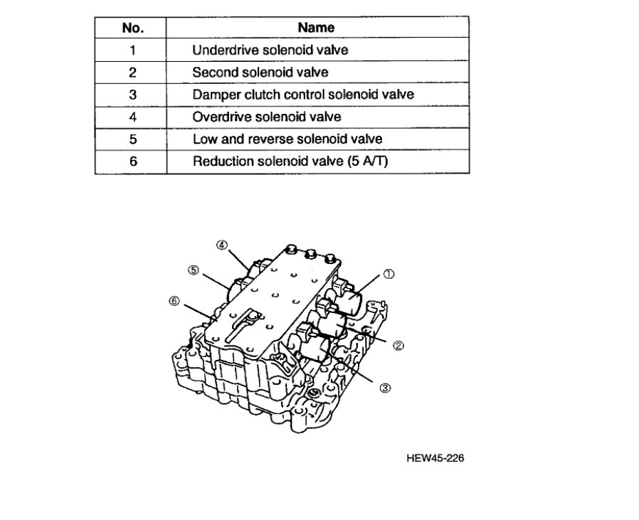

Which solenoid controls the transmission drive gear?
2002 KIA SEDONA
115,000 MILES • 3.5L • V6 • 2WD • AUTOMATIC
FERAVELLA

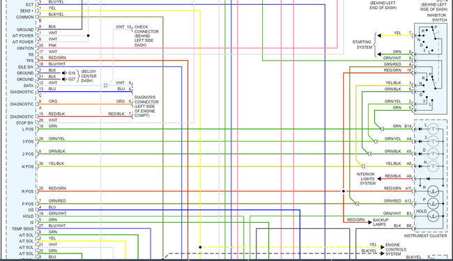

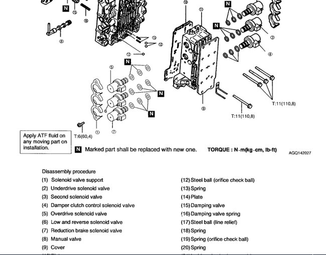

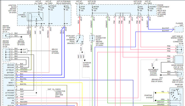

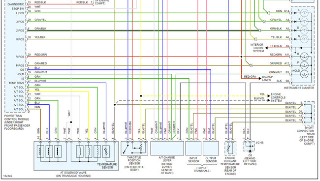

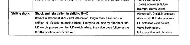

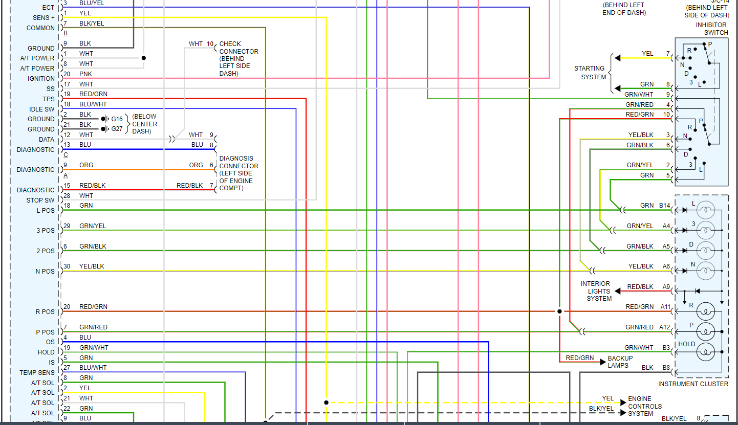

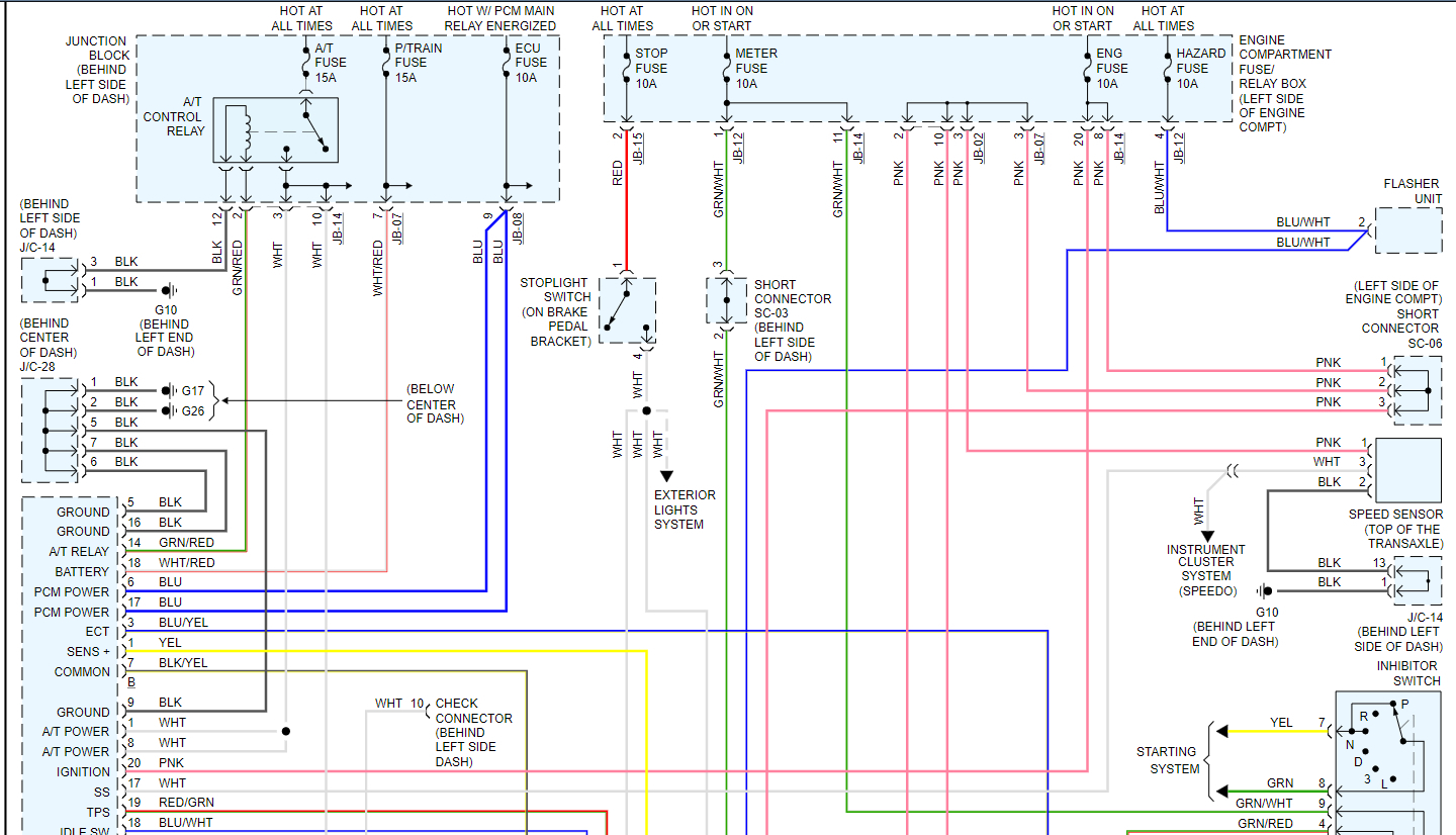

When I shift to drive it jerks loud and scary. shift to reverse is okay. Which solenoid controls the Drive? My car has 6 shift solenoids, or so it appears, but I need to know which solenoid controls the drive, reverse is okay.
Dec 4, 2020 at 6:14 AM
Good morning,

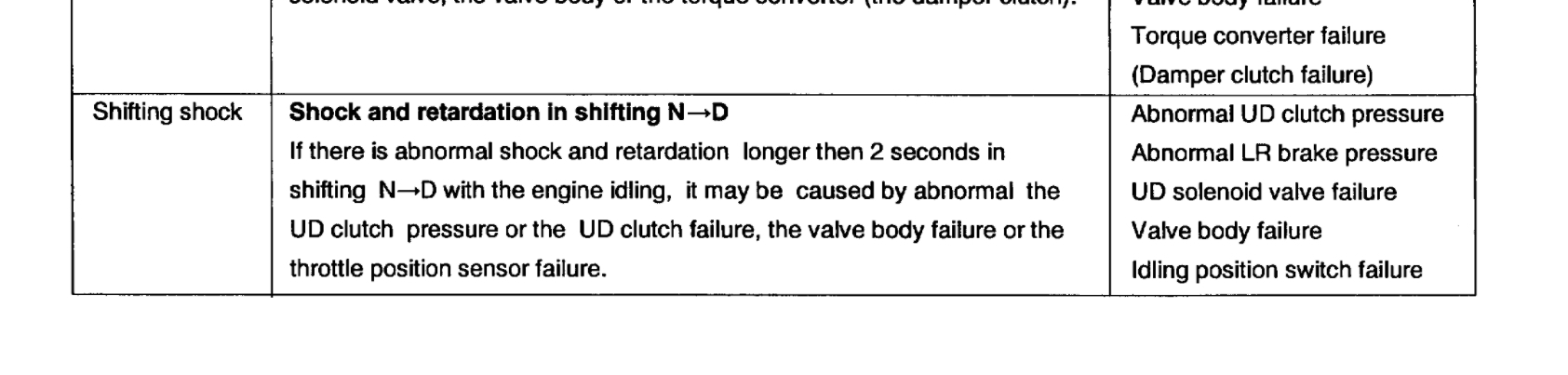

I found and posted below the possible issue with shifting shock, as they call it, for your transmission. It is not the shift solenoid, it is a internal clutch issue with the transmission.
If it were a shift solenoid, it would code and set the check engine light.
Most likely you will need to have the transmission removed and inspected for the underdrive clutch pack.
