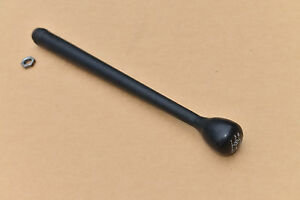

Okay, i would like to unscrew my stock shifter stick on my NV3500 and screw on something that i can change out the knobs. Not sure where to start to find one, Google isn't really helping. if someone can point me in a direction, that would be fantastic. Thank you.

Unfortunately there's not much in the way of what you're looking for for this model. What I would suggest is having a machine shop cut off the head and turn down and thread the end for you. It should run an hour or less of labor. It would be helpful to find the knob you want so they can match the threads.
