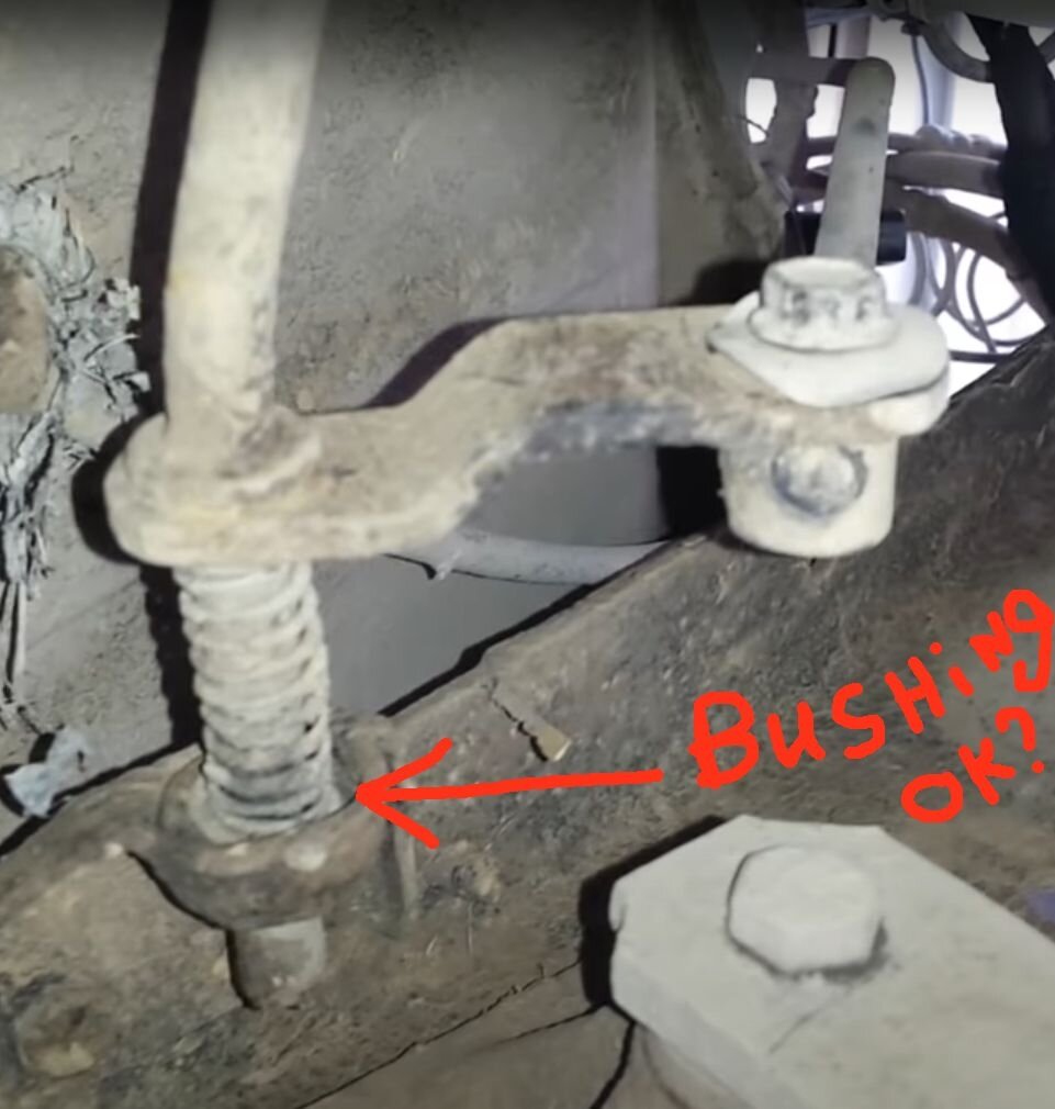

I had a problem with the shift selector moving hard and would not go into park. The mechanic installed a new Shift Lever Return Spring. There was no spring installed in the column when he took it apart. The van will shift smoothly in all gears except it still will not shift into park, unless a flat head screwdriver is pushed into the linkage. The mechanic is at a loss of what to do and will not finish the state inspection.

If the bushing on the Zbar under the van is okay (that is the bar that goes from the transmission to the frame in the image) The next step would be to verify that the issue isn't inside the transmission, The easy way to do that is to disconnect the rod that goes between the Z bar and the shift lever. Now with the wheels blocked, does the transmission freely shift through the gears and into park? If yes, then it's likely that the linkage needs to be adjusted due to wear. For that you go under the van. Loosen the lock bolt that holds the shift rod in the end pivot. (in the image it is the bolt that is above the text) That gets backed off. Then you put the transmission into park all the way. Then go inside and be sure that the shift lever is fully locked into the park position. Then go back underneath and tighten the bolt back down. Test it and be sure you can shift it OK. GM used the same design on a lot of vehicles.

Thank you for your quick response. I asked the Dan if the bushing was okay, and he said it was. So, I will show him your response and have him do as you have put in your response, and I will get back to you too after he has done that. Thank you very much.

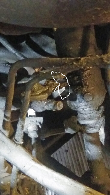

I will let you know. I added a picture of where I need to place the screwdriver at the shift lever. The area in the white circle. The shifter will not move it to this point.

If you have someone watch it, does it move at the same time as you move the lever? That is welded to a tube that is inside the column, there is normally a plastic bushing around the tube to keep it centered, if that failed the lever you drew the circle on will not just rotate, it could be loose in the tube and not moving the linkage.

I will see if I can get someone to shift it for me and watch it. I wanted to do that but I have not been able to. It is hard to see inside the tube now as you can see by the picture, because he lubricated it to see if it would make it move. Before he did that I saw that the lever was connected to the tube, but I do not remember seeing any plastic bushing. I will need to try and clean that and take a look. If that was missing, would it still allow it to shift through all the gears and just not park?
The mechanic was trying to figure out how it works inside the tube. He ordered a new tube to replace this one, but all he got was an empty tube.
The shift selector does not seem to want to move as it used to. I pull back on it and it does not want to move, which is why he thought it was the shift lever return spring. Since that was never installed from the manufacturer, how did it shift for 42 years?

It sort of sounds like the shift comb might be the issue but to get to it you need to strip the column apart. The column is basically tubes installed inside each other. The steering shaft is in the middle. Then the shift tube is around that, it supports the steering shaft with bearings. Then there is the outer column tube, it uses a series of bearings and bushings to support the other 2 tubes. There are holes in the outer tube that allow the neutral start switch to mount and the lower shift lever to come through.
