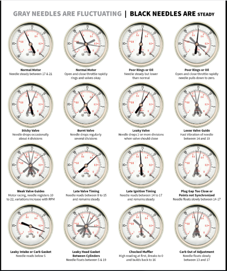

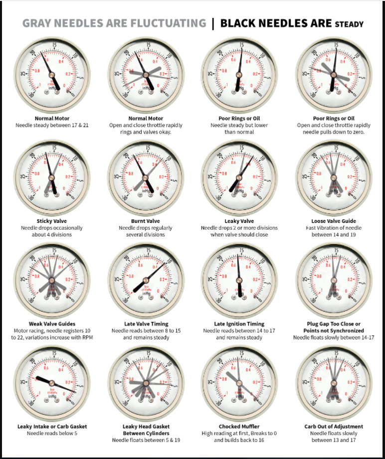

Or if you want to use a vacuum gauge hooked up to a vacuum line. I attached a diagram below on what the readings mean. If you are not sure, get a video of the gauge while it it running poorly and we can figure it out.
If you find no vacuum leak we may need to check this with a gauge anyway because you may have a sticking intake valve.
