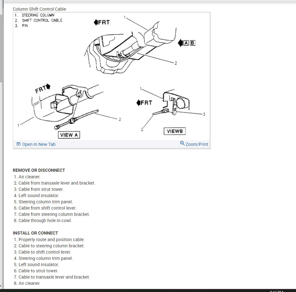

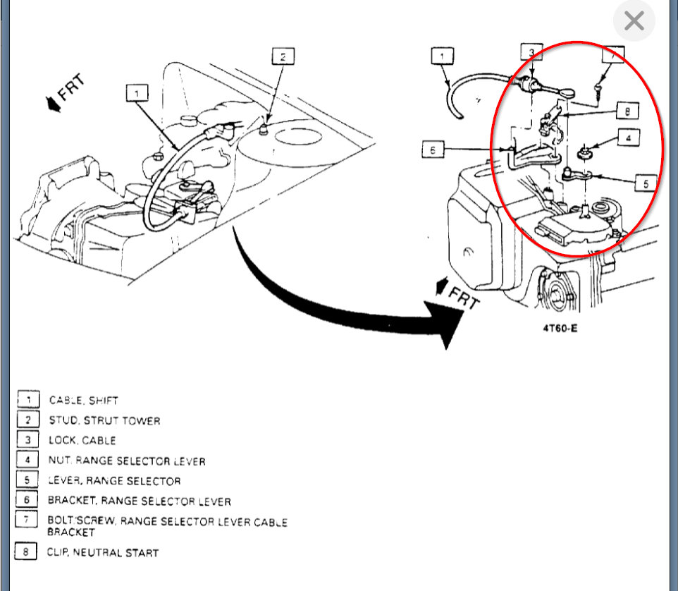

Need to know where the shift arm is located at. So I can move my car because I lost my keys.
Jun 22, 2021 at 8:54 AM

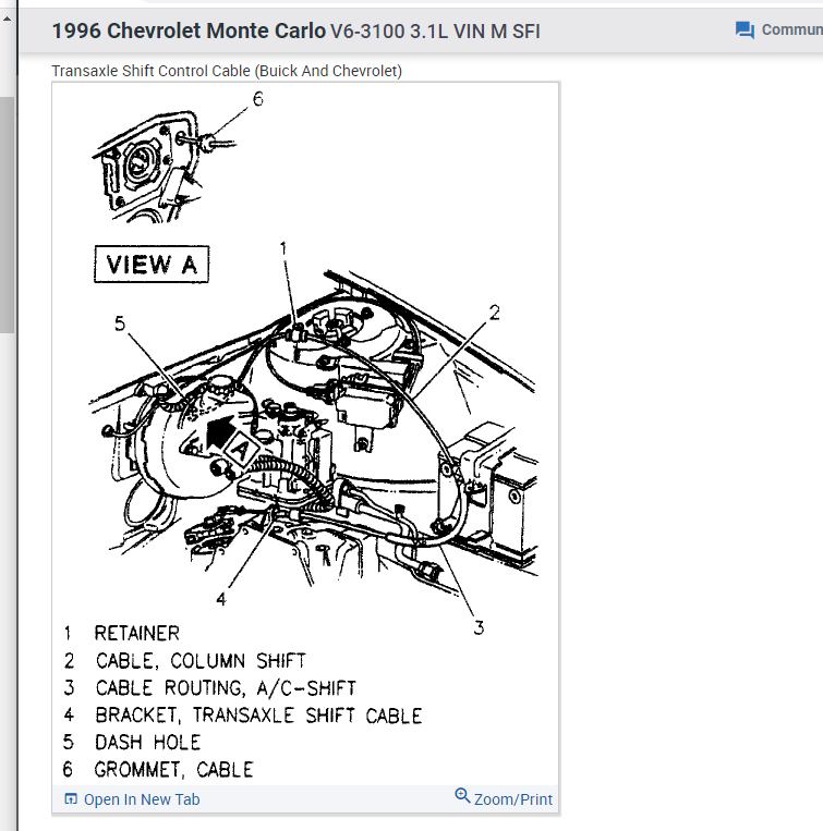

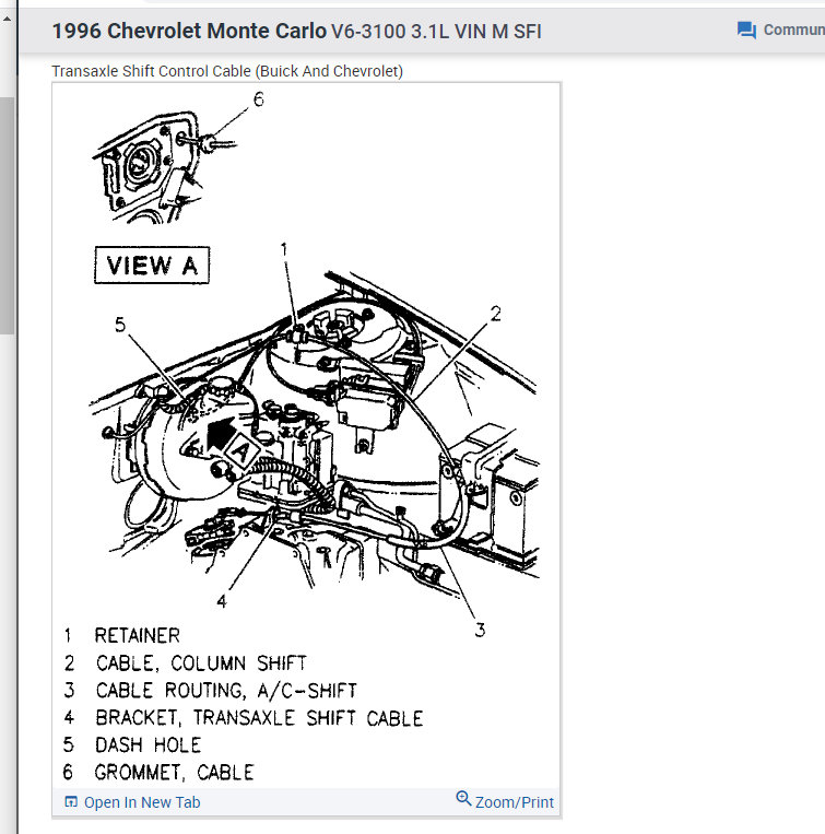

This is called the range selector and it is on top of the transmission. If you follow the shift cable to the transmission you will find where it connects to the selector switch.
You need to remove the cable and then you can manually shift it to neutral.
You can also just get some wheel dollies that you can put on each drive wheel and then roll it around as you see fit.
Below is all the info on this cable. Please let us know what questions you have with this. Thanks
