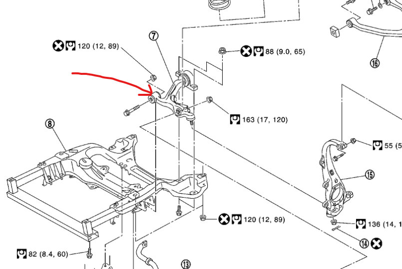

My steering wheel shakes when I’m accelerating, and I have uneven tire wear.
Jul 6, 2023 at 2:27 PM
  • 55,402 POSTS

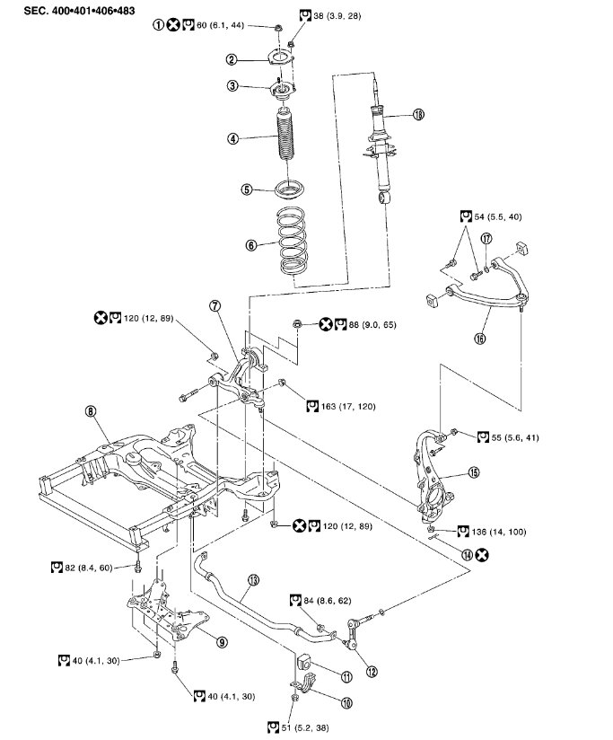

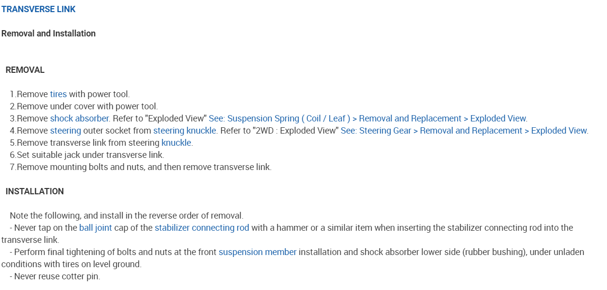

This is common when the lower ball joints wear out. I would replace the lower control arm because it will come with new bushings as well.
This guide may help as well:
https://www.2carpros.com/articles/steering-wheel-shakes-when-accelerating-or-braking
Here is how the job is done in the images below. Check out the images (below). Let us know what happens and please upload pictures or videos of the problem so we can see what's going on.

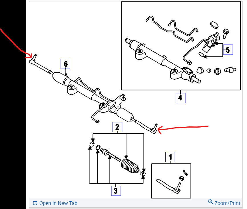

Thank you so much! I only have 1 question. I have heard that it could also be bad tie rods, are there any unique indicators that it’s one or the other?
Jul 7, 2023 at 10:59 AM
  • 55,402 POSTS
Yes, it could be the tie rods, these are easily checked. Raise the front of the car and have a helper move the wheel back and forth slightly while you watch with a flashlight and look for play, this guide can help:
