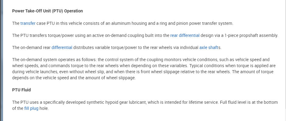

Car shakes when on highway after 65, only sometimes. Have had new tires, balancing, alignment, u joints, boots, bushings and steering column all checked and /or performed. Mechanic is baffled, dealership not sure either. Anyone have this issue and how to fix?

Lastly the other possible cause is the all wheel drive system. This vehicle uses what is called a PTU or power transfer unit.
I am attaching the info for this unit. So if we can disable the AWD system that will eliminate this as a possible cause. There are a number of ways to do that but let's get to that after these questions are answered. Thanks
