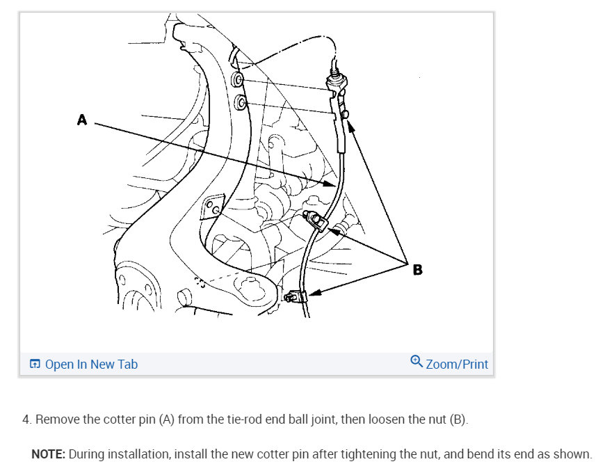

Does anyone know what can be causing the sh-awd light to turn on and off frequently? It started right after getting the power steering pump replaced.
Dec 23, 2018 at 12:26 AM
  • 55,112 POSTS

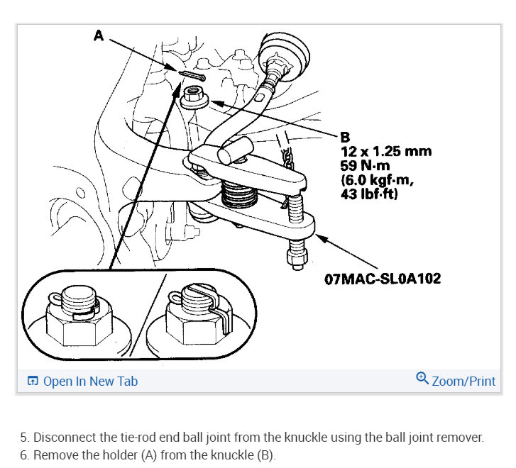

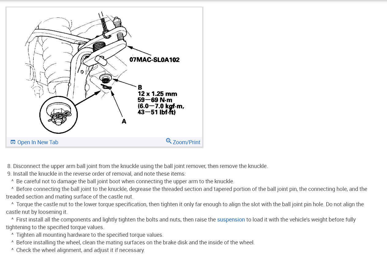

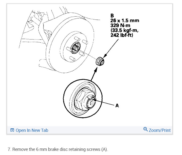

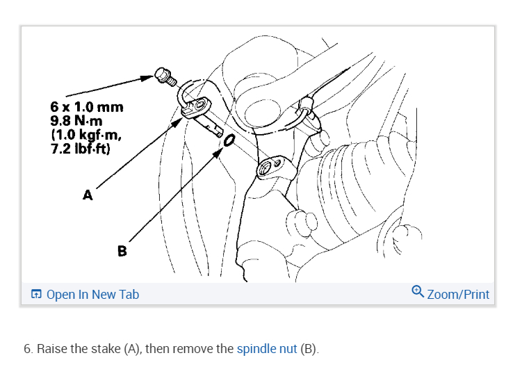

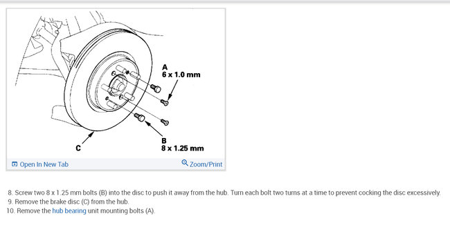

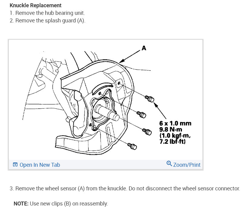

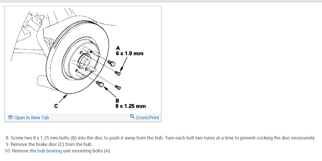

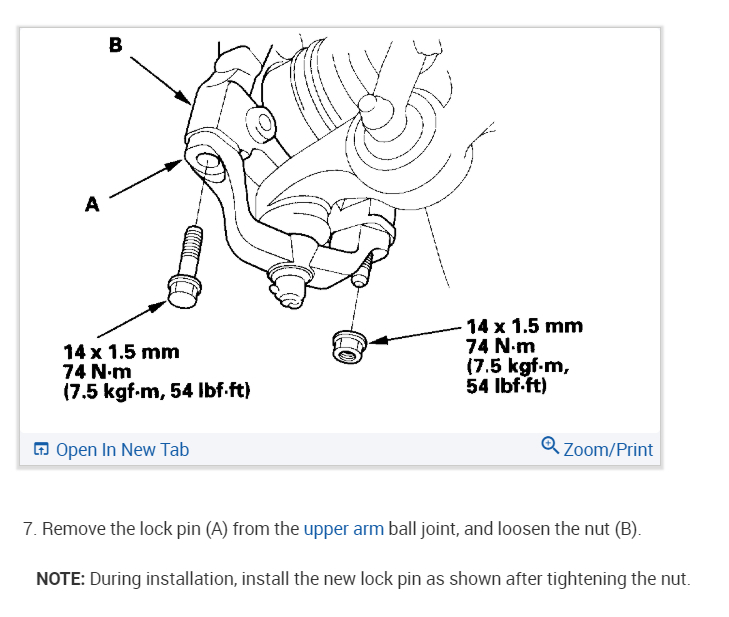

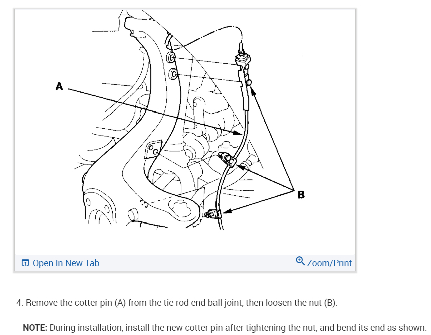

It sounds like the two are not related, but you never know. lets run the codes for the ABS. here is a video to show you how. I think you have a front bear hub going out which will make the ABS sensor work and then not causing the light to come on.
https://youtu.be/rTtAnsOlZU4

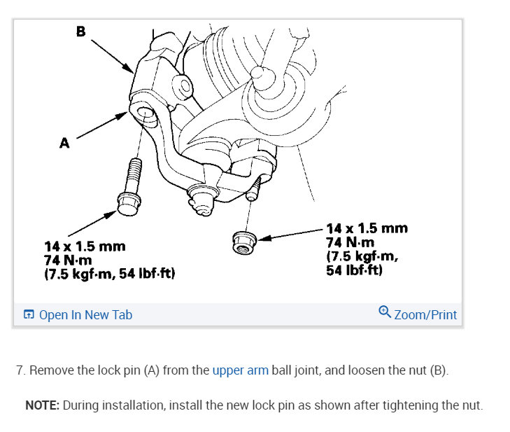

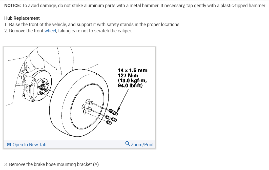

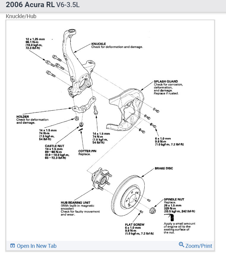

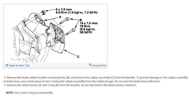

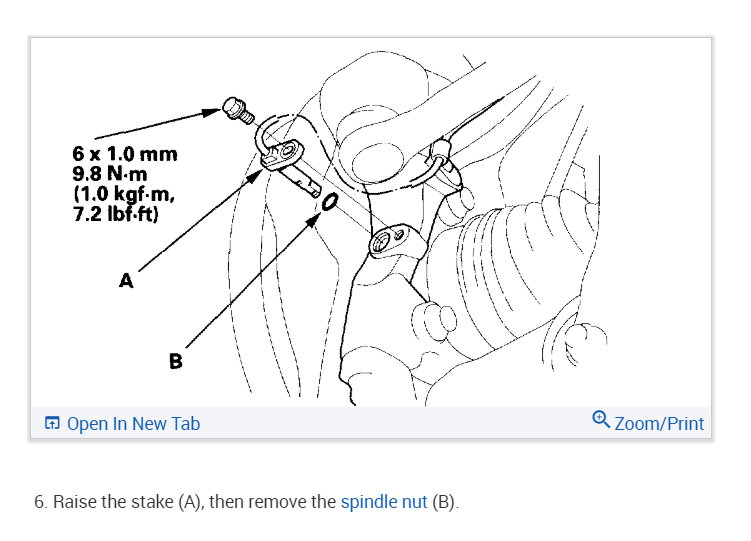

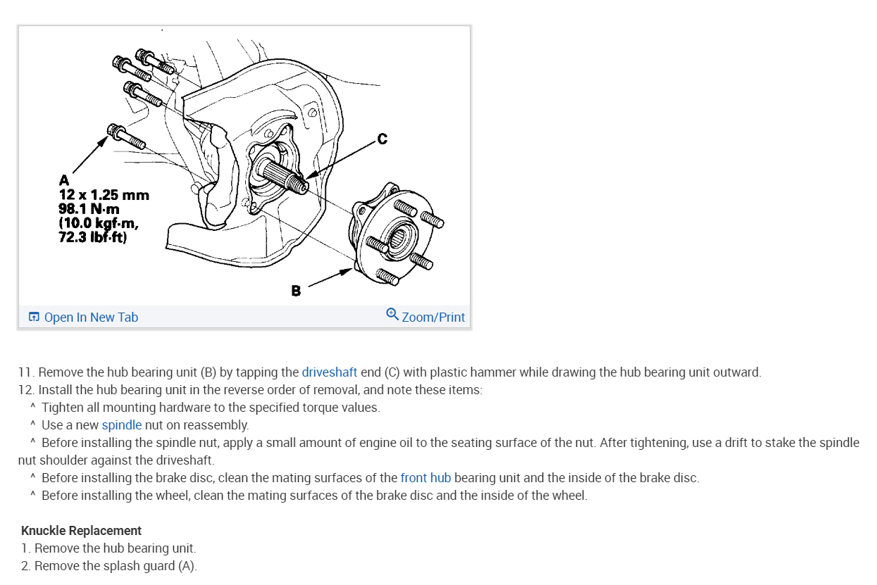

If so here is the step by step on how to change it out with diagrams below to show you on your car:
https://www.2carpros.com/articles/bearing-hub-replacement
