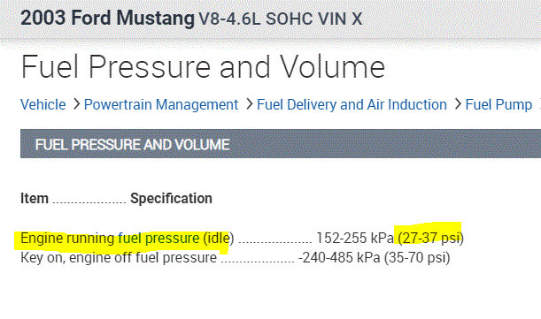

Codes P1507, P1130, P1233, P1353, and P1131
2003 FORD MUSTANG
212,000 MILES • V8 • 2WD • MANUAL
DIVIDES
  • 903 POSTS
From experience, do some of these codes together or are caused by some of the ones listed?
Only symptom is a bit of rough idle:
P1507
P1130
P1233
P1353
P1131

First, I attached a general meaning for the codes you provided. Note: Code 1353 is not a listed code for this specific vehicle.
1507 idle speed low
1130 O2 sensor Lean mixture
1233 fuel pressure monitoring system (fuel system offline) it shouldn't run with this code.
1353 not specified for this year, make, and model. Misfire cylinder 6 / fuel cut off.
1131 O2 sensor, lean mixture.
Based on what these indicate, the first thing I would be checking is for an engine vacuum leak which can cause all of the codes. Here is a link that explains how it's done:
If none are found, confirm the fuel pressure is within the manufacturer's specifications. Here is a link that explains how to test fuel pressure:
Pic 1 shows the manufacturer's fuel pressure specifications.

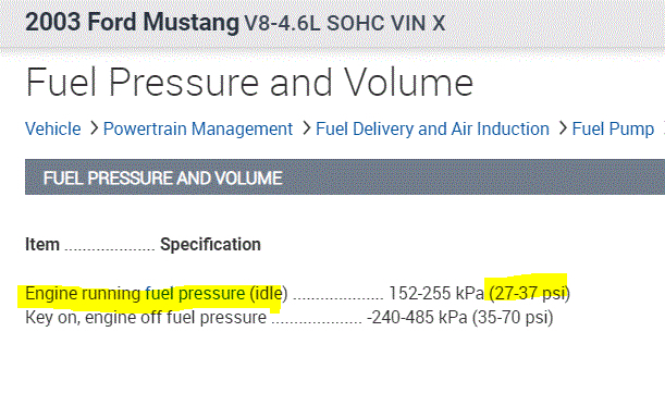

See pic below.
